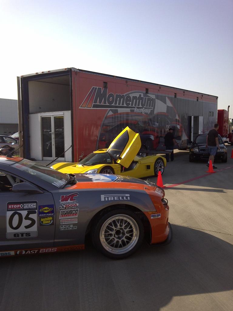

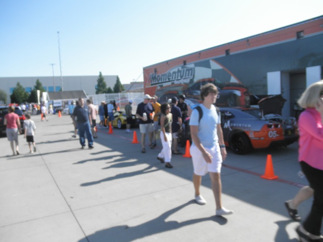

At Cars and Coffee, the Momentum Race group has adopted me. I thinkit's cuz of the LS3 similar to their SCCA car. They say I'm a good draw, so i don't have to get up at 0 dark:30 to get a spot, they just lift up the cones. Another nice feature of the SLC, you can sleep in!

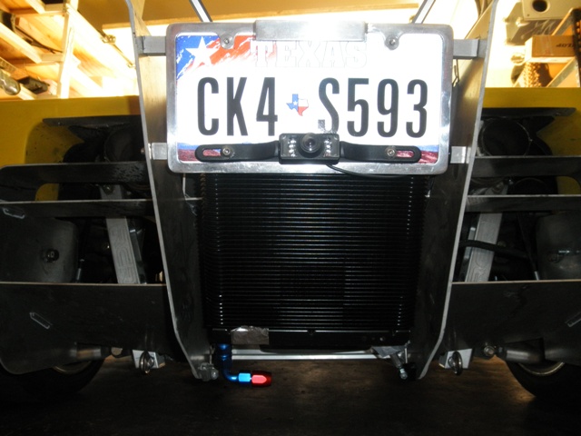

I noticed on track days the transaxle was getting hot. The oil was boiling out of the vents. On the Ford GT columns this is pretty common with tracked car. I'm in the process of routing the AN-8 line to a B&M cooler hangin off the diffuser.

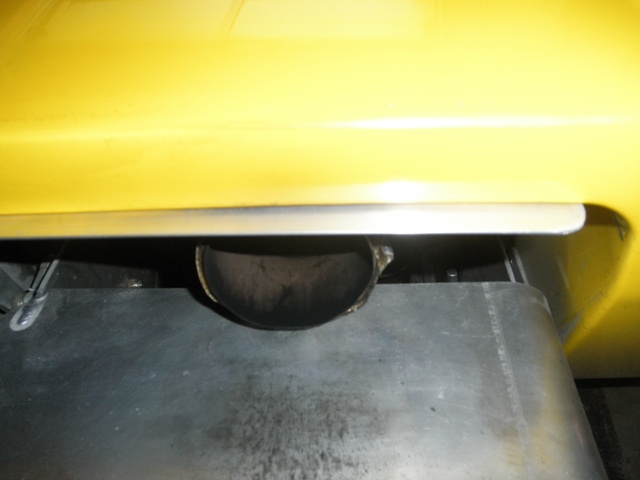

On the old tail i cut the exhaust short so i can open the rear clip. Problem is the exhaust gas was melting the F/G. The 1/8" Al flat stock seems to have stopped that and still allows the clip to pivot.
