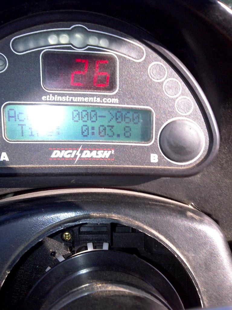

Wow, I havent posted in 1/2 a year. I saw a thread about 0-60
I was messing around with the SLC several months back. 1st gear is listed at 56mph, i thought i might be able to make 0-60 in 1 gear. I had my old Nittos, not very warm, set the digidash 0-60 and did a mild 3600 clutch dump. At 58 i hit fuel pump cut out. Drat. Sure enough, that spreadsheet for calculating speed from tire diameter, gear ratio, etc, was right. Dumped it into 2nd and still pulled a 3.8 sec. The Digidash cant lie, compared to my neighbor using a stopwatch.
I remember seeing 3.3 sec as a projected 0-60 time and I bet that would be easy with warm tires and a pro driving.
With a 3.3 rear end ratio and 25" of tire in the back, this is not exactly easy on the drivetrain. I've stopped doing any 0-60 or quarter mile runs, my build is not set for that. I'm set for long pulls on the track. I'd think a Porche transaxle with a low final drive ratio might be best. I hear the Ricardo only has a 3.90 option and its real hard to find?

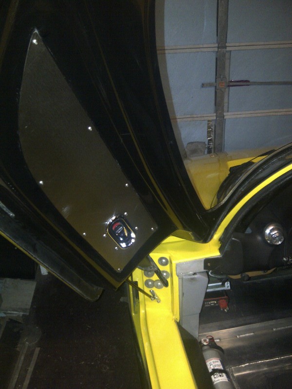

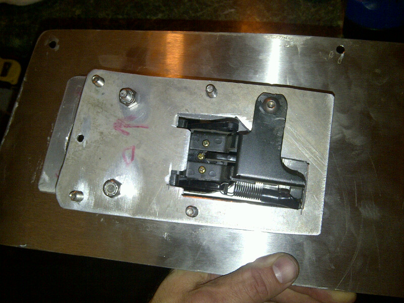

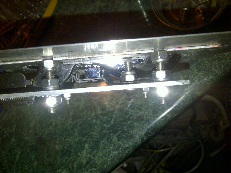

Hadnt had a chance to post but the building continues. I went back and copied the retro door handle inserts that were used in the mule. They werent mass produced so time to get out the grinder. the brushed SS was thin enough to contour to the arc in the doors. I put a 1/8 Al reinformcement panel on the SS then another subplate of 1/8" Al. the miata door have anew home. light weight.
Now where are you gonna put all the groceries???:D

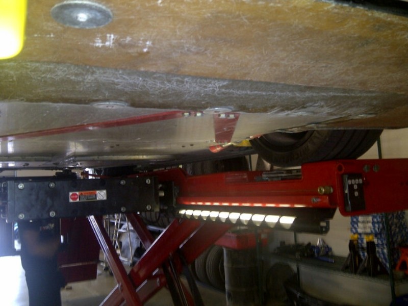

Also I had the SLC up on the Hunter rack so i snapped a front undercarriage photo. i dont have the lift kit and have a few scrapes but no real damage. 7K+ miles over 2.5 years.[/ATTACH]
