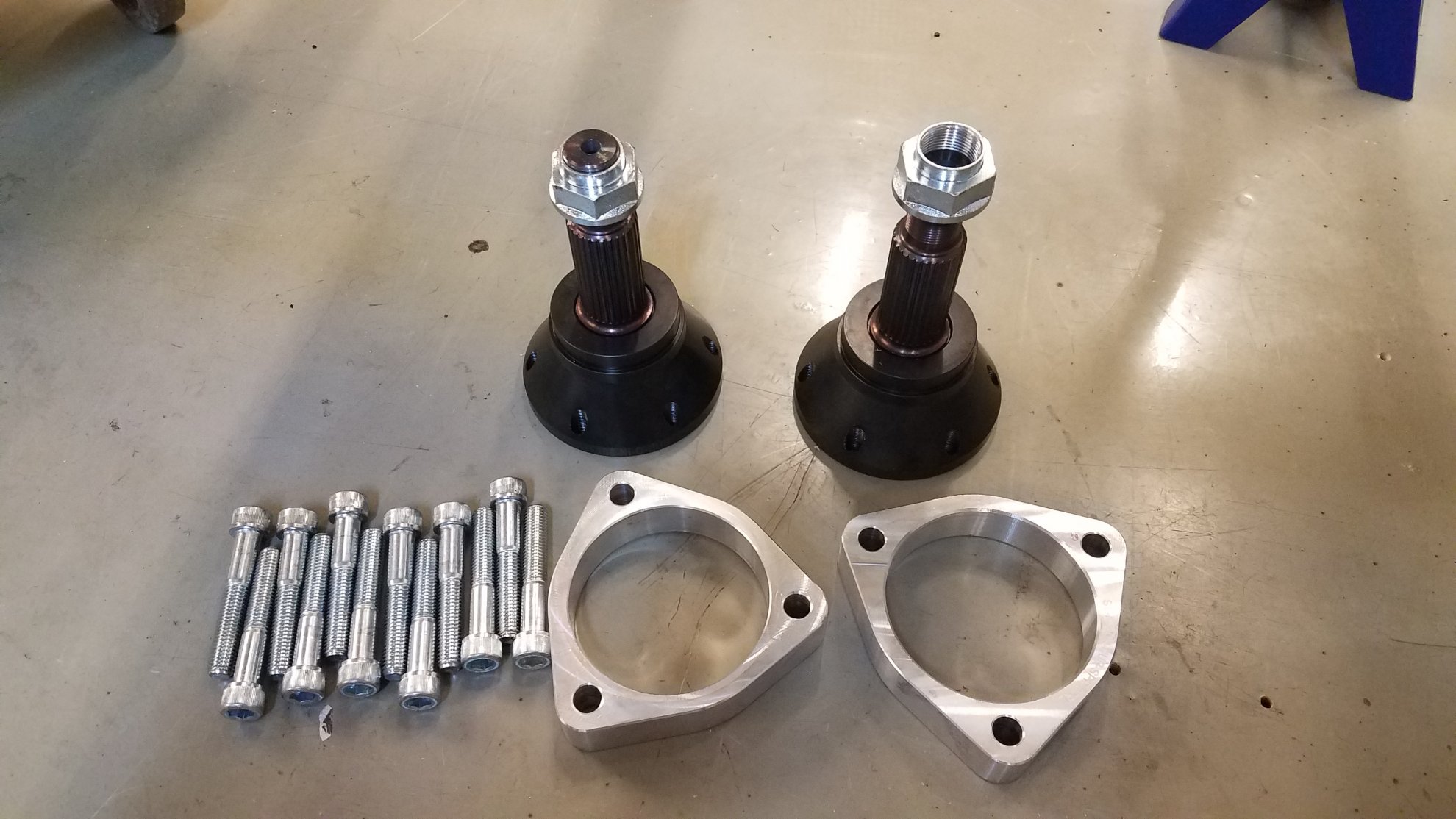

I also got a set of stub shafts from him so all you really need is the bearings.

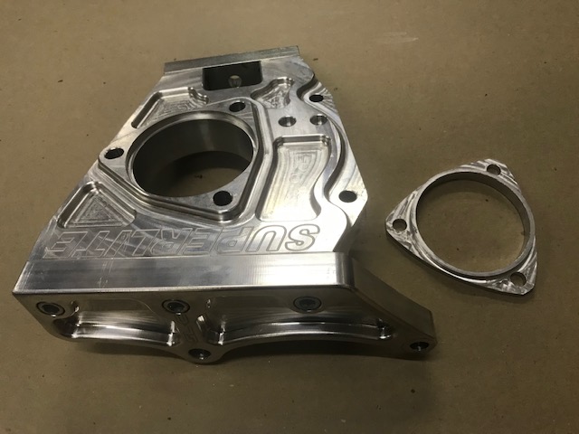

It's great to see these become available, very nice. Where do the spacers in the last picture go?
Mesa, yes, I'm very glad since I have been following this thread and was about to embark on the upgrade.
Not sure where those spacers go yet. I've ordered the hubs and will post progress pictures when the hubs arrive.

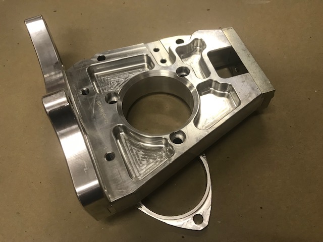

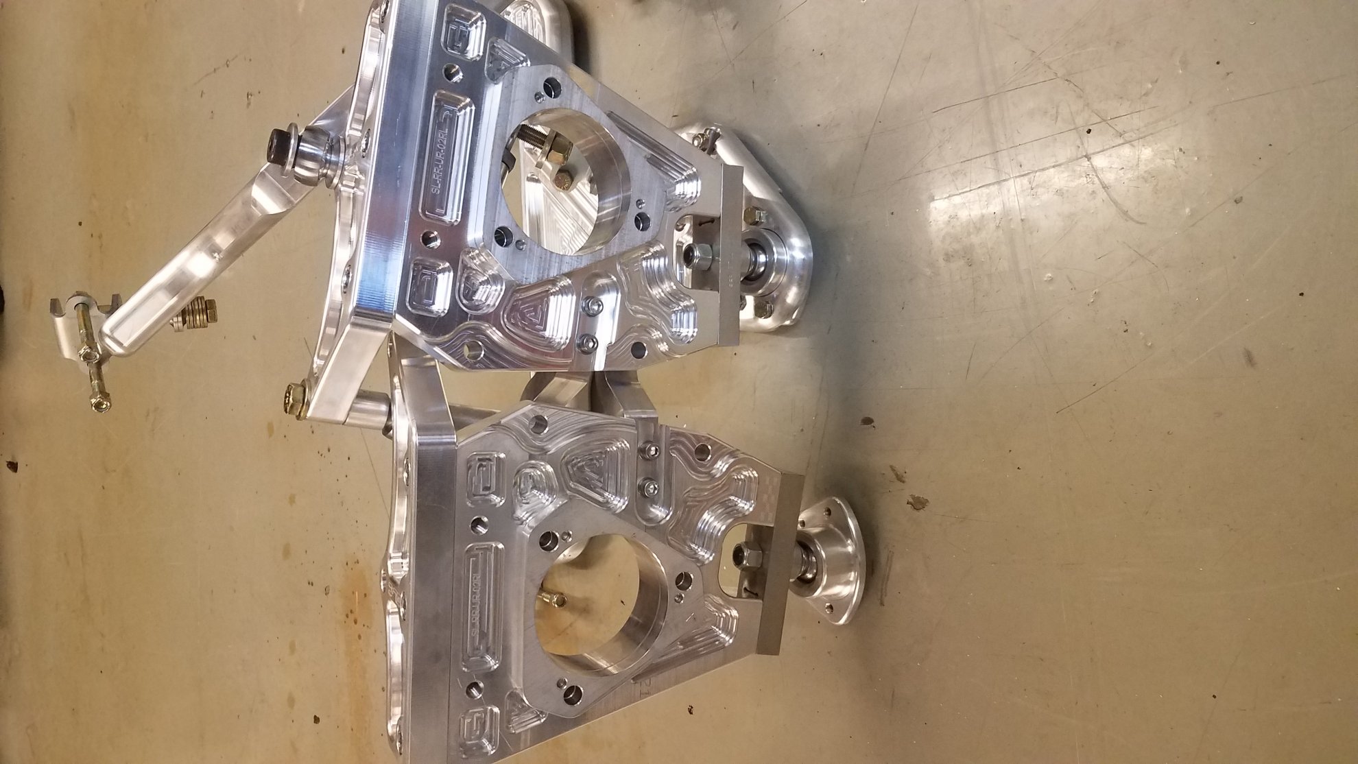

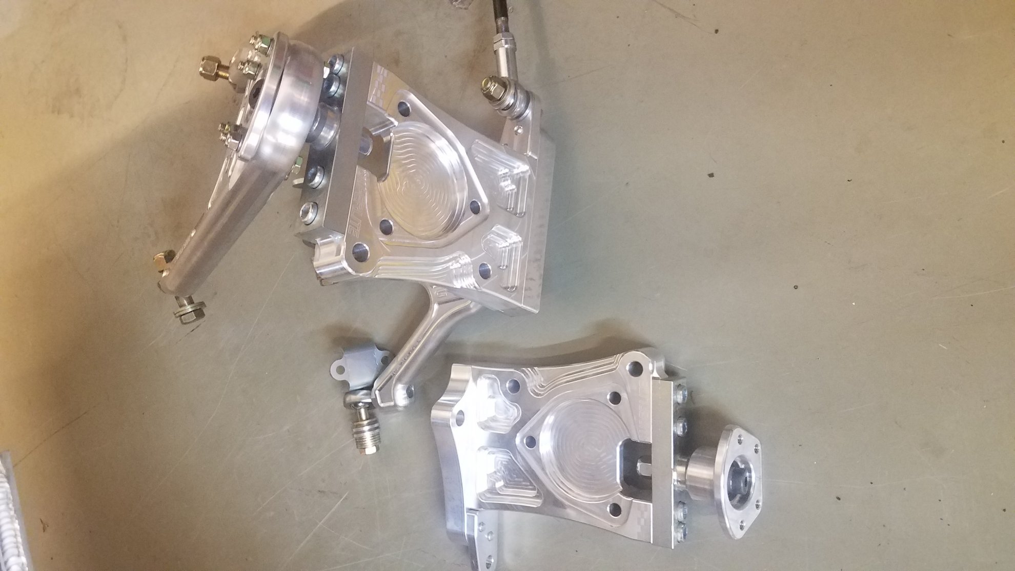

Spacers look like they get placed on the outside of each front upright. Since the front upright can be used for either side a removable spacer is need. If you look at the picture (post #267) you can see they are machined the same on each side of an upright.
The rear uprights also look to have removable spacers. The picture in post #263 shows them in place.
Instead of stocking four different uprights they only need two now.
Scott
I exchanged brief texts with Fran today. There are new front and rear uprights. The center section of the upright and spacer will be available as an upgrade. The new rears will accommodate C5 and C6 bearings. The rear requires a new stub axle as the bearing has a thicker shaft with higher spline count. Fran hasn’t finalized pricing yet, but the numbers he shared with me seem inline with other approaches given that it’s a complete solution. I suggested that he also drill and tap holes for the parking brake bracket. So, if you’re thinking about doing your own upgrade I’d wait... I already placed my order.

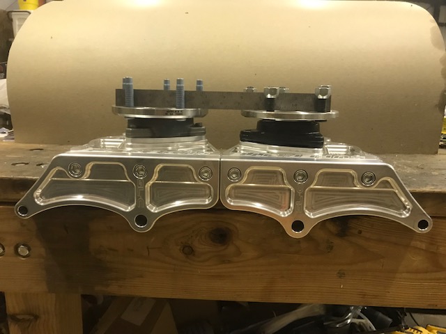

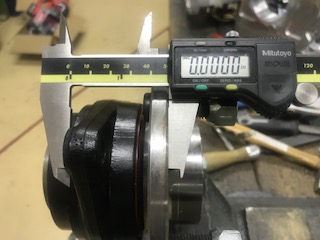

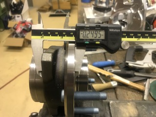

In switching over to the C7 X Tracker hubs I followed Ken and Howard's footsteps. I machined the rear uprights to accept a machined Bushing/spacer. In measuring the C4 hub vs the C7 X Tracker, I required a .250" spacer. Ken had measured his C and C7 bearings requiring a .190” spacer. The difference may be that the C4 bearing when I measured was not compressed with a stub shaft bolted in. The C4 bearing might require the stub shaft to be bolted to tighten the bearings. Without the stub shaft being bolted in place the bearing is sloppy. Not so with the C7 hub. I can thin up my spacer if needed when I drill and tap the mounting holes for the brake calipers. The pics show that I measured the flange to flange distance on the C4 bearing then zero'ed my caliper. Then I measured the C7 bearing and you see the -.250" result.

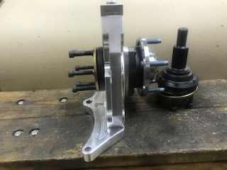

The next pic shows the mounted C4 bearing next to the mounted C7 bearing with a straight edge across both of them.
Roger Reid
In post 183 and 188 of this thread Ken shows having a “steel bushing” pressed into the upright to maintain “hub centric”. As Ken says this is because the C7 X Tracker hub is 3.593” where the hub slip fits into the upright. The upright diameter on the C4 hub is 3.620”. A .027” difference. So a bushing is needed to center the c7 hub. I machined a spacer/bushing combination into one part. I machined the upright with a slip fit clearance for the bushing portion of my spacer. The spacer also has the new C7 X Tracker bolt circle at 4.567” as Ken states in post 210.
Roger Reid
The holes in the upright were machined to the new bolt circle of 4.567” (see post 210). Then the holes on the inside of the upright were counter bored .560” deep x .720” diameter for clearance. I also had a 4.065” x 45 degree chamfer on the inside for clearance to accept the new stub shafts from The Drive Shaft Shop. The Drive Shaft shop part is found here. https://www.driveshaftshop.com/domestic-axles/chevrolet/corvette/c5-and-up-to-2008-c6-2004-2008-ctsv-wheel-flanges-to-fit-a-108mm-porsche-930-cv-2201
