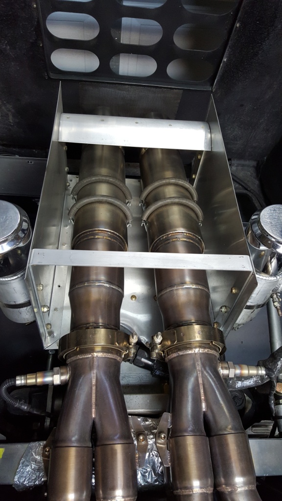

I think you'll like that stainless exhaust. The pipes seem to cool down quickly after shutdown and they'll brown up nicely in no time. I also used a thinner wall stainless for my water pipes vs the supplied aluminum.

Mike, I noticed that your exhaust cradle appears to have a flat surface. Just a heads up...after time the pipe and bracket could start pounding each other or floating around more than you'd like. I used the curved Go-Kart exhaust cradles on mine. I believe they can handle up to 4" pipes and they come with a stiff rubber mounting washer for additional damping. You could also line the cradle with a piece of exhaust wrap for a pad.
I see Pegasus Auto Racing sells the Kart air intake/exhaust cradles: Kart Air Box Mount Cradle only, with springs - Pegasus Auto Racing Supplies

Tom, yours look very nice. In my old setup I went through a couple different design iterations. The first setup was rigid and ended up cracking in no time. We went back and redesigned them only this time with cradles and springs. I did not have any problems after that. I will say that even with cradles, the megaphones really only made contact in one or two points in the cradle. Nothing is perfectly round. The lesson I took was give the system room to move. The flat bracket is 6061 1/8" aluminum so it is stout but also should have some give to it. The springs gather the pipes in a single location so I don't expect them to move much. Hopefully just enough to prevent stress cracking. We shall see how it holds up and address if flaws are found. I do like the rubber biscuits in those units you use. Anything that provides some give I think makes it more durable.

Mike, agree....rigid is not the way to go. Too much expansion/contraction, twist, vibration, resonance, and so on, so it has to float around a bit. A doubled up piece of exhaust wrap underneath where the pipe meets the cradle can be used should you need to go that route later. I have over 3000 miles on mine and nothing has moved or shown any stress....stainless is stout!
Mufflers? Well, they just look like mufflers... The beauty of the V-band clamp is that we can quickly swap pipes/mufflers/megaphones in just a few minutes. That was my intent, and that you can index the pipes by rotating them so they're spaced the way you want them.
