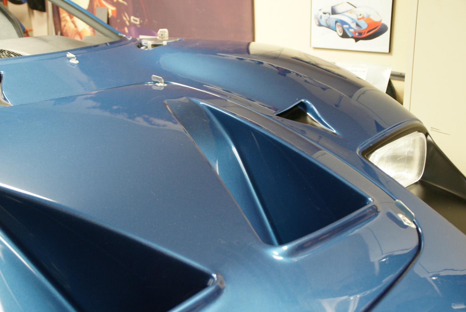

Ryan, that is an Olthoff mod. The stock nostril blocks off part of the fans. He cuts that out and then bolts on a new fabrication that turns down at the bottom so the entire fan and radiator is exposed.

On the nostrils, I did the same thing. http://www.gt40s.com/forum/gt40-build-logs/42186-tornado-gt40-texas-9.html?highlight=tornado+gt40+in+texas #163.
After I did that, I found out that evidently the CAV comes with the deep double nostrils. I think it is a mandatory modification.
The attached photo shows my finished nostrils.
-Bob Woods

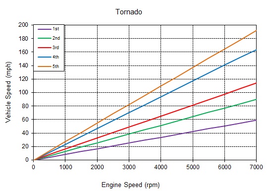

Wow, that sound great! I would agree that is either 180 or 200. I would guess mine would run out of gears closer to 180 than 200 but don't remember what it came out to be.
Mike,
I will run out of gears too. According to theory and my estimated horsepower, I should be able to hit 216 mph; however, at 7,000 rpm I will be at 190 mph... like I will ever drive that fast! But, more importantly, at 60 mph I will be turning 2100 rpm.
