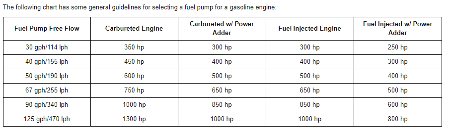

Here are the calculations (I'm planning for 330-350hp):-
For example, if you have an engine that makes 350 horsepower, your equation will look like this:
(350HP x .5 lbs) / 6 lbs =
175 lbs/hr of fuel / 6 lbs = 29 GPH
In our example, you’d need a fuel pump that delivers 29 GPH of fuel.
and from Summit racing:-
And these are fuel requirements for running WOT...on the narrow, bumpy, gravel-strewn lanes of north Lancashire I'll be luck to hold full throttle for more than 5 seconds!

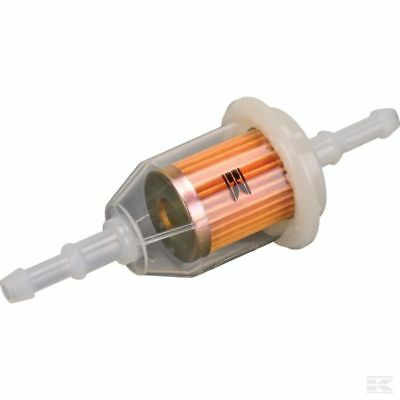

I did read about some failures caused by lean conditions, but it seemed that on investigation other factors were responsible, eg. running one of these as a pre-filter:-
which had then clogged and collapsed, causing the pump to fail. And for every tale of woe, there seems to be another tale of someone using a pair of Facets for 20 years without an issue.

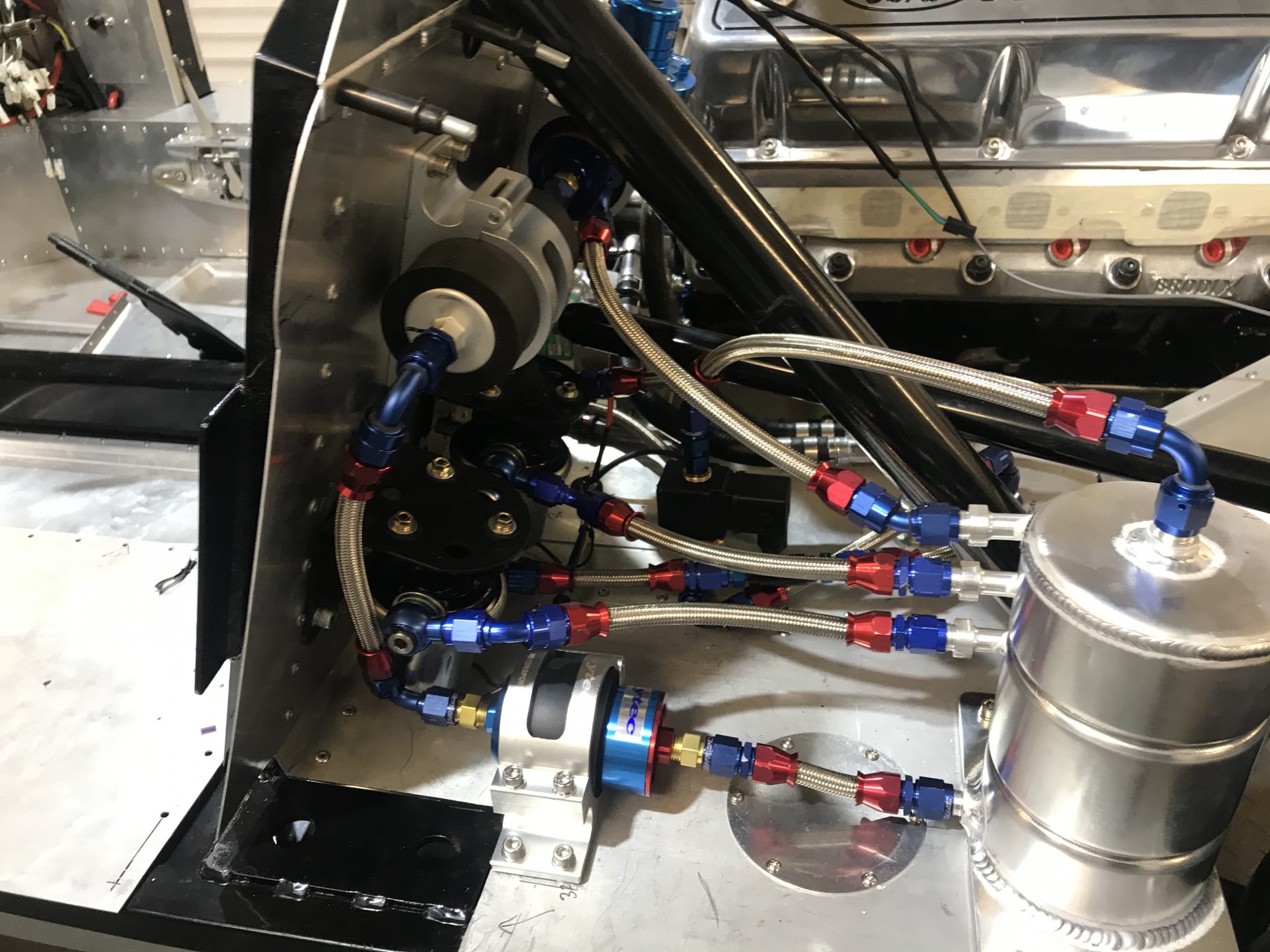

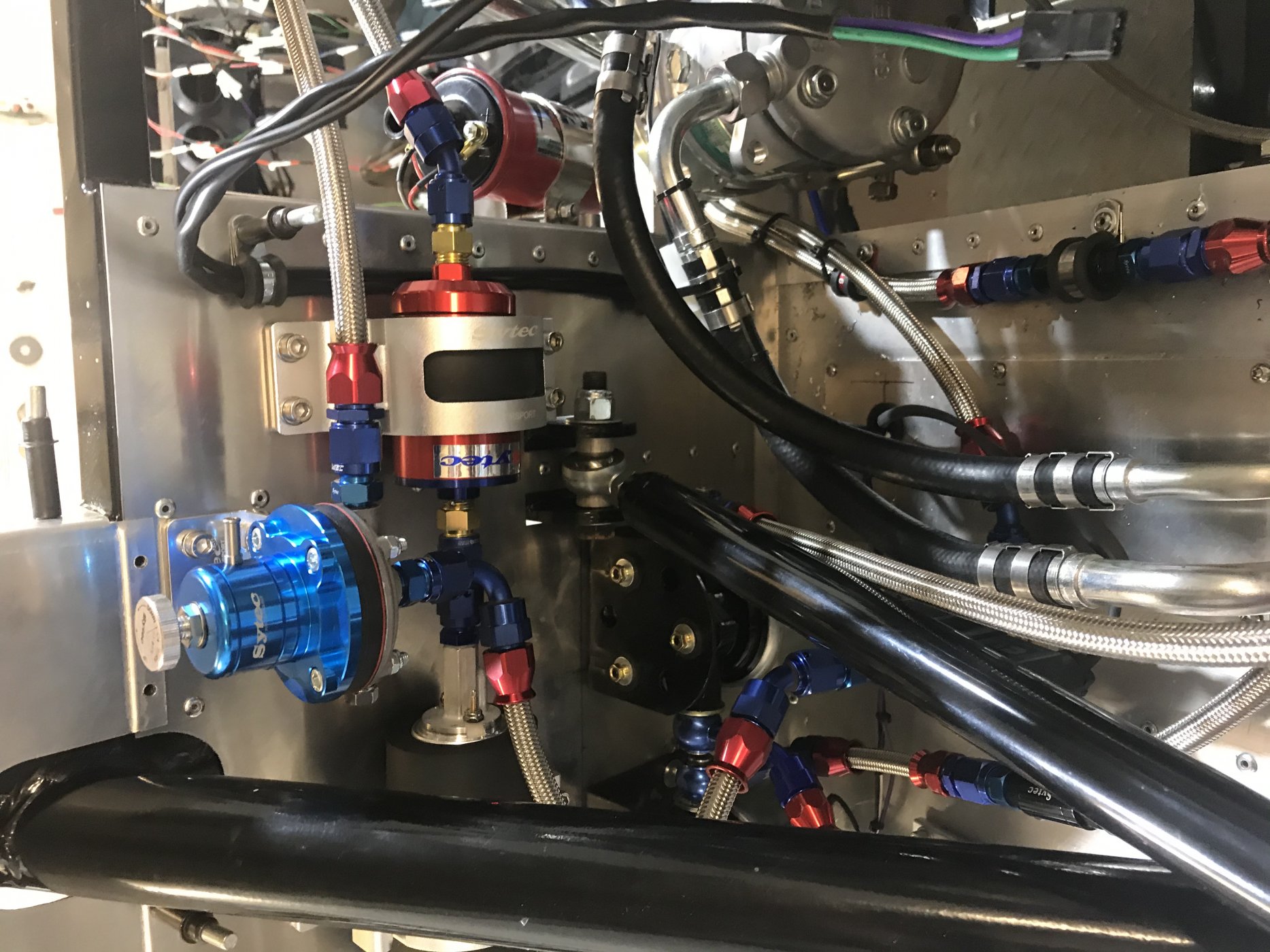

I used a pair of these in mine they feed a swirl pot then HP to the fuel rail, I spent ages looking at fuel pumps, these lift which is good as they are sited (as they seem to be in most GT40's) above the tank
My plumbing got a bit busy!!!

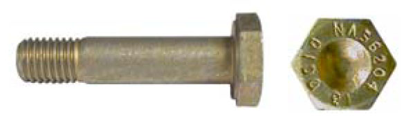

Eddy;
There is a way to avoid the loose bolt clearance problem. If you use a close-tolerance bolt in a hole reamed to size it will give far better results. Never use a fully-threaded fastener in this application; you do not want a load bearing on the threads. Here is an example of a suitable bolt (attached photo). It is a 1/4-28 close-tolerance bolt with a shank size of 0.249" +/- 0.0005". You specify a "grip length" that allows the non-threaded shank to fit through the diameter of the joint and perhaps one washer thickness. In a hole reamed to 0.2500", your loose fastener problem is solved.
