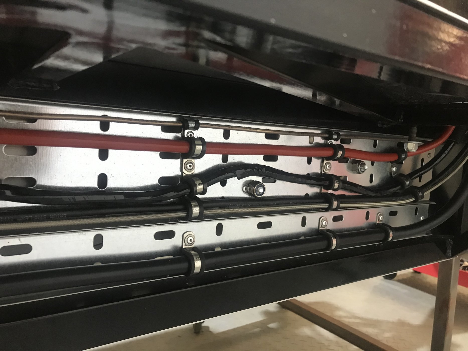

Hi
I used a power trunking for mine sort of worked, image of the drivers side as below, so I had brake, then battery, then loom, bleed pipe from front rad, fire extinguisher pipe and finally the a tube for the throttle cable (Mick suggested as if it snaps you can pull a new one through).
AC as you say on the passenger side plus clutch pipe.
Then I added the vent pie (not in this photo) for the fuel tank as they vent both ends
So it got really tight and I think I need more!!!
Shaun
Just had a thought, have you got your fuel tanks yet as that angle aluminium my not allow them to fit, from member the gap between the chassis and the tank is very tight, in my lower hose in the image above, it was only just missing the tank

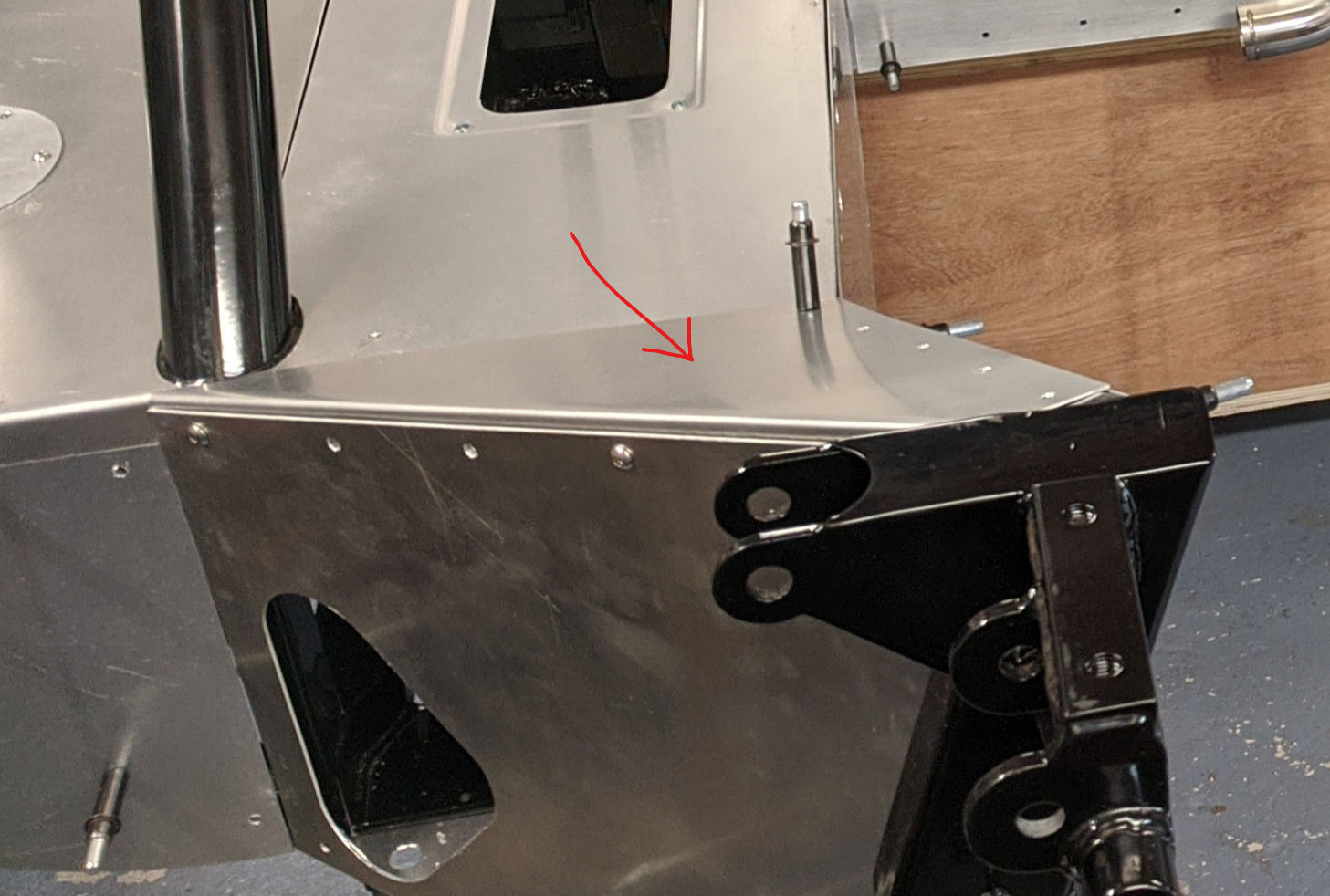

A bit more panelling yesterday...
I know some of you SGT builders have made a few of rear panels removable, either with self-tapping screws or Rivnuts & setscrews. Which did you choose? I currently have this one removable:-
which gives me good access to the left-rear brake line, back of fuel tank etc.
