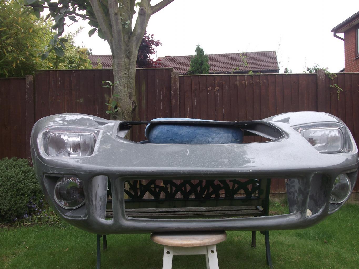

Front lights done.

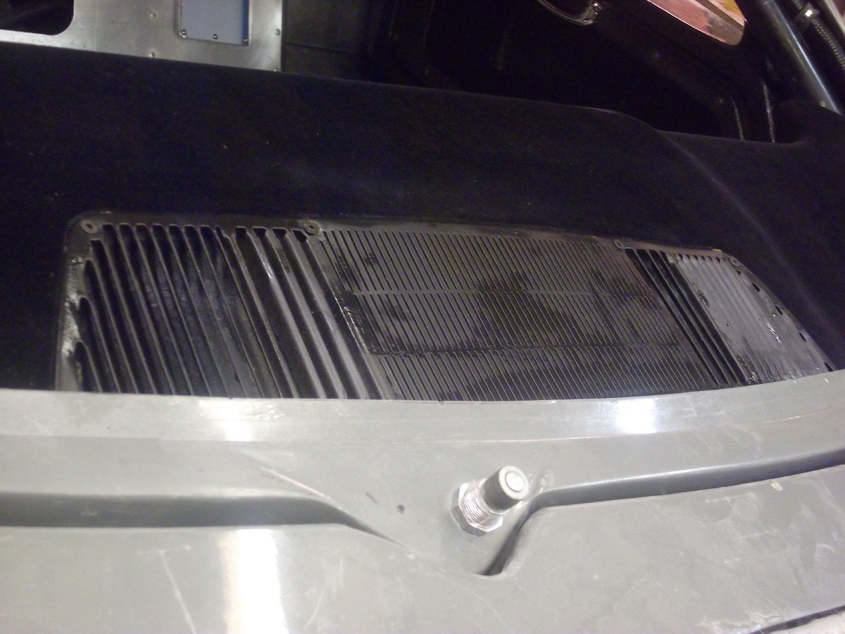

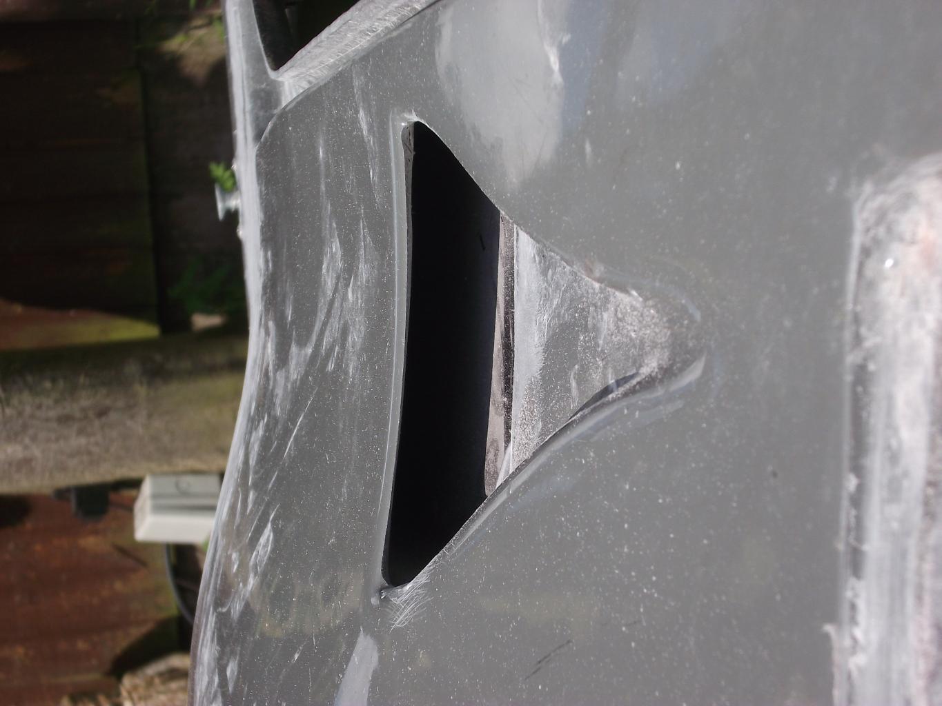

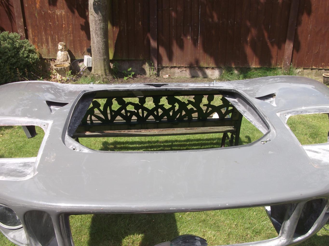

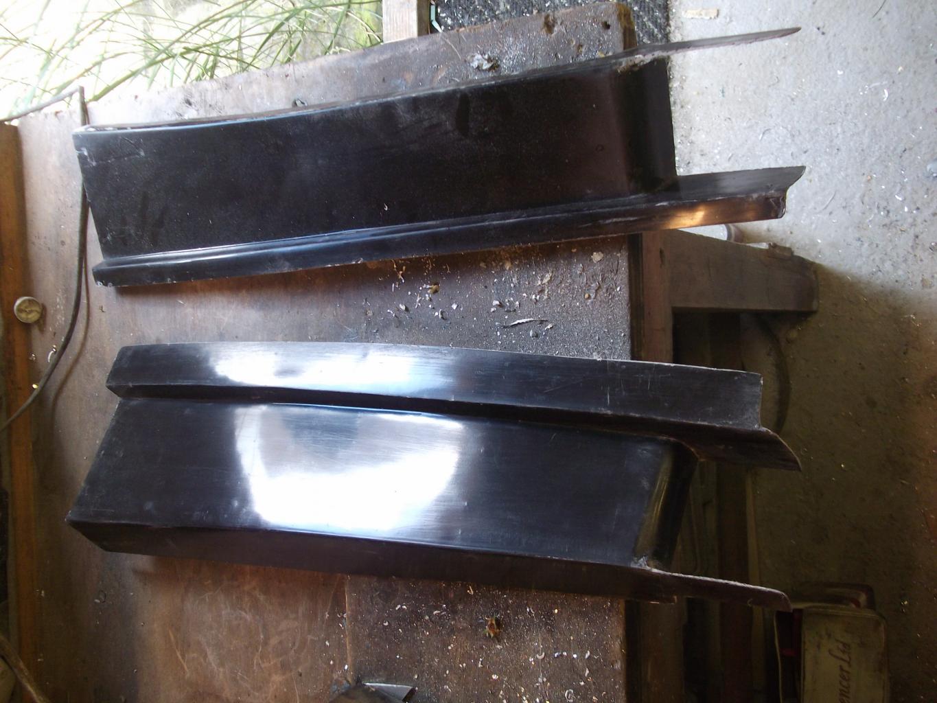

Front clips ducts opened up and Southern GT supplied ducting attached.

Hi Nick, these vents you have opened up, where does the inlet air go to under the front deck ?
Hi Keith,
The red arrow on the attached photo shows where the air comes out at the end of the SGT ducting, the front of the ducting is (the vent) is shown by the blue arrow.
I then intend ducting air into the dashboard vents when Mick found time to send me some photos on how to achieve this.
I believe Glen Mason has this setup on his car.

I see, If the vents are open all the time would you not get a constant air flow in the cockpit of cold air, summer or winter or can you shut off the cockpit area.
Also I think I have a picture of the vents in Glens car.
When I get home I will have a look..
The dashboard vents can close if this is not enough when I hopefully hit 70mph down the Mulsanne straight one day, I can put and extra "trap" in line somewhere.

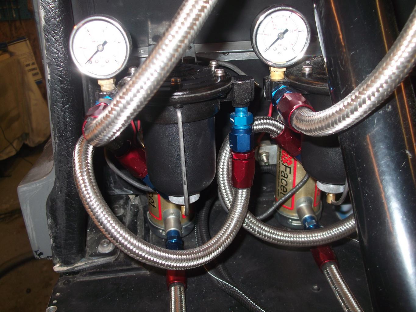

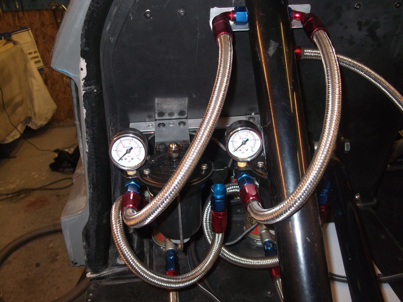

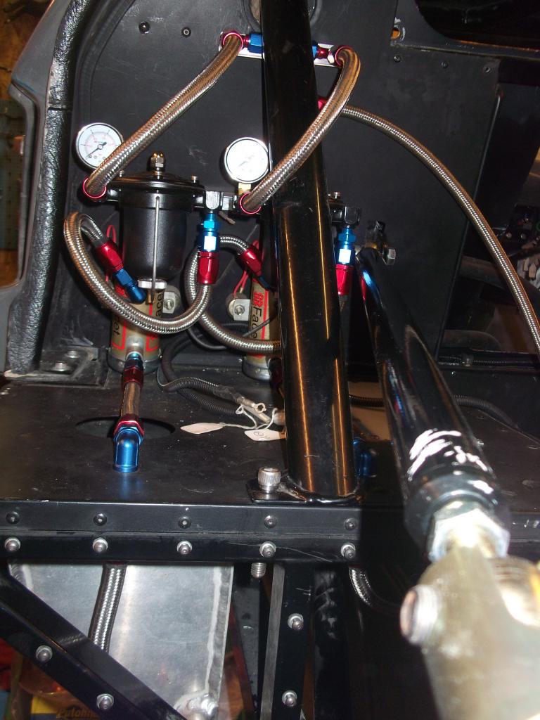

Fuel pump plumbing
Replica GT40 with replica aeroquip connectors :)
Hi Nick, Long time no hear !
Is that your fuel system ?
That picture shows fuel pressure gauges, which is fine for ensuring suitable system pressure but I was told that the gauges can leak and if they do they spray fuel at full pressure which is not good.
So when pressures are checked, remove said gauges and plug off.
I will do that before it hits the road, just in case.
Also those are Facet pumps I believe, not a big flow rate if using a big H.P. engine.
Wouldn't want to fuel starve the engine at high speed / revs.
How's the 40 going ?

Hi Keith,
Thanks for the advice, I was told they should be ok as I am running carbs and they are the red top ones, time will tell, perhaps they heard how slow I drive.

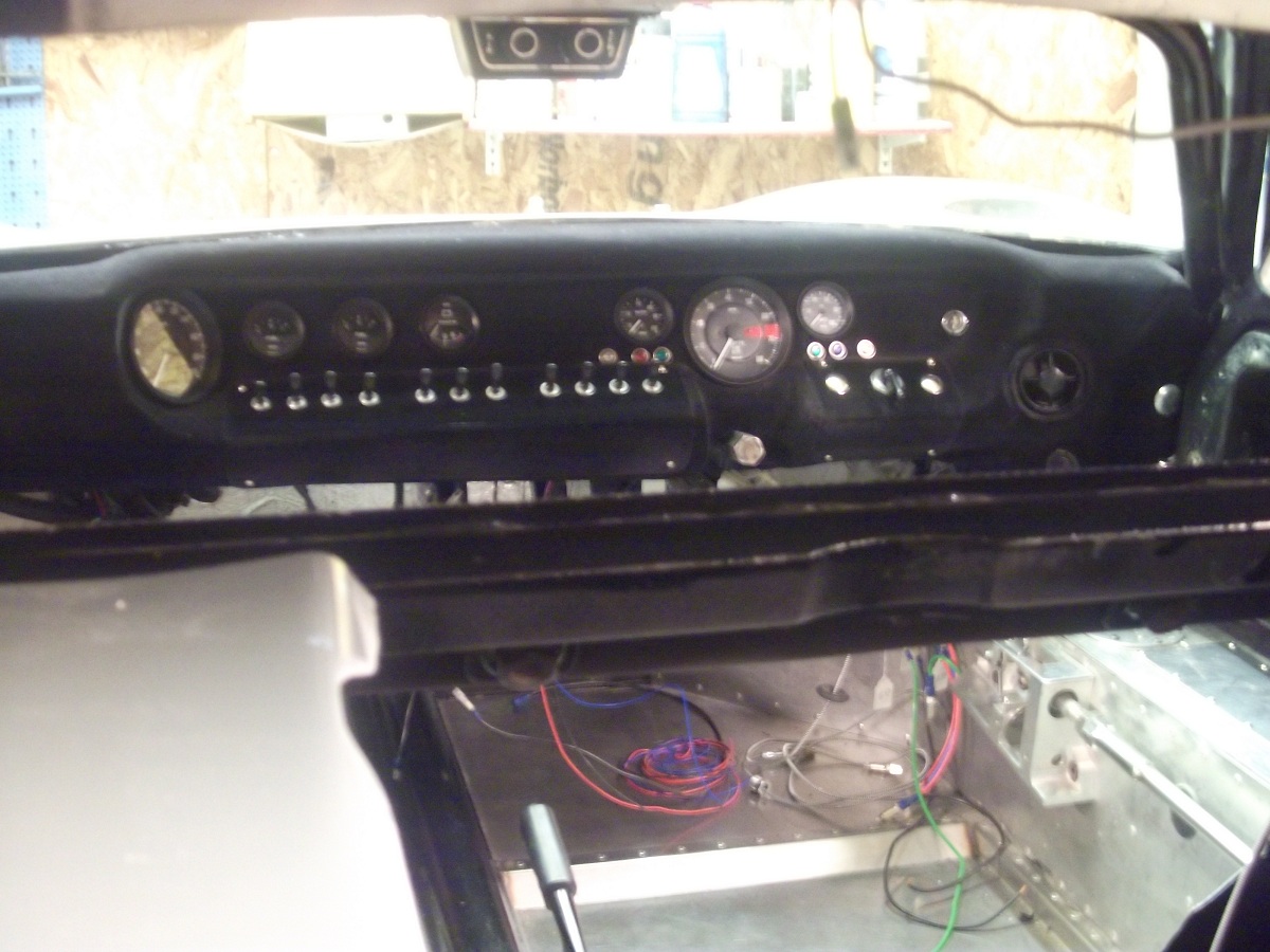

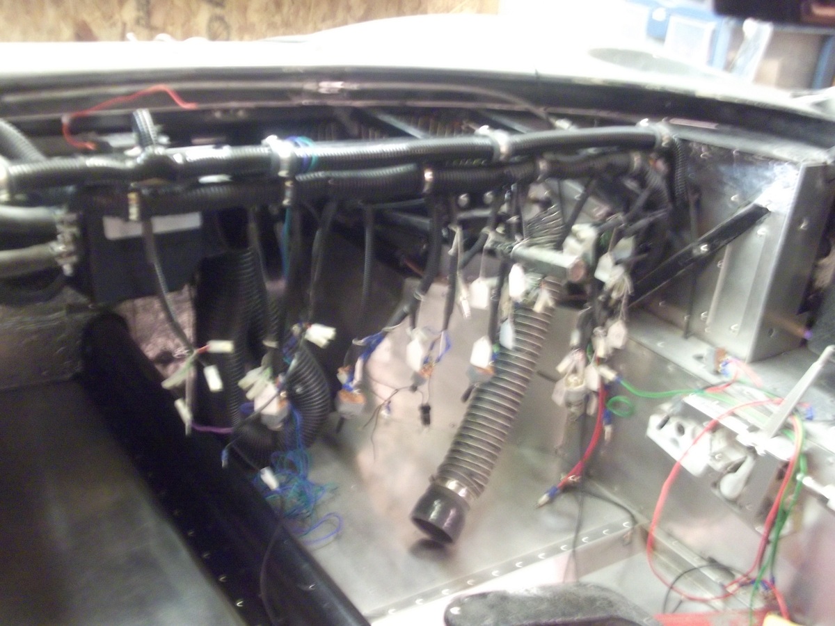

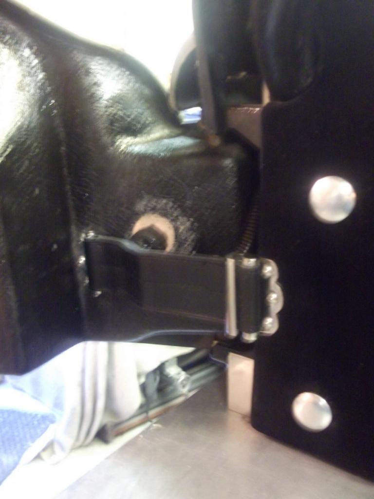

Wiring loom dashboard and door check straps added.
