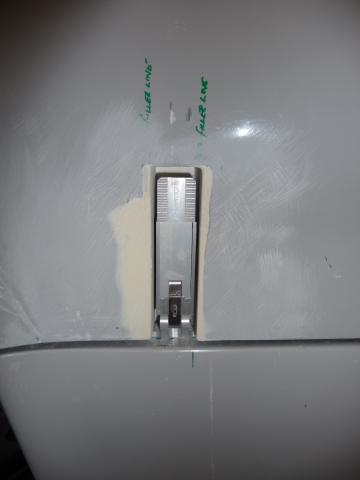

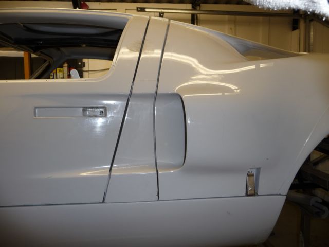

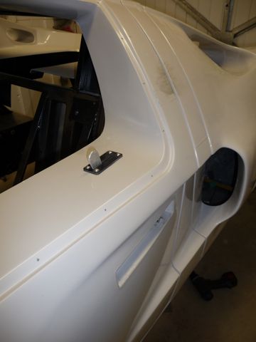

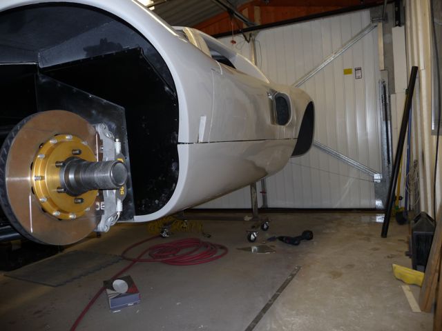

Started fitting a sill today 6hrs later I recon I have another 4 or 5hrs to go. Who ever said building a GT40 replica was easy. Also fitted inner door handles the other day.

After some thought I decided to fit Hartwell latches purchased from Mark Sibley. They are a fantastic product but quite some work to fit into the bodywork, well worth the effort though. I have fitted the lights all round and finished off the door handles. Just two more hartwell latches to do on the nearside and fit the sills then all the bodywork will be complete. I will then remove the bodywork and start all the mechanical build. I have nearly all the bits I need to complete the car thanks to Mick Sollis who has been finding and making bits as I have asked for them. Will post some pictures soon of the progress. I need to keep up with Nick Brough who is rapidly overtaking me in the build. Game on Nick!

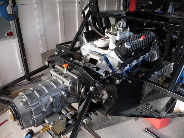

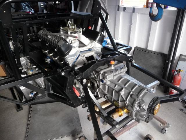

Big step forward today as I and Mike Pass managed to get the engine and gearbox fitted into the chassis.

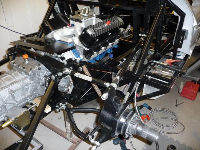

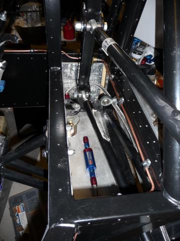

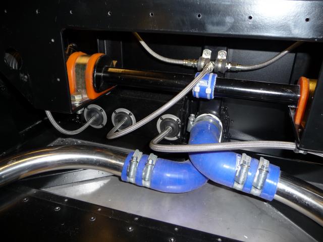

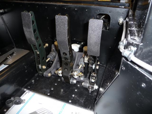

In the past week I have done a large amount of work on the car. I have piped up all the front brakes and clutch plus some of the rear brake piping which was an ordeal in itself. The tilton pedal set is now fitted and has been done so that it can be moved forward and backwards without having to mess with the pipe work. I have also hung (temporarily) the offside rear suspension so that I can mock up the fuel system and gear change.

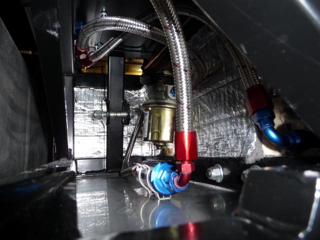

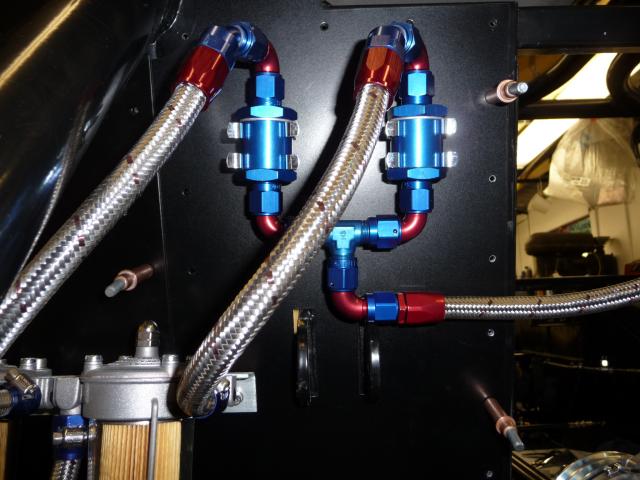

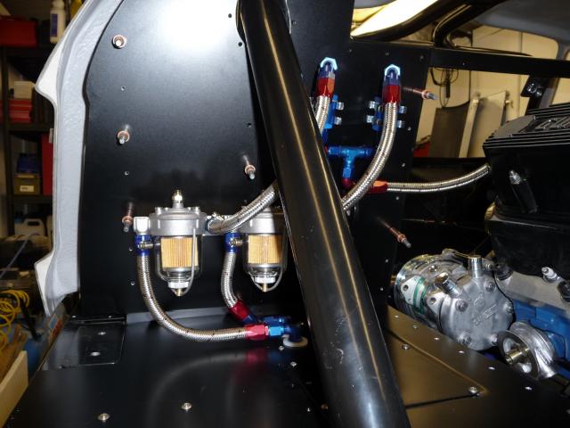

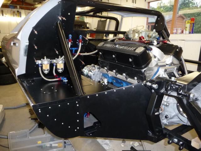

After a nightmare two days where nothing went right I have had a good day and got some work done. Practically finished the fuel system bar the breather/roll over part and done a load of panelling.

Looking very nice there Martin - :thumbsup:
One thing though - If you are intending to use it for any competitive events you'll need to change the glass fuel bowls to metal items as they are not accepted on later builds by MSA. (or weren't last time I checked)...
Cheers Paul for the info. I bought the glass bowls primarily for road use as I found my old GTD would allow water into the fuel system. I was unaware of the ruling so will get some ally bowls for next year when I get my Manx Classic Trophy back!
