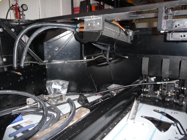

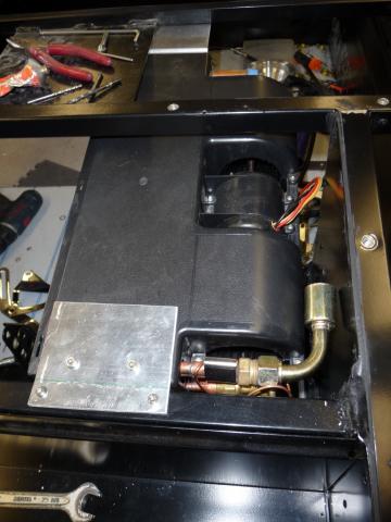

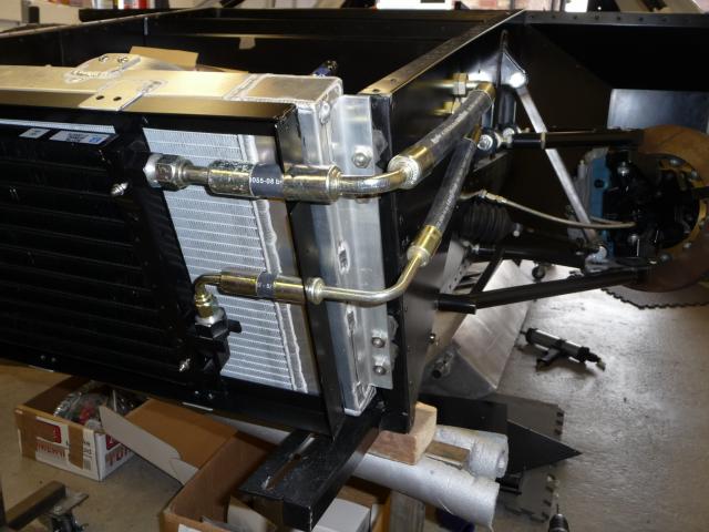

Done a load of work today and got most of the aircon system in, just need to get all the pipe work clipped into place and at a later date get all the pipes crimped.

Some pictures of today's work.
Martin.

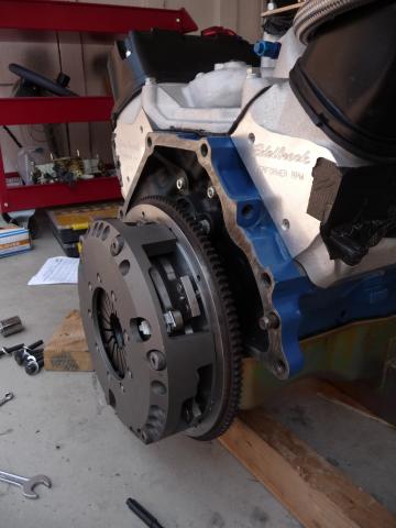

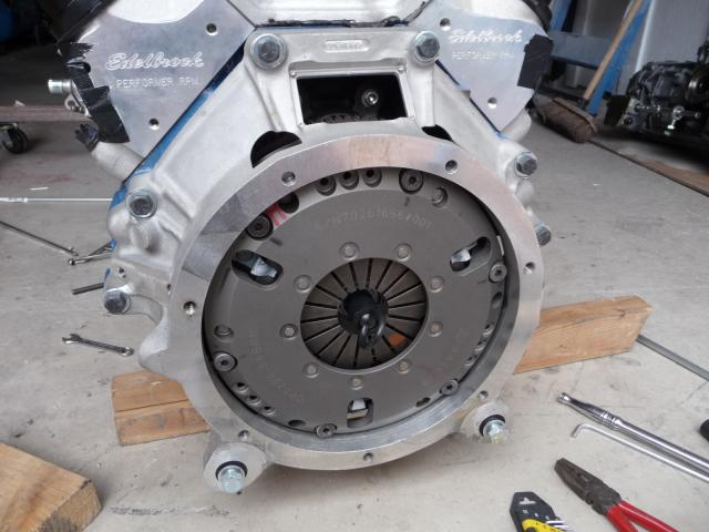

Just time enough today to put on the flywheel, clutch and bell housing. Need a lot of bits and pieces to carry on which I will chase up tomorrow.

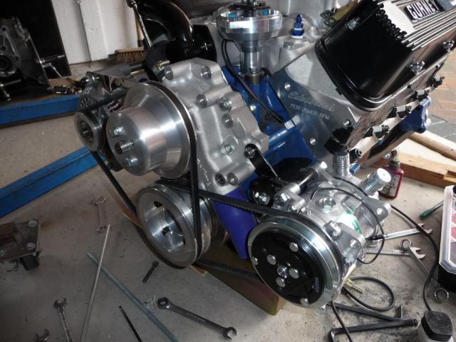

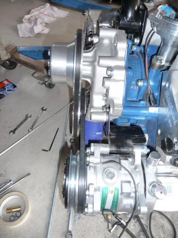

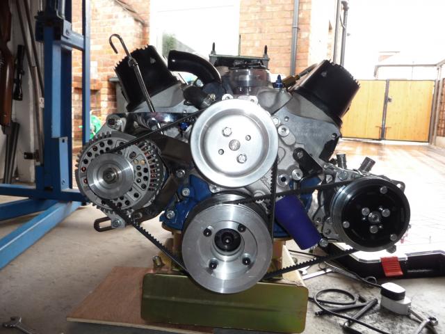

Managed to finally get all the pulleys to line up and fit the alternator/aircon compressor. It took longer than I thought it would and needed pulleys from Mick Sollis to do the trick.
Hi Brett.
Mick Sollis made the bracket. It has been chopped by me in an attempt to fit the compressor and all the belts but I got it slightly wrong first time around. Having then got the water pump and crank pulleys from Mick it all fitted. I will get the bracket welded on tuesday to remove the washer which are only temporary.
Regards Martin
Martin,
Most of the brackets for the compressors are just fabed to accommodate the type of compressor/enginefront etc. that you have. It is just a matter of using the small amount of space you have with the alignment of the pieces.If you neeed ideas for some I have a collection of photos of the various types. If you would like some inspiration for doing your own, go to
Pictures by Billmusarra - Photobucket
and browse the various albumns. I have lots that I have garnered from the forum.
