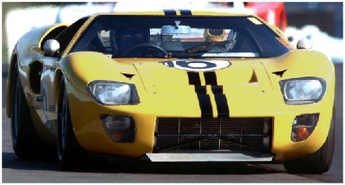

The SPF MK II front clip is actually based on a MK II "B" with the area in front of the tire more "vertical" than the "A" model. Almost all of the MK IIs differed somewhat from each other and the Shelby and Holman Moody cars had numerous differences.
Sorry, Rick, I was still editing when you posted...
If I knew nothing about the two individual cars I would guess the opposite, since to me the P1032 clips (both) look more designed for clearing wider tires than P2160's; P1032 is distinctly wider at the vertical centerline of the wheels (if we assume same track, width and offset wheels).
OTOH I do see the MKIIB-ish difference of P2160 in front; it's the transition from door forward that I'm having trouble accounting for. P1047J (MKIIB) below shows the more vertical sides at the front, and also does not show the moving-forward flare-out the P1032 does, so maybe this is all about wheel offsets and width.
Admittedly 3D objects in 2D photographs are very hard to analyze.... And in these photos P2160 has no engine. These days she is riding a bit lower.... but that shouldn't significant change her rear track.

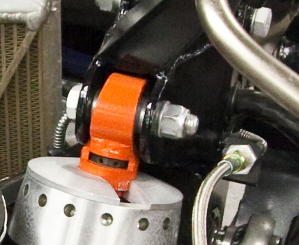

The whole frame issue boils down to this: The frames we use on our GT40Rs are almost exact duplicates of the original frames as they were delivered from Abbey and Tennant Panels, but those original frames were rarely raced without some enhancement and structural modifications by the various racing teams. Just like today's race cars, improvements are made race-to-race, and so too was it back in the 1960's.
A good example is the Pathfinder GT40 shock reinforcement plate that was designed and built for us by Holman & Moody: It wasn't on the original Abbey Panels or Superformance chassis but evolved from street and track experience. This is just one of the upgrades that is now included in the Pathfinder/Holman Moody GT40R.

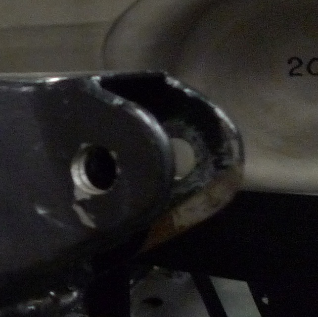

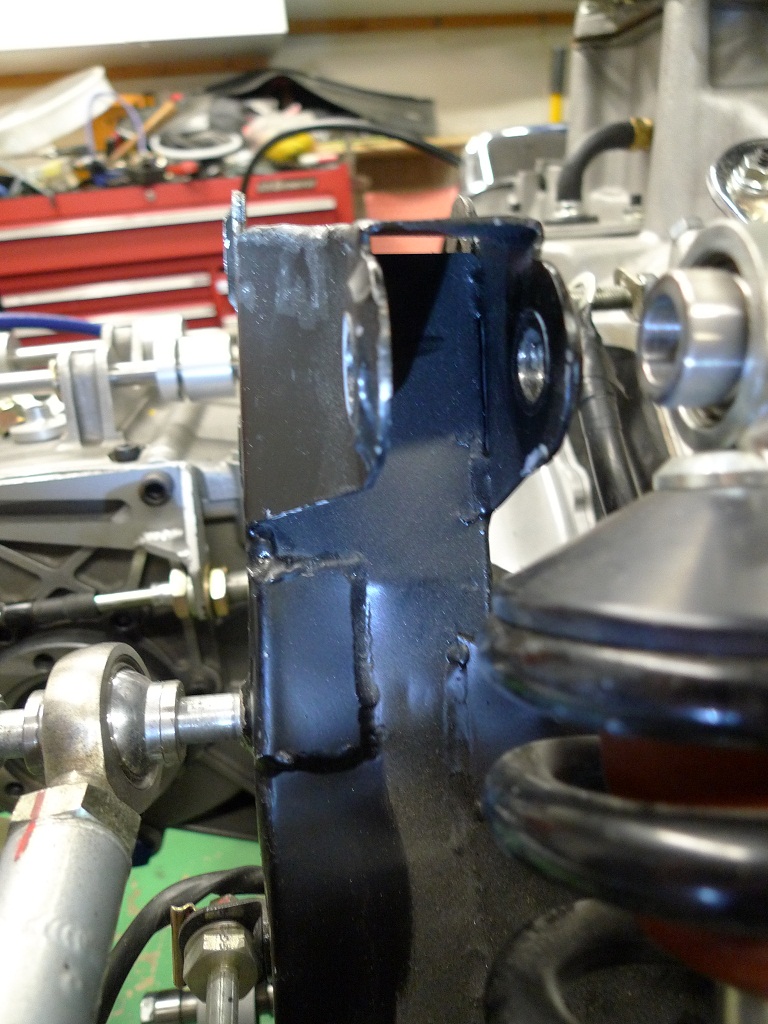

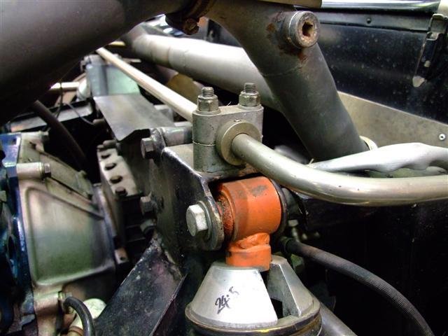

Back on the rear anti-roll bar problems, we have a new development: in this post
http://www.gt40s.com/forum/original-gt40s/35430-1103.html#post357298
the thickness of the top shock mount on an original Mk III street car P1103 is two laters of steel totaling 0.150", while that on my SPF P2160 is one layer 0.075" thick.
To see how visibly obvious this is, see below photographs of that area from P1107, from an HM Mk II chassis, from original mk II P1032, and lastly SPF P2160:
P1107 shock mount.jpg HM shock mount detail.jpg 1032 shock mount detail.jpg RHS R Shockmount from right rear.jpg
So, does anybody out there still want to describe the last picture of an SPF frame, even regarded as a Mk I replica, as being "OK" because it's original?

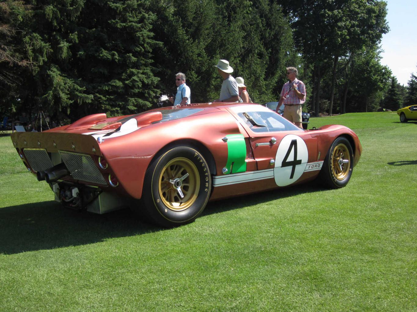

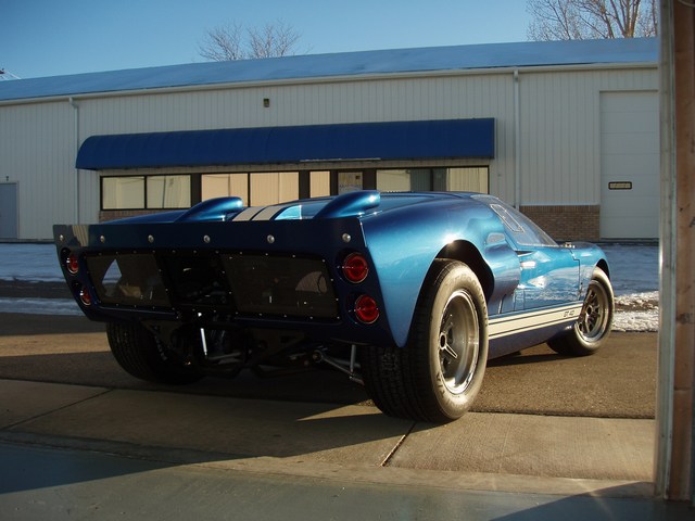

And back to the body, SPF didn't fit the doors correctly either.
