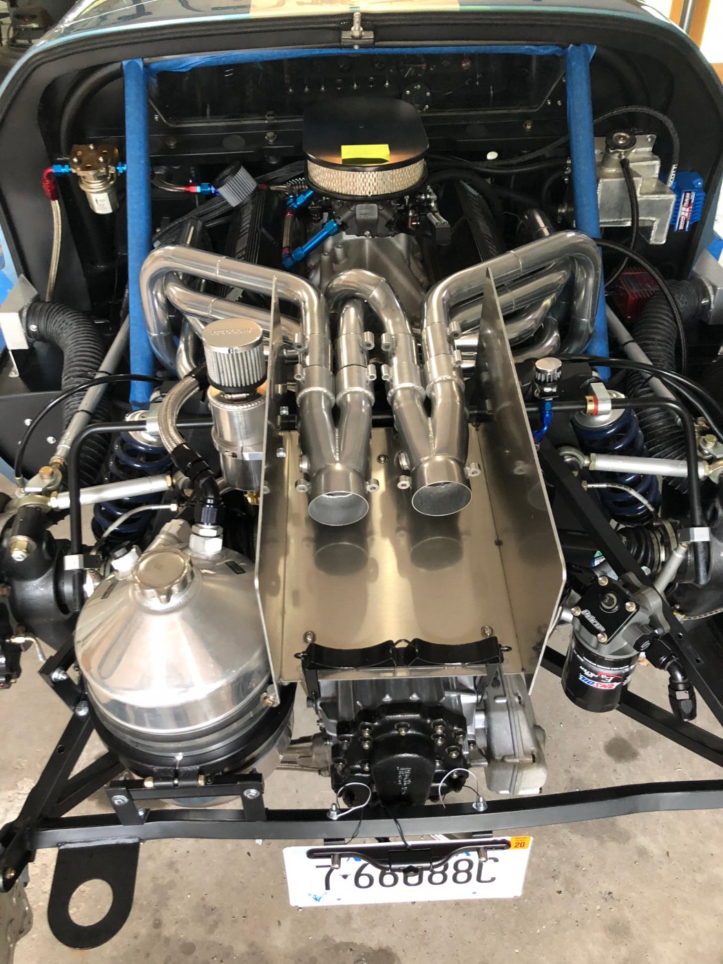

A little mockup of the bundle of snakes...........unfortunately, it all comes off as I tested the throwout bearing today and the clutch doesn't engage. Not sure what's going on. With the car in neutral, the rear wheels spin freely. With the car in gear the wheels are engaged, but push the clutch in and they're still engaged. I measured and checked the throwout multiple times, thought it was set and thought I checked it once installed. Regardless, it's not working now so everything comes off.
I'm seriously considering an external slave. I hear mixed reviews on the longevity of the internal slaves and I don't relish doing this again in the future.

Steve,
I am not a fan of the internal slaves, we have seen too many fail and as you know it is a job to replace them. Had one with less than 6 hours on it fail in Fran's SPF GT roadster at SAAC in Indy two years ago. I was riding shotgun with Paul and as he came down the front straight and went to downshift, we had a box full of nothing. At least with the external you could replace it on site or even barn a replacement in to work.

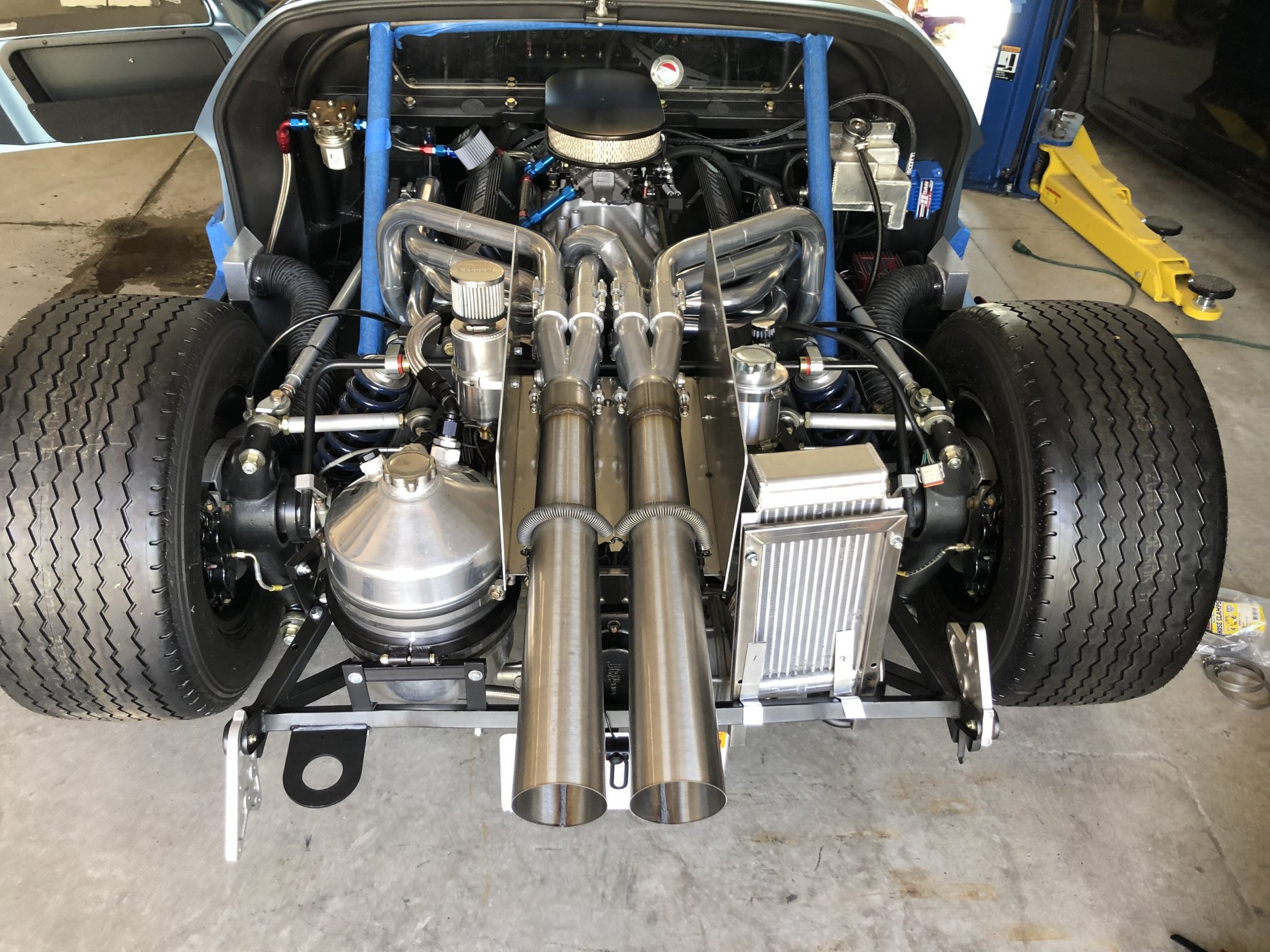

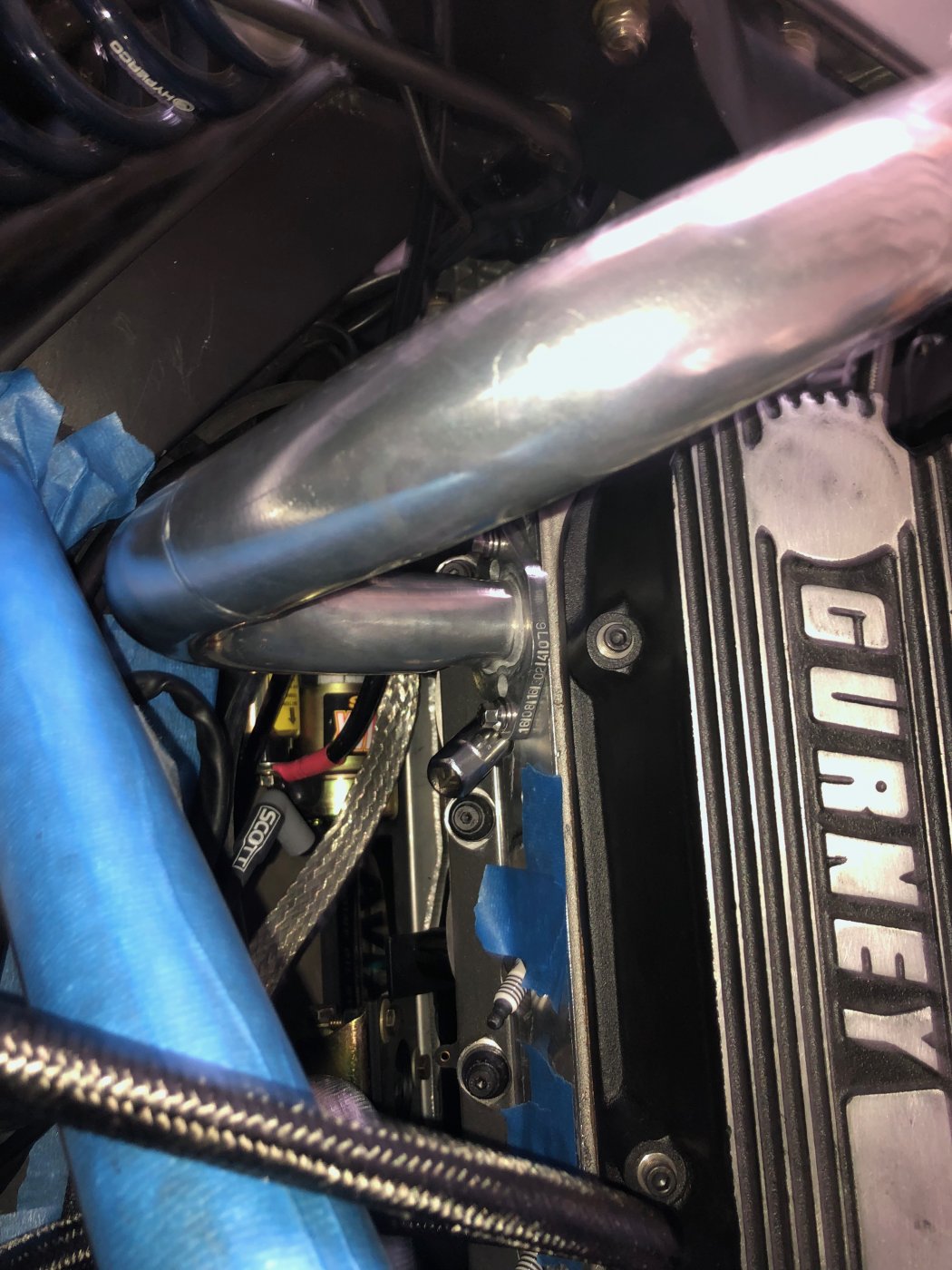

Well, I just dropped the car off the jack stands and had my 13yo step on the clutch and I can roll the car, must have just been the resistance of the internals when I tried to roll the one rear tire on the stands. For sure when this throwout craps out, I'm going external. The #7 header rubs on the back of the valve cover just enough that I think it keeps it from seating fully, might have to pull out the die grinder and take off a mm or 2. The collectors go on pretty easy and the headers are finger tight, so I think they're ready.

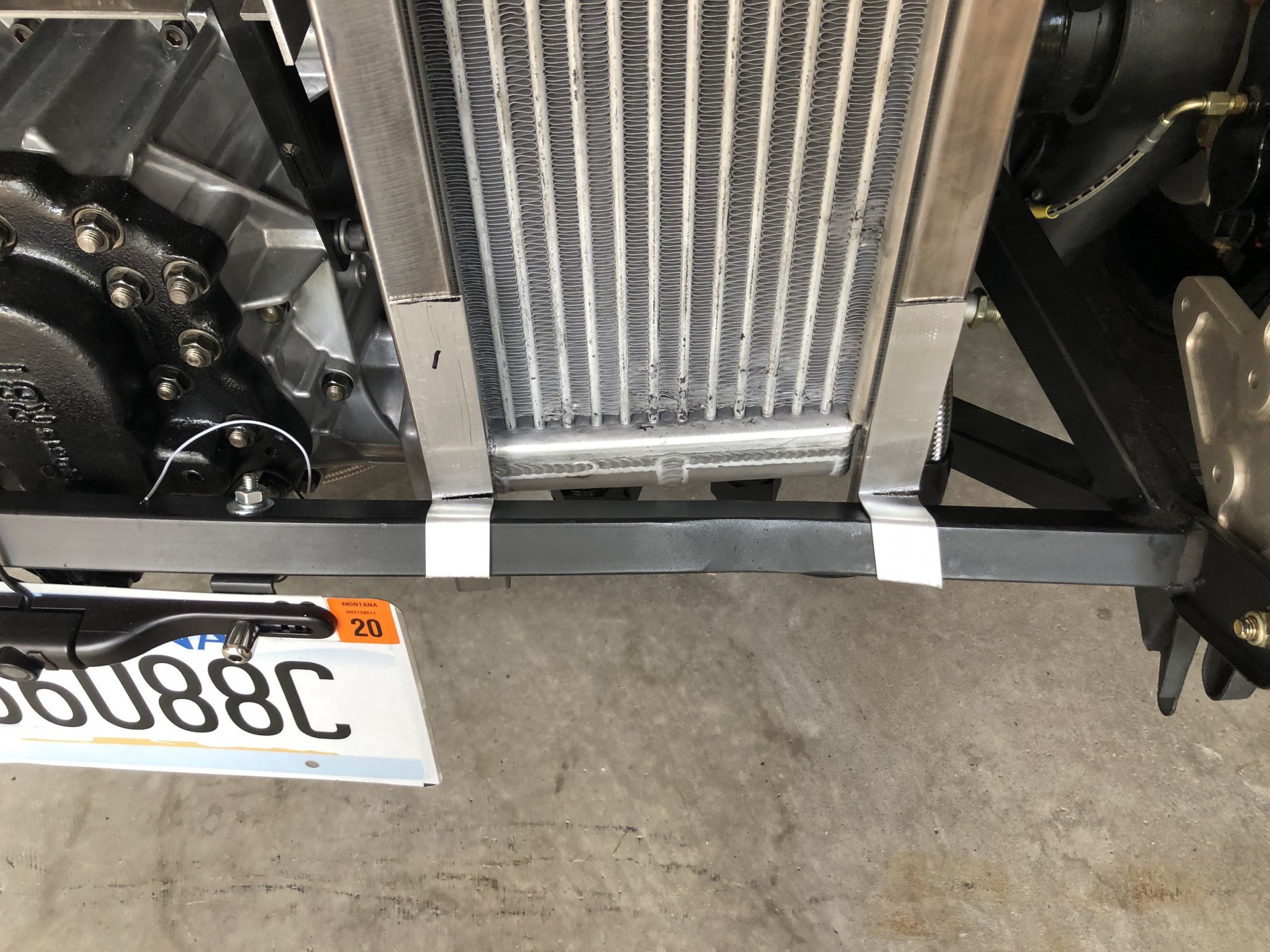

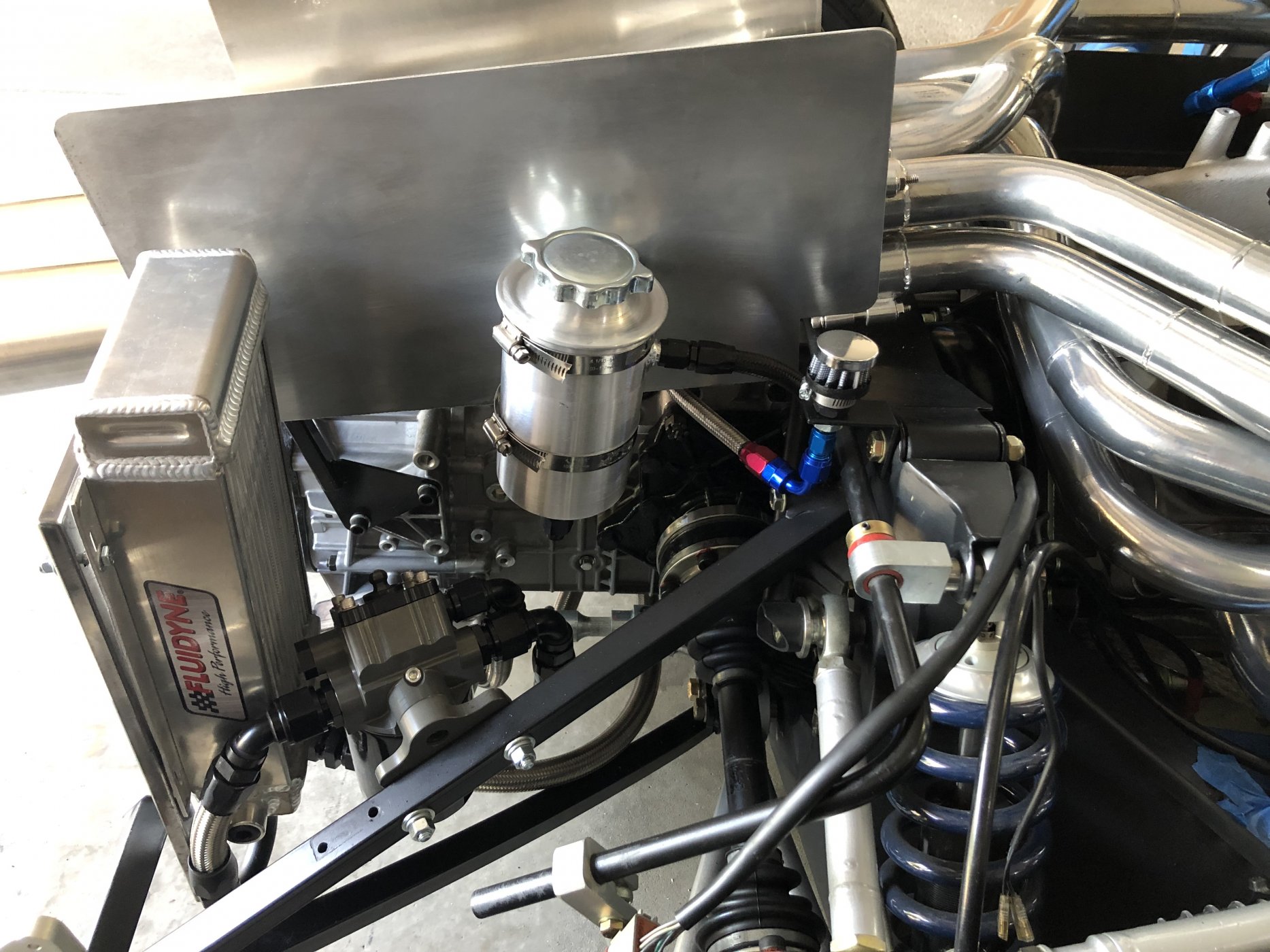

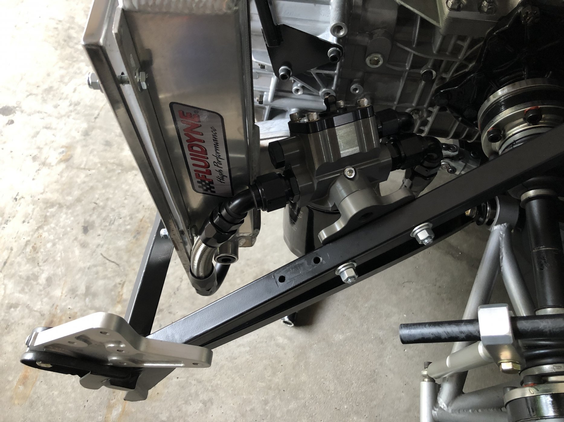

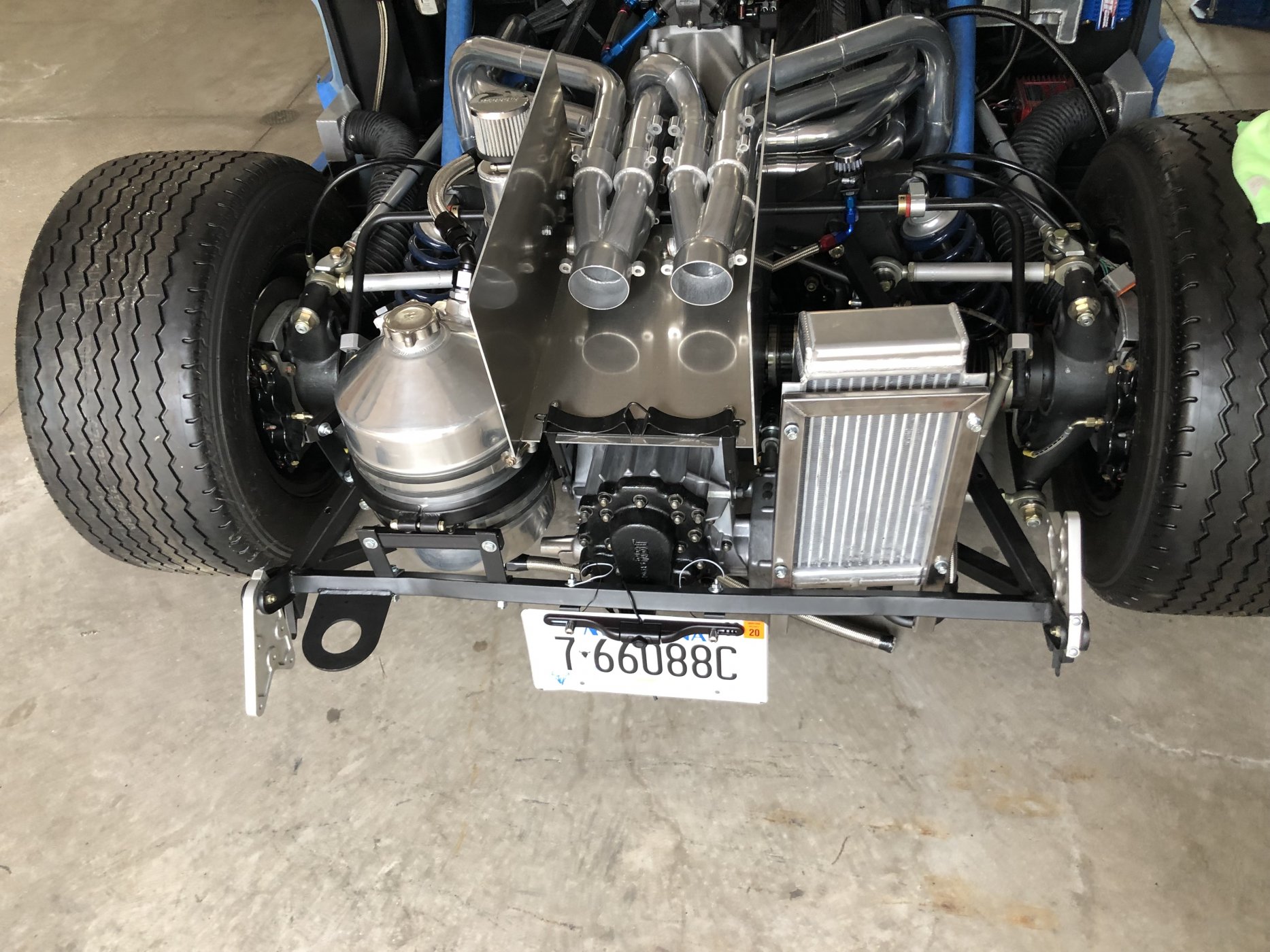

A trial fitting of the oil cooler. Pretty tight with the primer in there. It nearly rubs on the box on the side of the transaxle. I'm trying to leave a 1/2cm of space there so the vibration from the transaxle doesn't affect it.

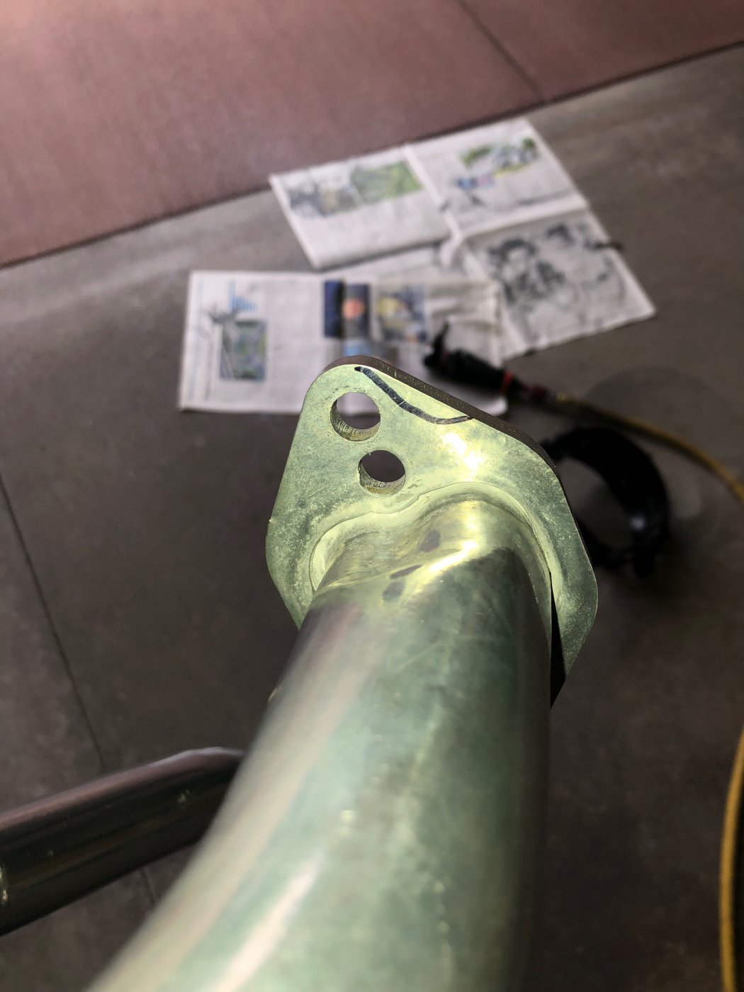

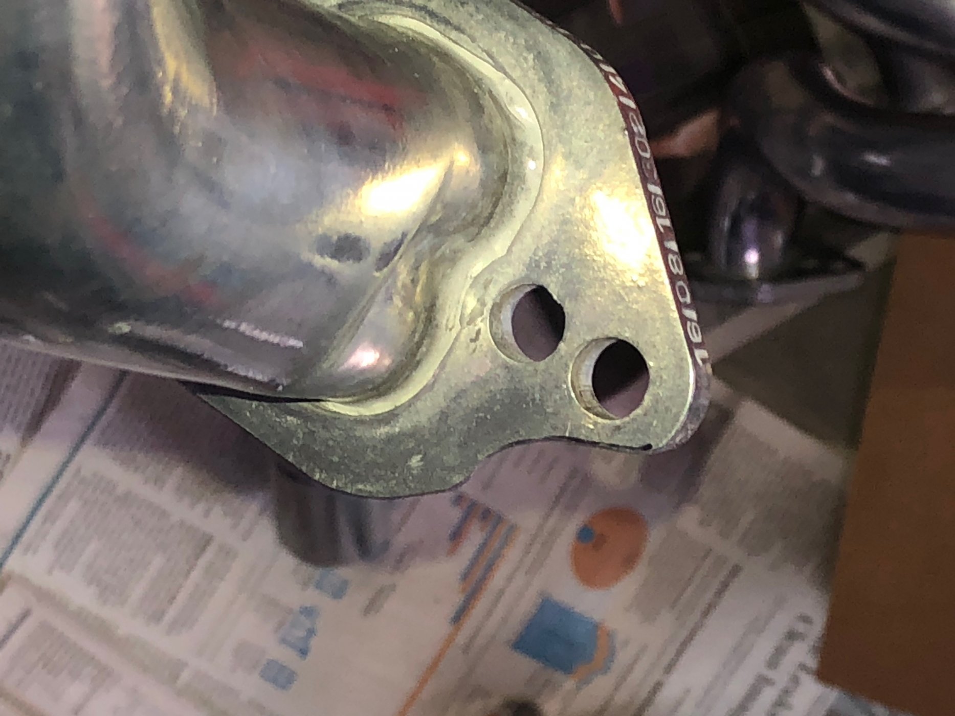

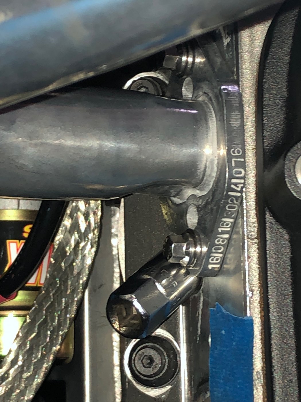

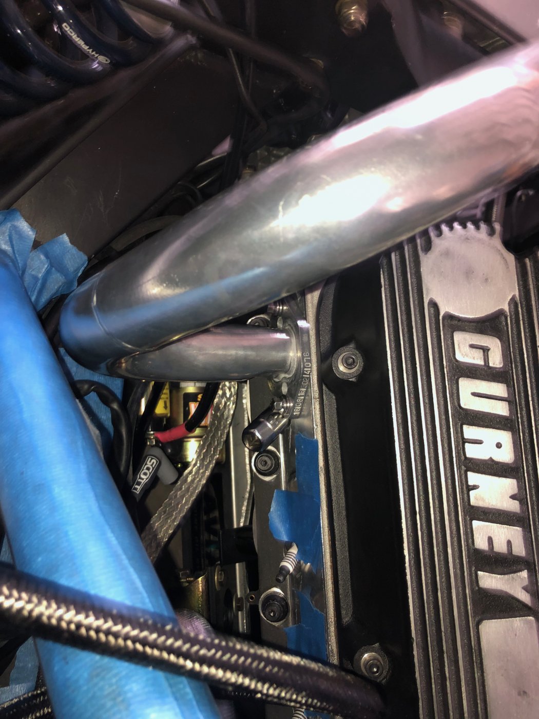

After the header trial, it became clear that I wouldn't be able to remove the spark plugs with the headers in place. Took the die grinder to each header. Ultimately, the space between #7 and the valve cover is still tight and I can't remove any more from the valve cover. Probably a sixteenth at the most. Not much room for expansion. Tried to take a dead blow hammer to the header to put a slight dent in it. No luck. Will take it to a custom exhaust shop nearby.....

Grinding is done and I can get a standard socket in there. Truthfully, I don't think the plug would have come out and a socket absolutely wouldn't slide down it. It's likely related to the aluminum heads I have (Dart CNC) I'm getting a Sealey thin ratchet as well. There's not a lot of space in there to attach a standard 3/8 inch ratchet to the spark plug socket.
I bought a socket made for a lawn mower , made from sheet metal its a lot thinner . I think it was .98 cents and works well on my 289 drivers side rear plug.
