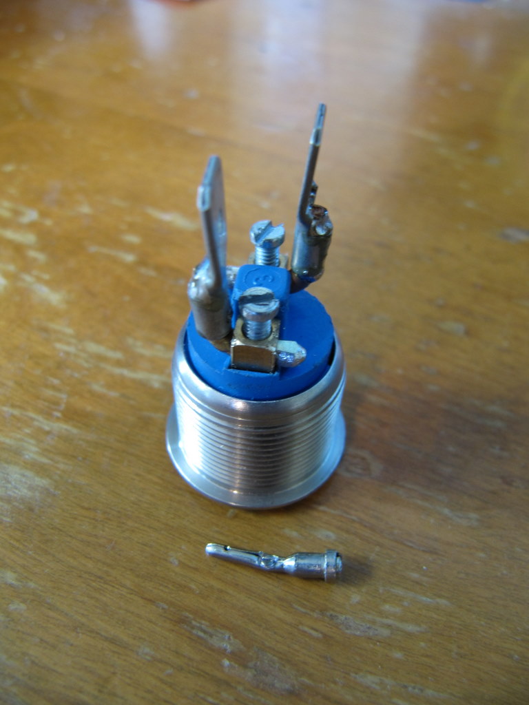

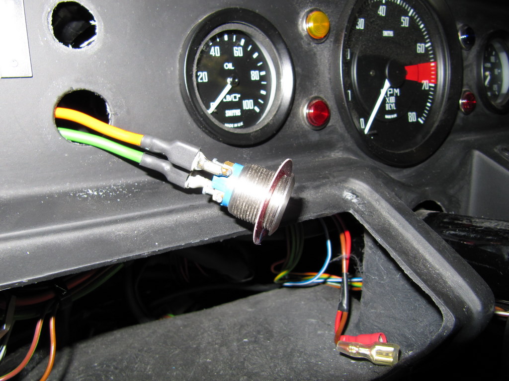

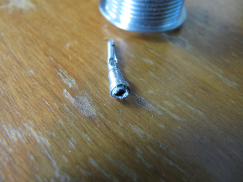

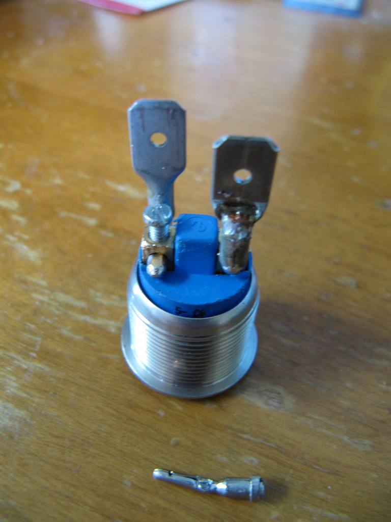

Some more on the starter switch supplied with my SPF GT40 P2160:
As I mentioned back in July of 2011: due to the poor wiring practices used at the factory one of the wires to my starter switch had quietly broken off behind the dash. I fixed that. The other day I went to fire up P2160 for the first time and discovered that since then the other lead had broken off.
So at this point enough was enough with that s****y switch. I researched alternatives and discovered there are many with a better terminal style than the set-screw type we have.
(But keep reading because here's a chance to raise your GT40's reliability even more, and it's cheap and easy.)
Then, I discovered something alarming: the supplied switch is way under-rated in current carrying capacity for use in my car. I have a McLeod ministarter that draws a little over 10A steady-state. There is no version of that switch that I can find rated for more than 2A. So this is another "meet the tow truck" incident in the making. Even so the same switch from Digikey costs $24:
http://www.digikey.com/scripts/DkSe...&lang=en&keywords=679-1060-ND&x=0&y=0&cur=USD
There are a lot of pushbutton switches out there with 1/4" faston terminals which is what I wanted. In particular there is the Lucas switch (SPB106) supplied for our horn buttons. That switch would be a near drop-in once you've terminated your starter wires with female faston terminals.
However, I could not find a current rating for the Lucas switch and so decided to keep looking. Also the Lucas part costs ~$30.
Here's what I ended up using, for under $5:
KFB2DNA1BBB Cherry | CH944-ND | DigiKey
Here's the spec sheet:
View attachment CHE_214683_KF_Wtrprf_Rckr_DS_D.pdf
This is a simple, plain-looking weather-proof pusbutton switch rated for 20A at 14VDC. Ir is a "snap-in" switch although it will not snap in all the way into the hole in our dashboards. I chose to push it in until is was firmly attached. Later I will carve a little on the edges of the hole to make it seat completely. It has 0.187" terminal tabs, and to fit those perffectly you can buy these:
http://www.digikey.com/scripts/DkSe...ang=en&keywords=298-10006-ND&x=9&y=10&cur=USD
I found that my already-installed high quality 1/4" female faston terminals worked fine.
You could also use a 20A Dorman 85984, but it is slightly small for the dash hole (5/8" instead of 3/4") , has screw terminals, and requires surprisingly strong pressure to activate. And it's funny-looking.
You could also keep the existing switch and install a relay to handle the extra current. I declined that option on the basis that the increased complexity reduces overall system reliability while there is a simple parts-swap as the competing solution. Besides, I have no affection for the form or function of the stock switch (it belongs on a vending machine) and really wanted a chance to "float test" it in the nearest sewer.
In any event, do something. That original switch is going to quit working someday.
(PS: with a clip-on remote starter switch P2160 fired up. Regarding the ensuing sounds, I quote Terry Hatcher in "The Implant" episode of Seinfeld: "...They are real and they are spectacular!")

The starter draw is not going via the switch, the switch is feeding the starter relay. If the full amperage went via the switch, the starter cables would need to feed through it. Are you saying the RELAY draw on your starter is 10 Amps?
Perhaps it may be under capacity for the relay also, but to date we have had no trouble with it that I am aware of.
Seymour Snerd
If by "starter relay" you mean the contactor and solenoid mechanism that is a part of the starter, the answer is yes, it draws 10.4A. Go measure yours and tell me what you find.
As for "we have had no trouble with it": that just means your lucky so far.

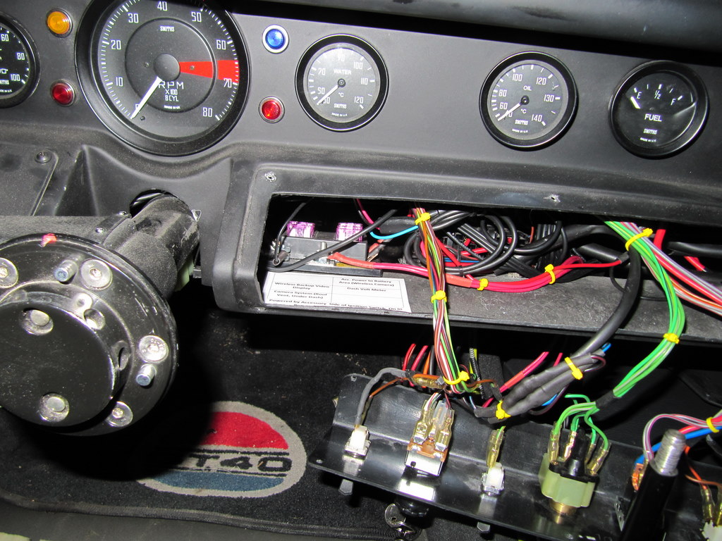

We could always add a relay to the starter relay, I think that's right. I've thought from the very beginning that I should wire up the momentary side of the key switch as a backup. Not a sexy as the push button but after all that was what it was designed for.
Seymour Snerd
That's yet another good alternative. The stock rotary ignition switch likely is designed to handle starter solenoid current, unlike the stock start switch which is in reality an "anti-vandalism" switch designed for use in vending machines, ATMS, etc. Here is the spec sheet View attachment AV-B.pdf
A derivitave option from that alternative is to then move the rotary ignition switch to either the hole currently occupied by the start switch, or to the one currently occupied by the horn switch. Either would be even more period correct, and would allow you to abandon the somewhat tacky-looking "center console" supplied with the car.
Then you would have an open footwell like a real GT40 and would be able to admire your passenger's ankles while underway.
