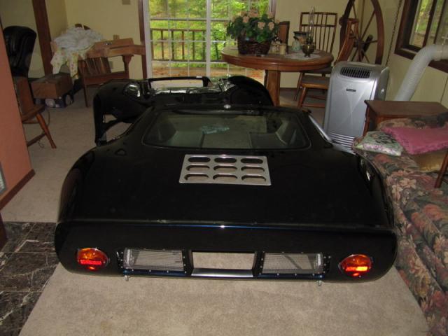

If you're not married you could do what I did and store them in the living room. As you can see they take up one hell of a lot of real estate. Wow that's like twice in one day I got to tell people about that one. Good luck with your build. I'm so amazed I got mine running but oh my is it worth every bleeding body part you put into it.
And if you are married and want to become unmarried store your clip in the living room!

I rather liked them in the living room. Unlike the car which was in the garage these parts were very visible and helped keep my interest up to finish the car. Now that I can drive the car storing them in the living room is out. The front clip isn't to bad to move yourself. I installed the rear clip myself the first time it went back on the car, NEVER again!

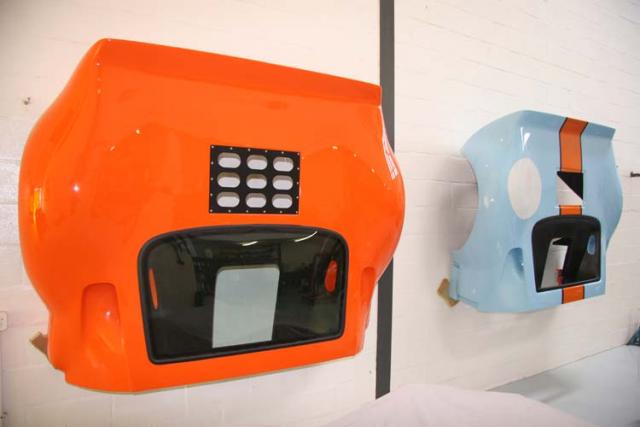

Awesome idea, it becomes art. Where do you store the noses? I just wish I had that kind of floor space.
If your walls look that good how about some pictures of the rest of the garage? You need blue strips on the orange body to make mirror twins.
