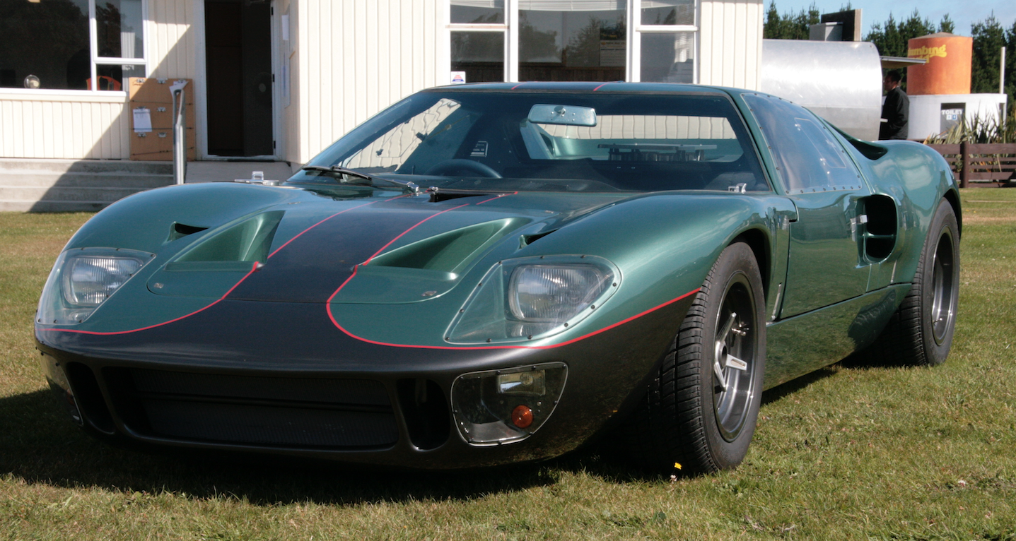

Brian Stewart
This car was shod with the Cooper Cobras. it is my understanding that once everything was sorted and they started using it at pace they switched to Avons, but that is second hand information so don't quote me on that.
