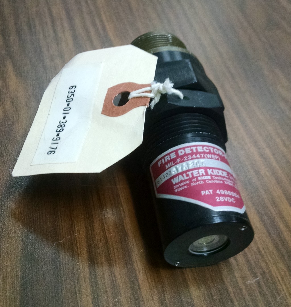

Is there any ultraviolet or infrared sensors that can auto set the system off? In mid- or rear engined cars you are the last one to know you are on fire.
Neil
Rod;
Yes, there are sensors like that. I have one from Kidde Aerospace that uses dual-wavelength sensing to detect petroleum fires by the scintillation of the flames. Look at Walter Kidde Aerospace website, there may be some information on that technology there.
Interestingly Graviner fire detection systems were fitted by JWA to their cars in period and Graviner merged with Kidde to form Kidde Graviner later on.
Neil, is this similar to what you are using? If so, where are you mounting it?
Neil
Spud;

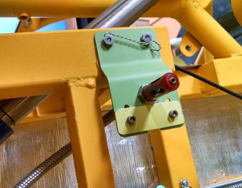

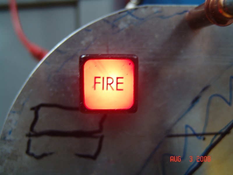

This is the fire detector that I have. I have not mounted it yet but it will be installed in a round hole in my Inconel firewall, looking at the driver's side header area. Its field of view should cover most of the important places. I have two 10lb automatic Halon fire bottles covering both sides of the engine in case a fire breaks out.
