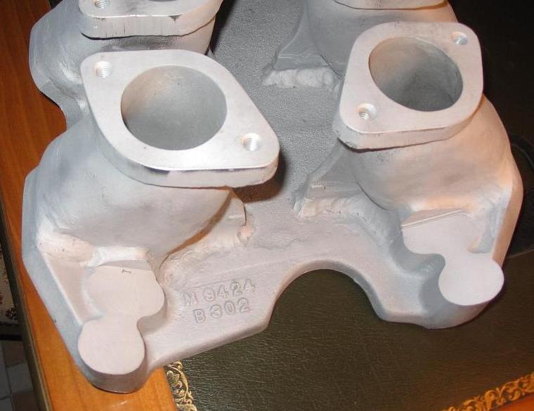

Your induction project looks very nice but will not be easy if you select the Weber option. The main difficulty is to find a special manifold to adapt Weber carbs on Yates cylinder heads. Furthermore, with a 8.7" deck height block there is very few manifolds available on the market. I believe that the best way will be to build your own manifold or to order it to a manifold specialist such Hogan's
Hogan's Racing Manifolds

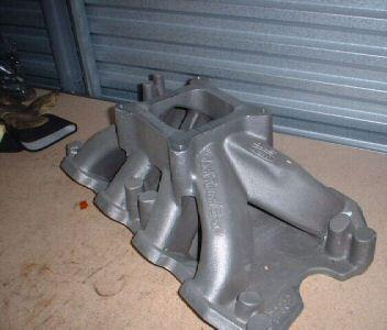

Weber + Yates association is fantastic. May be EFI system is more efficient but Weber carbs with Yates heads are good enough to expect more than 500hp from your SBF. I have this package on my engine and I have built a special manifold based on a standard Yates manifold. I use 48IDF carbs that have a shorter barrel center line than 48IDA.

Believe me, I know the pains of the unusual manifold. I found a shop in Indiana called Price motorsports and the owner has 1/2 intake flanges, cast aluminum runners and a billet weber mounting plate. It will all weld together into a nice custom piece. He is going to build a 3 piece intake for me. There will be a left and a right intake with a valley pan. The cool thing is that you can take the intakes off so easily. I think it will be basically the same as mine only less pieces.

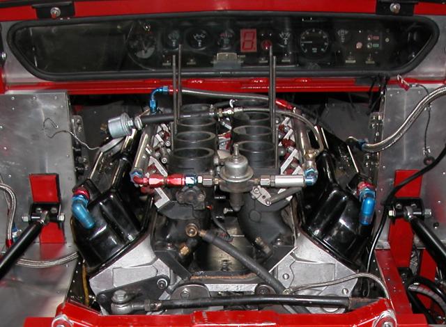

Go Motec Efi - Still looks good - will match or better Weber HP figures - better road manners, especially on a more modified engine - better fuel consumption - can be 'tweeked' for ANY modifications to motor - NO FLOAT BOWLS - can be optimized for each individual cylinder's requirements - probably fewer parts - better emissions (if you're 'Green') - NO 'spit-back' fires when starting:eek: - Sounds as good as Webers inside the cabin - The Motec unit also includes fully programmable ignition, that again can be optimised for each cylinder if required and will allow you to add whatever future developments you may have in mind,traction control (for 'other/novice' drivers?), launch control, full throttle gear shift - full engine data logging (black box recorder - just in case:o ) -
and Finally
HOT,COLD, SUNNY or SNOW, one press of the button and off she'll go! :)
But hey - as I've always said, i'm biased - :D

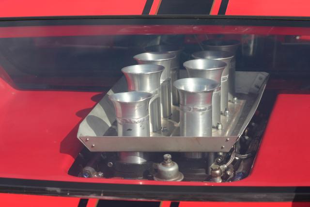

Well the webers are on the way! I know what the charts say about not pulling to 6500 but my 408 runs awesome to 6500 then it hits the rev limiter. I like the look and they run great. It is 38 deg. outside and I backed the car out of the trailer and it started up and idled great. No chokes, no electronics. I think the 37mm chokes are a little small but I think my 42mm's give up to much bottom end performance. The lesson learned is "just shift"! I have 5 speeds and at 6500 in 5th I am going around 180mph.rockonsmile That is definately fast enough!

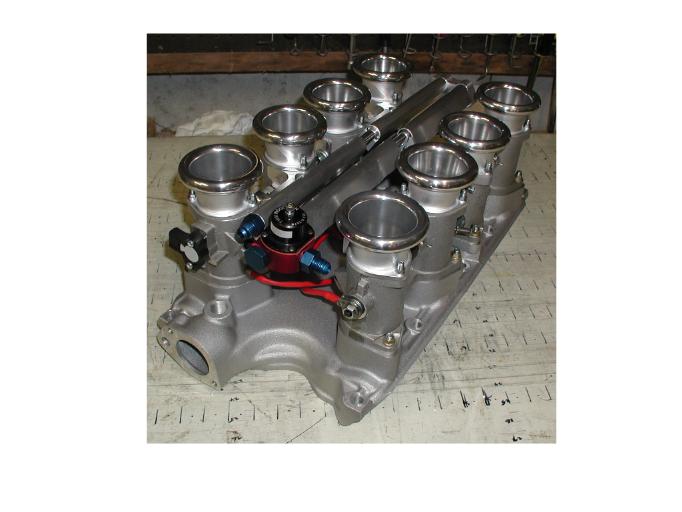

The thing I liked most about the TWM setup is that the fuel lines run down the middle of the manifold away from the exhaust lines.What most are doing is taking the throttle bodies and swaping sides so that the fuel lines exit the front of the engine(see pic). It is a simple setup that requires you to select your own ECU as each person has their own requirements. They have links to most of the manufacturers(?) or types on their site. For my money, Motec is way over rated. There are some systems that have less and cost a whole lot less. but who needs traction control anway??? I can't remember the name of the brand my engine builder has selected(will post when we talk on Monday), but he was dead set against using Electromotive due to its complexity of setup(the one I choose). Once you type in sll the map points, if you don't make the correct sequence of key strokes all is lost. (no save feature) And you have to start over again. What I do know from looking at the software in action on a Mustang with twin turbos is that the car startup was a breeze, easy to modify settings and perameters.
