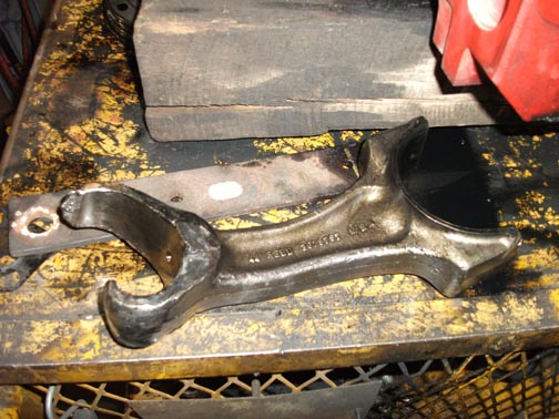

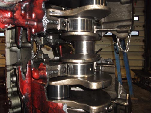

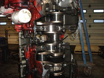

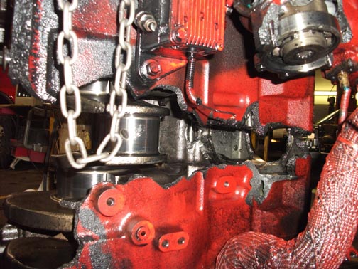

Here is a 15 Liter Cummins ISX engine that tossed a rod at around 1400 rpm. Nothing that $22,000 won't fix....
The pan was torn in half and all of the bolt ons (Alternator, compressor, etc. were broken off the block.) Now a nice boat anchor!

15 liter !, What was that from? Over the road truck, boat, or.........?
Class 8 OTR tractor with a gross combo weight of 80,000 lbs. Most tractors are either 13 liter or 15 liter with torque ratings between 1550 and 2050. The 600 HP/1950-2050 engines are the "hot rods" of the trucking industry. Of course as HP/Torque goes up, so does heat generation and fuel economy goes down. Most fleets will KILL for a tenth of an MPG as it really adds up. Also more and more "automated manual" transmissions are being used. The automated has the ECU and transmission computer controling the clutch and shifting. It tends to equalize drivers making your less skilled guys perform more like your best. The automateds come in two flavors, with a clutch which is used only for starting and full automated with a "two pedal" system that drives just like an automatic. they have control pads that allow manual shifting via butttons but generally you just hit "D" and go.

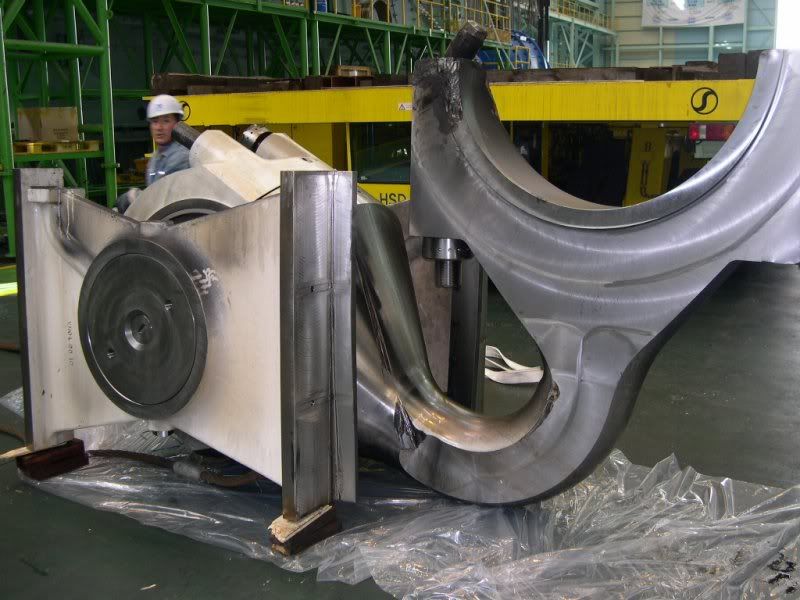

Here tis....
Believed to be from a Sulzer RTflex engine. 10ish cylinders, 980mm bore 3500mm stroke 100rpm. Hydraulic lock was the root, water jacket split. Bet they even heard that bang on the bridge!!!
