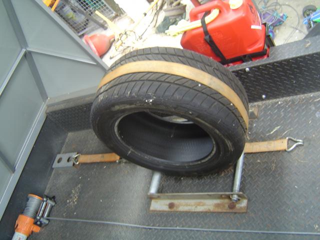

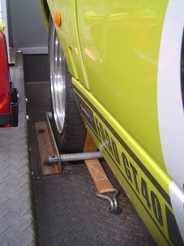

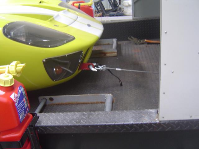

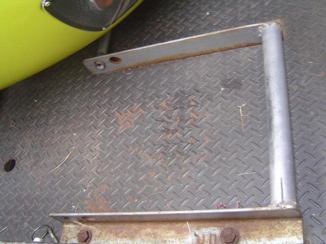

My trailer loaded with the 40 tows great with it driven on front first. No tail waging or wandering and straight stops. If you look at the picture you will see that the twin axles are placed more toward the rear than "normal" trailers. The tire stop face is 96 inches from the trailers rear axle center line, The distance from the tire stop to the center line of the gtd40 rear axle is 105". I could move the tire stop several inches forward if it were necessary, but after towing with car in several different locations , this was found to be ideal.
I thought I'd share some photos of the simple tie down system I made for my 40 trailer. The first photo is a sample of how the strapping goes over the tire and under the frame. Second shot shows the rear rail removed to allow the car to be positioned onto the trailer the final shot shows the car secured on the trailer. The advantages of this system is the car is positioned in the exactly same front to rear position because of the craddles for the tie downs\important for getting to balance correct for your trailer.

Andrew - I like your tie downs, but man they look like they would be a pain in the butt to hook up!
