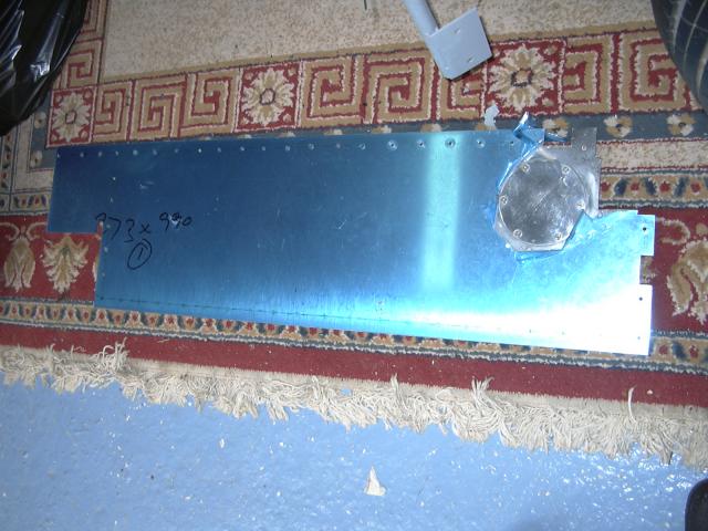

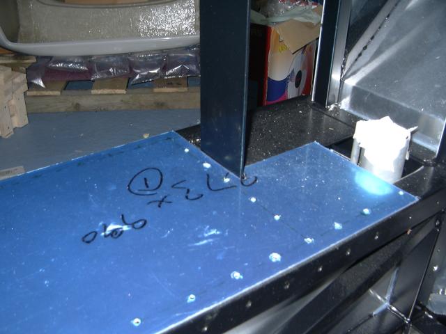

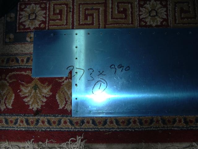

Trev,
Here's what I did...remembering of course that I too am learning as I go so hopefully this isnt the blind leading the blind here?!

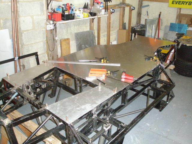

Saturday sill work
Progress update: My friend Dave came over today to give me a hand. After several hours 'planning' what we were going to do down the local pub we finally got round to cutting up the aluminum panels for the sills.
Big thanks to Dave, he's a good worker:
Car with cut sill panels:
