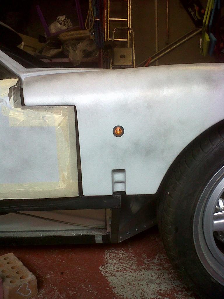

I have put 20mm side repeaters above the front clips, 7" from the bottom edge. BTW it's my daughters that draw hearts on bricks.

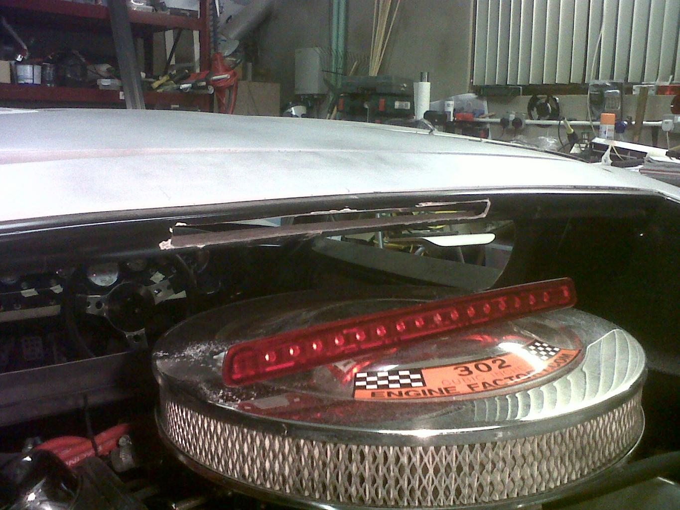

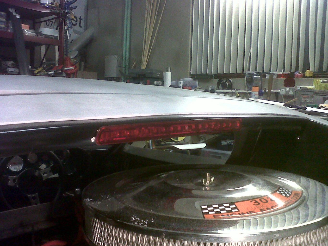

I have also cut a hole in the rear for the third brake light, although not mechanically secured, I'm waiting for aluminium to be delivered.
Next I plan to fit sidelights and some panelling, am I doing this car in the right order?

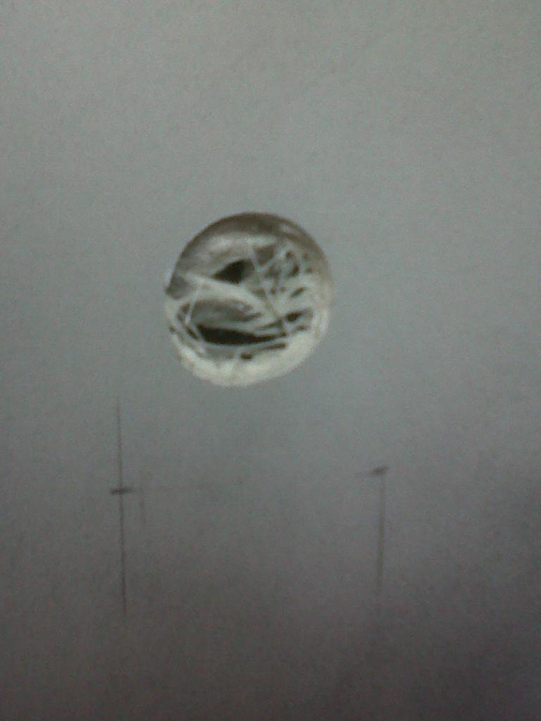

you can see the brake light hole has chipped around the edges, even though I had taped it for cutting and filing, what do you use for touching up/filling holes in fibreglass?
Hi Keith
Kniffing putty is great for small repairs on fibreglass, its better than body filler for the small touch up jobs as you dont have to mix it. Holts do some in a blue tube called cataloy kniffing putty. You can get it in halfords.

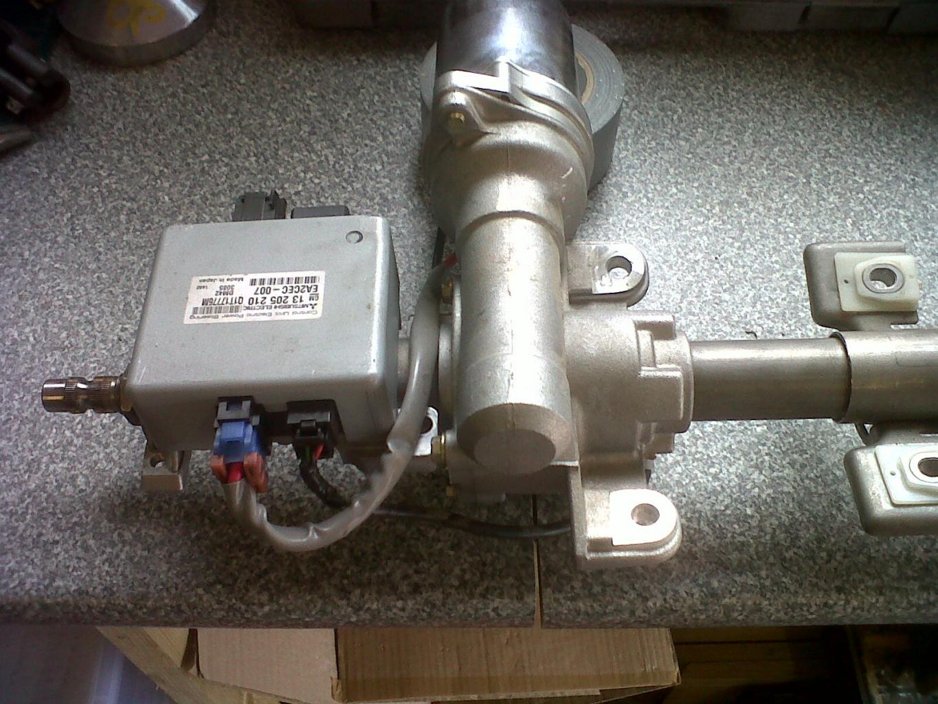

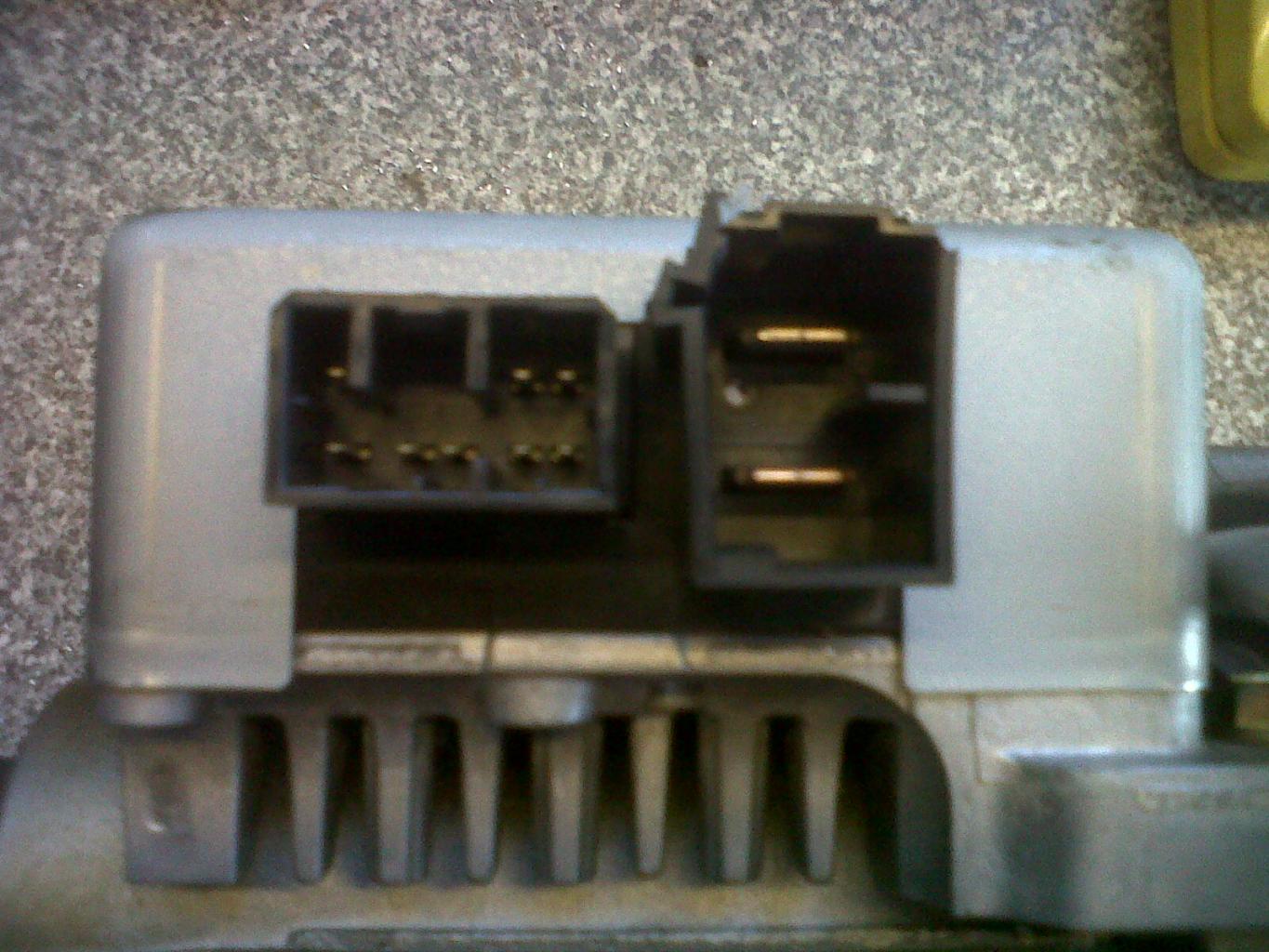

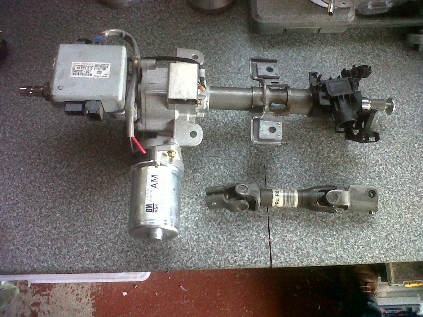

Got the Corsa C, power steering today (EPS, PAS, for benefit of searches), problem is, I did not get the input connectors nor any wires into the unit. I have searched online and any wiring diagrams I found refer to wire colours, which of course I don't have, so if anyone knows the connector pin-out I would be grateful.

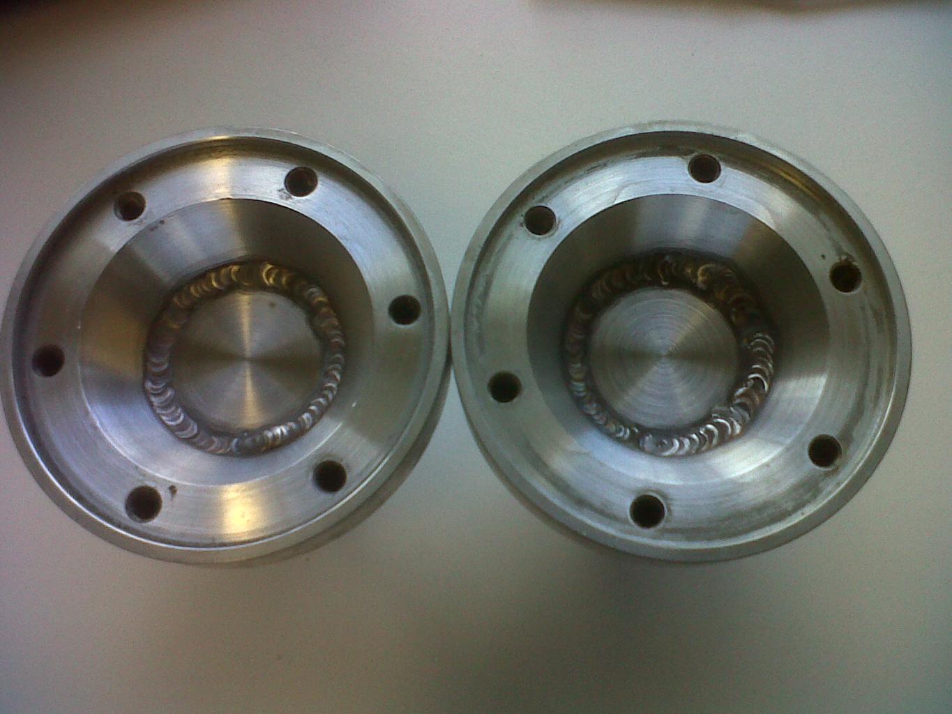

Also got my CV adapters back from the workshop, how beautiful.

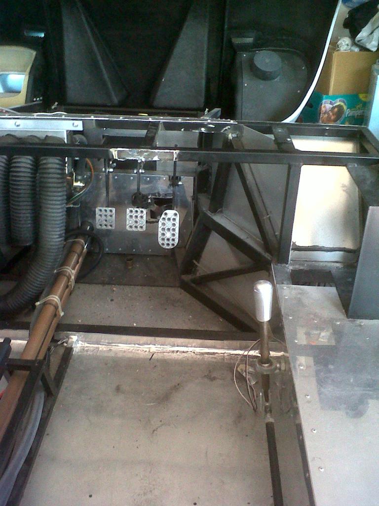

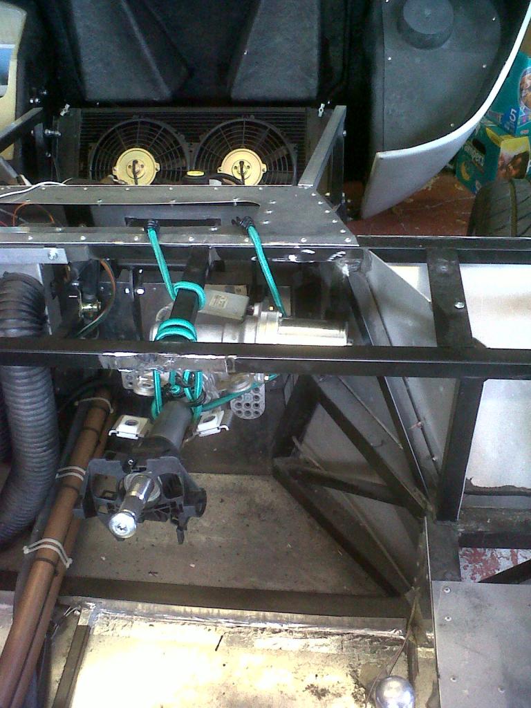

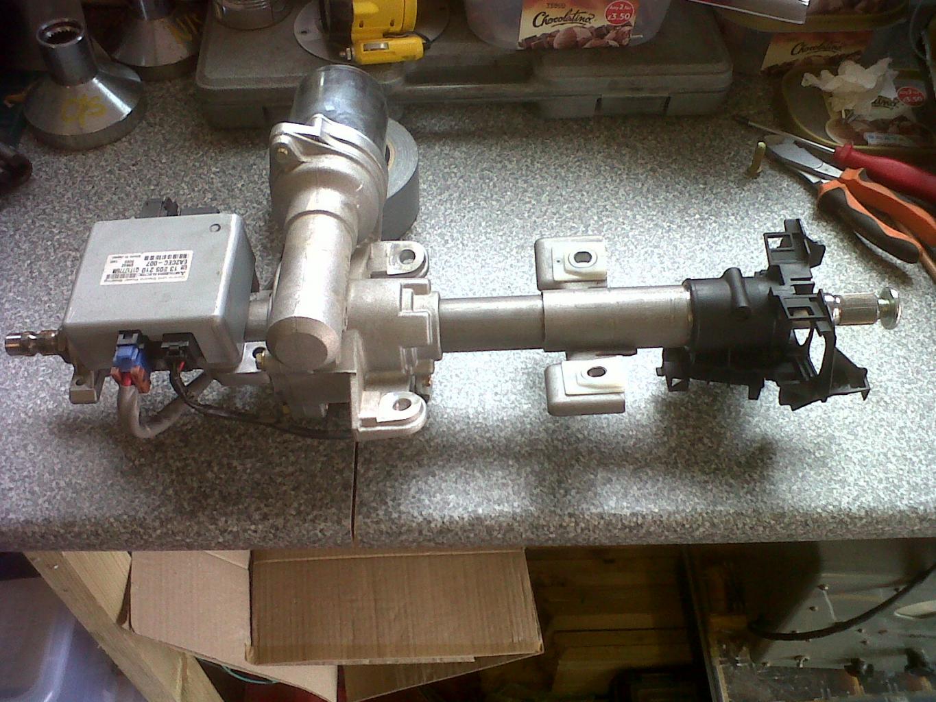

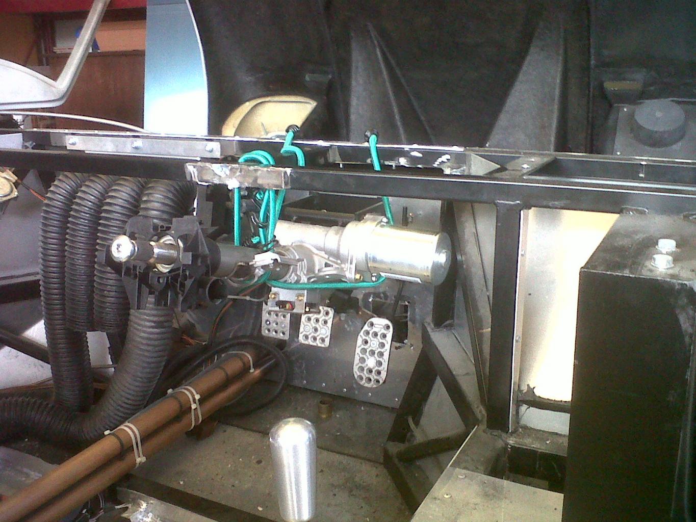

Today I cut the steering column out and started playing with the Corsa C EPAS. I noticed the ECU which sits on the underside of the column, is quite close to the pedals, especially the brake, so I plan to make a bracket and move the ECU to the top side of the column, same side as the servo motor, can anyone see a problem with this?
To me it's a no brainer, but that's from a standpoint of ignorance. I attach some pix with the ECU unbolted and just sitting in the proposed new position.

Well I've got a 'B' rather than a 'C' but here are my connectors to hopefully show the wiring colours.
Keith Stafford
David thanks for the wiring colours,... the only issue I see with moving the ECU to the top is that it will limit the size of bracket I can put at the bottom end of the column, having said that there is no need to have the ECU on the column, I can move it within reason. I'm continuing to think about the rpm/speed pulses, I don't want a manual conrol knob.
