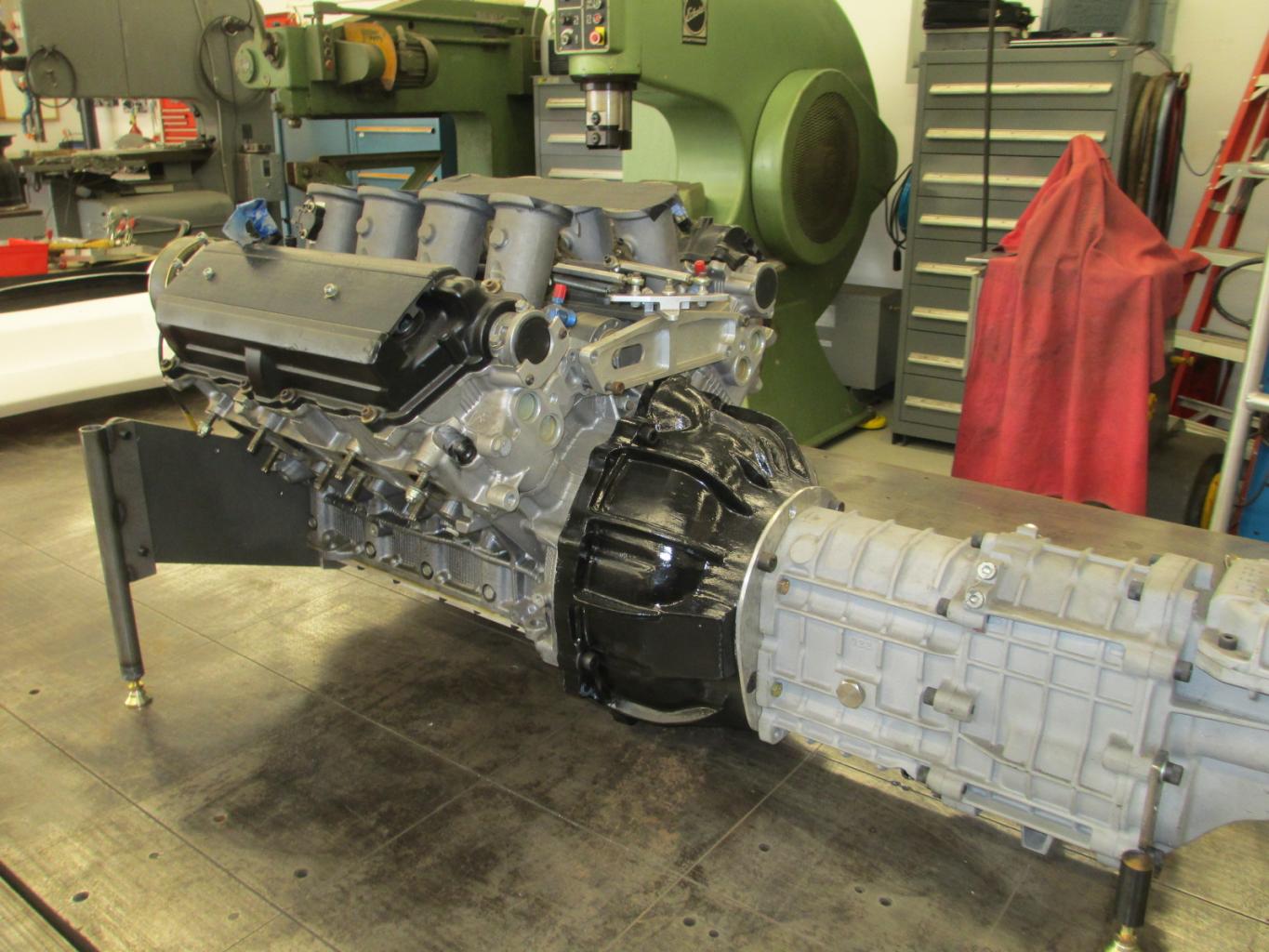

Russell, I know someone that purchased the Ebay 1UZ throttle body set up. They were not too bad but did have the typical "made in China" quality / manufacturing problems. I am assuming that is the OBX ITB set that you are thinking about ? As with much of that stuff you are at the mercy of luck as you could just as well get a perfect part. At the price, it is worth the purchase and the hassle to return if has quality issues. They will never be a Jenvy or other quality ITB.
I have Kinsler injection on my motor and even though they are a quality ITB they required an adapter plate for the 1UZ. That makes the direct bolt on OBX units a neat set up if they don't have build issues. If you want to do a bit more work, look to adapt BMW S54 ITB's. They are a great unit, OEM quality, and reasonably priced used. Attached a pic of the IUZ with the Kinsler ITB's. Trans mount for mock up only, yes that is not strong enough.
