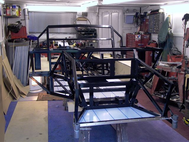

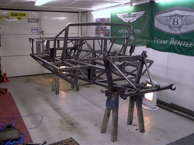

Hi guys Would like to share my build with you all if thats ok, thats if I can add pictures,
Collected chassis off andy jan 2006 and romped away untill june then familly comitments etc took over . Am now back on track, so watch this space.

Many thanks scot , a few more pictures.
regards bryn

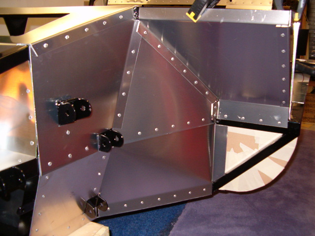

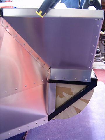

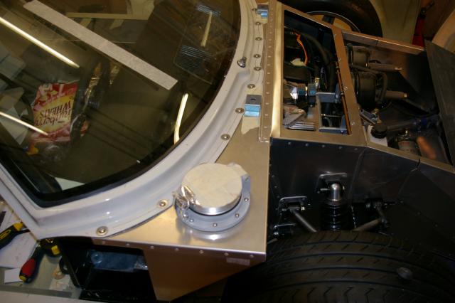

Thanks guys for the replys, Yes chris they are my additions seat mounts and tank mounts.

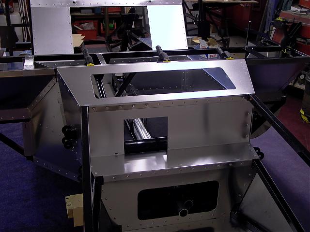

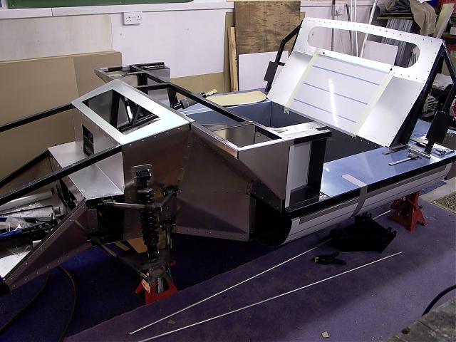

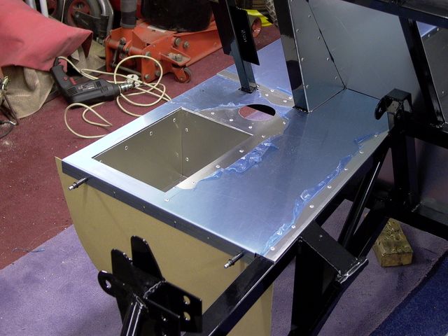

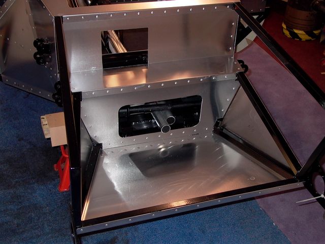

Hi Guys, A quick update a little paneling taking place.

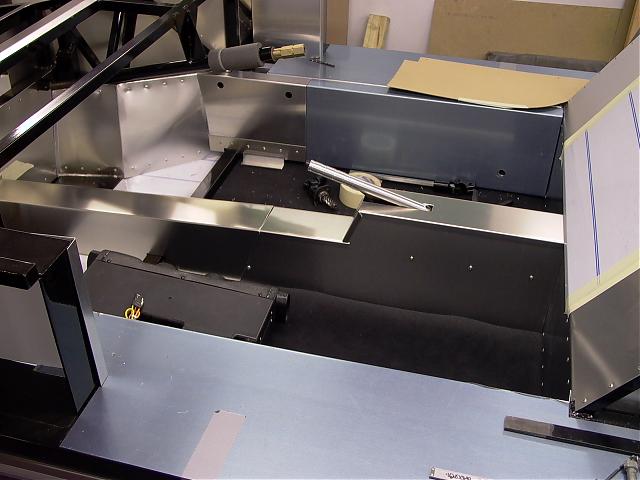

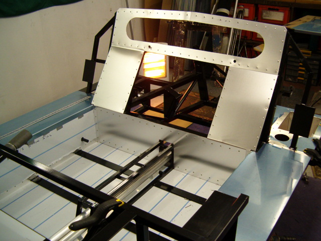

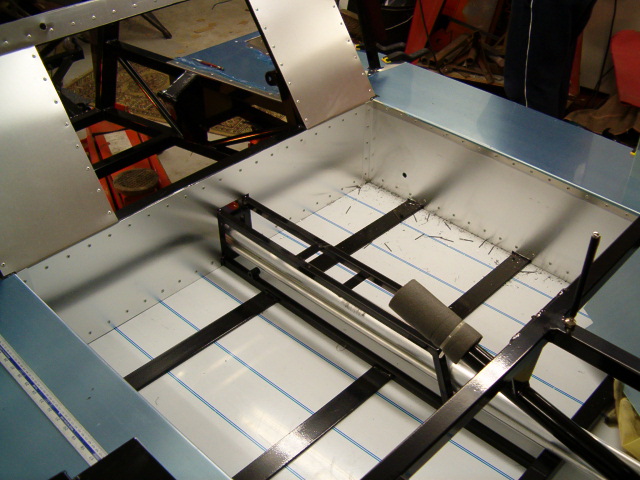

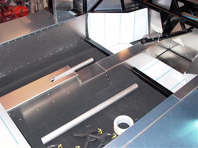

Battery box , hand brake and tunnel.

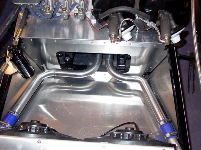

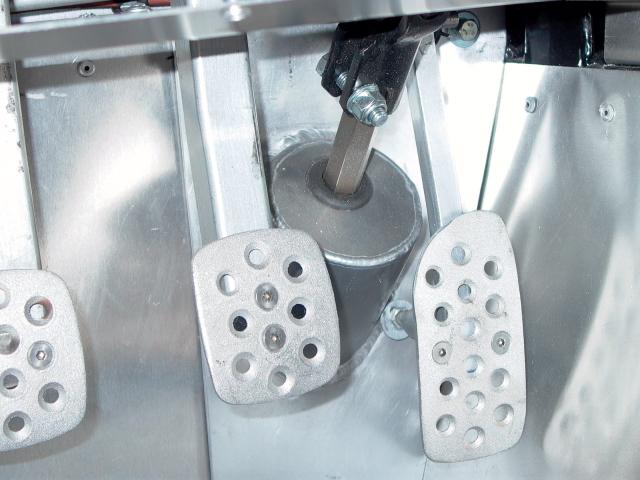

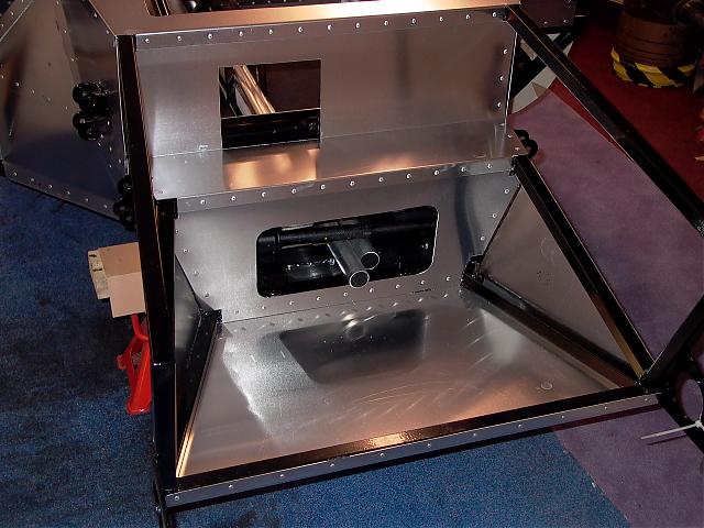

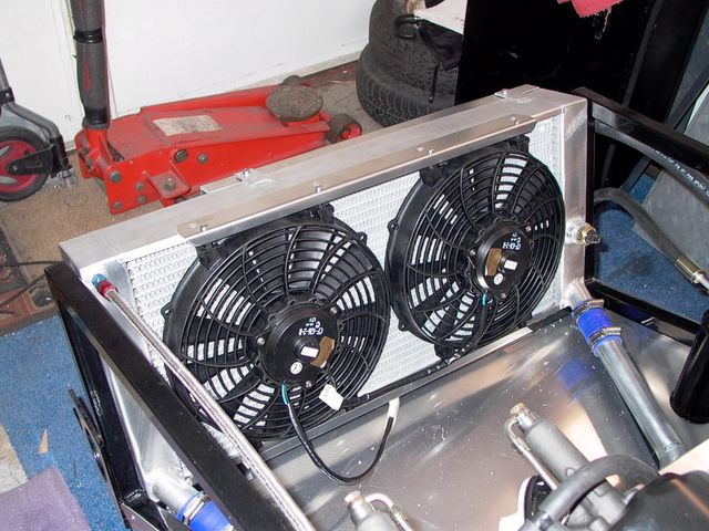

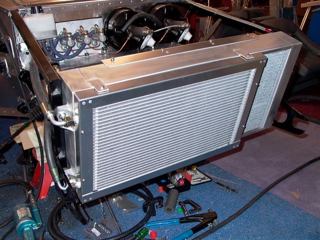

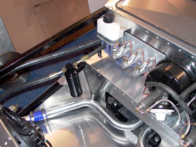

Hi Guys, A quick update on my build,Radiator made and fitted along with aircon rad from vintage air. Pedals made and fitted with twin servos. Whater pipes run through as well.
Hi Bryn
Glad to see excellent progress and workmanship on your build, hope I'm not delaying you too much by ordering yet more ally fabrications for my resto projects.
cheers
John
Impressive work Bryn, especially if you're doing doing all your own alli welding :thumbsup:
How have you managed to get the lower rad pipe to clear the steering rack, more welded in bends?
Regards
Andy
Thanks guys for the replys , its easier working on the 40 than working on a computer for me.
andy whater pipes run side by side under the rack.

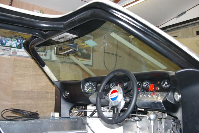

Hi Guys ,
A quick update for you . Thought an extinguisher system a good investment, (just in case) made and fitted a roll cage and the spider fitted, dash is taking shape.
Tanks are made and the drivers side is fitted.
