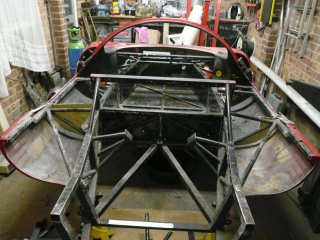

As you can see form the picture, I have reached the stage of my P4 re-build, where I need to fabricate a steel roll cage.
Can anyone here advise me as to the correct spec and thickness of the steel tube that I will require to meet scrutineering for UK motorsport?
Any advice would be greatly appreciated.

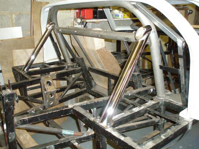

To be MSA complaint mine is made from Dia 50 x 2mm CDS tubing. You can use 45 x 2.5mm, but this is heavier. As Frank says read the 'Blue Book' as how the cage is installed is an importanat as the materials used.
Regards
Andy
