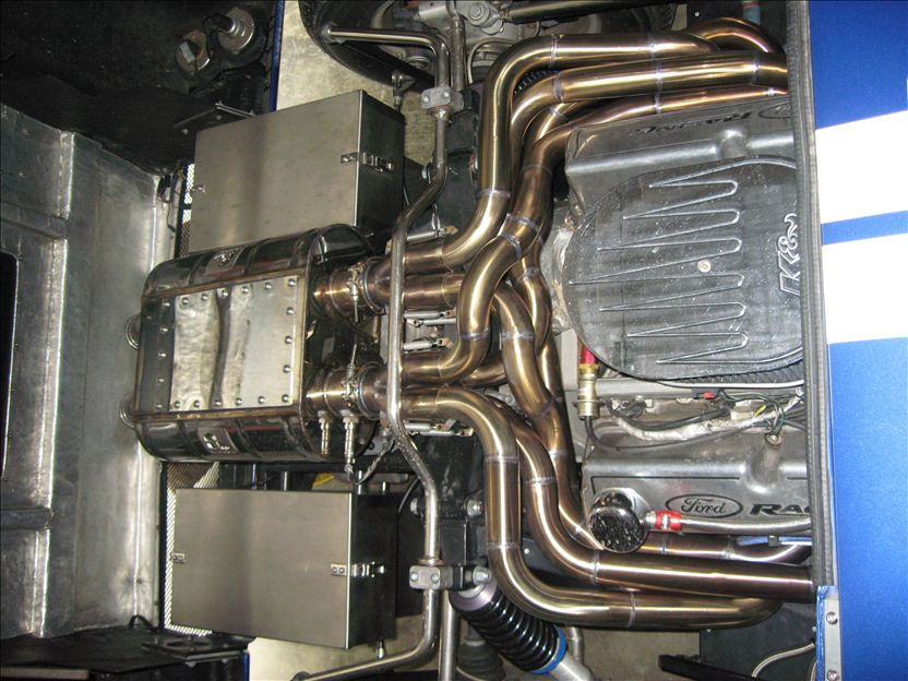

I have been reworking my system that was in stainless with twin silencers, headers were 1 3/4", with inserts it passed SVA but over time became louder repacking helped and was passed just, with inserts for the Octane magazine Goodwood trackday.
The reworked system is in 1 3/4" stainless 1.5 wall thickness, the collectors have rotating pulses and the primary pipes made as close to equal length as possible. The first chamber has been made in an antireversion chamber with perf tube and absorbant packing, this then feeds the through type absorption silencer section. The two through pipes are in one box that is about as large as the previous twin oval silencers together.
This new system has smoothed out the exhaust note and removed a lot of crackels pops and bangs and has come in generaly quieter when running up to 4000+rpm for a sound test. After several track outings the Cadwell Park sound check ( repeated 3 times to be sure) gave reading between 96 98 db. The day was a 105db event as was the previous day at Blyton Park. The level could easily be reduced with inserts that are being made.
Steve

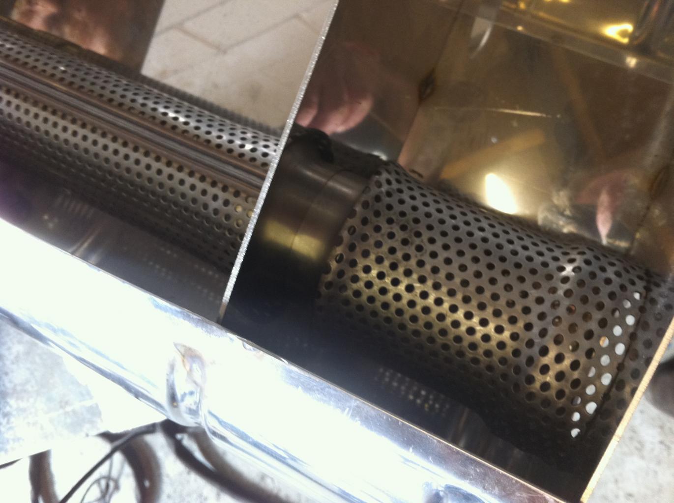

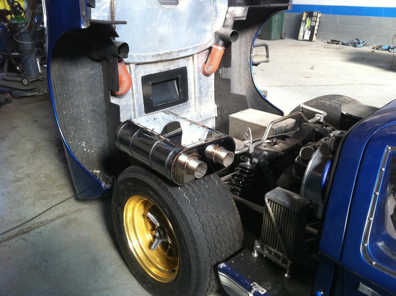

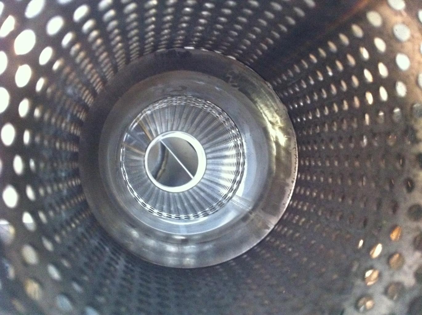

Julian
Here are a couple of pics of the inside of the silencer. The inlet pipe projects about 60mm into the chamber produced by the larger bore perf tube, the reversion pulse is scattered by the cone opposite the entry and the projecting inlet pipe.
The sizes are based on the available space and some info on cars that use the idea; most of the idea features are there. If it workes it was a plus if not it still acts as an absorption silencer anyway.
The chamber is also the first lowered pressure zone and the tailpipe effect starts from here to give the longest 'tailpipe' I could get into the system without doing 2x 180degree bends.
Steve

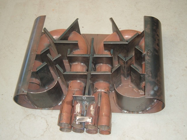

Here is a pic of Russes silencer. I cant remeber what db level he had with it, but he did say it was very quiet
It works on the design, of a collector box, at the end of the secondary pipes, that fool the engine into believing the exhaust gasses have reached the end of the secondary pipe. ie atmospheric pressure...and any baffles after that will have no effect on the performance of the engine, but it will reduce noice level. You can add as many baffles as you want, given the space available, to make your engine as quite as you want
Its a design that has been around for many years, I have never tried it, but in theory it should work......
