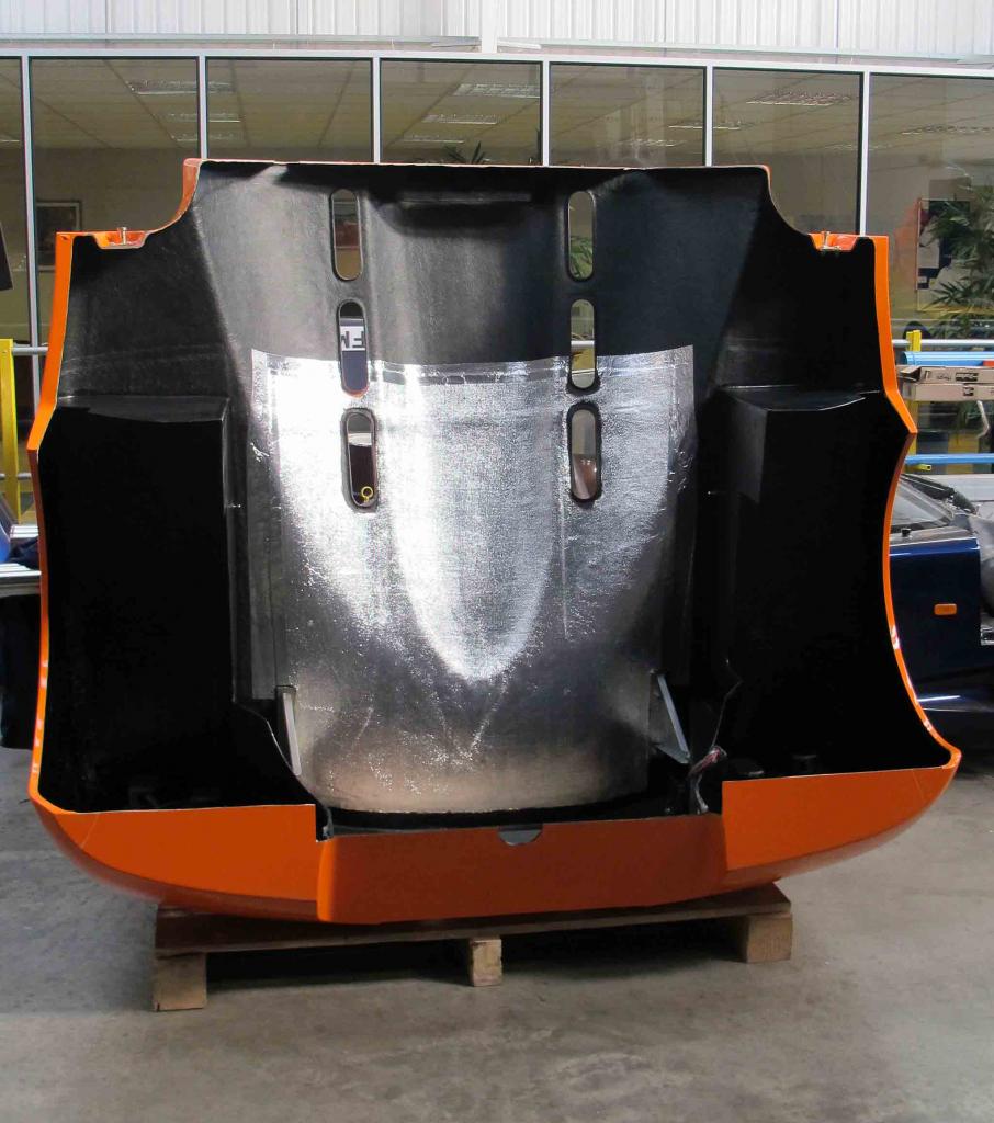

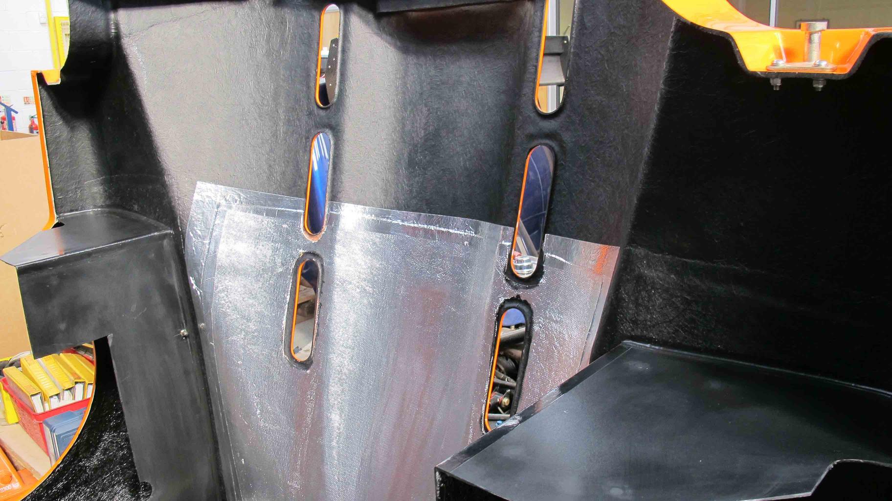

Fitted the rear deck heat protection, just got to put some extra finishing tape on some edges.
Painted the deck with matt black paint and under the wheel arches in body stone chip black, this will stop stone chips from splintering the gel coat.
Just got to fit the rubber grommets for the light pods.
I ran some sikaflex sealer along some inner edges to tidy them up, just being fussy.

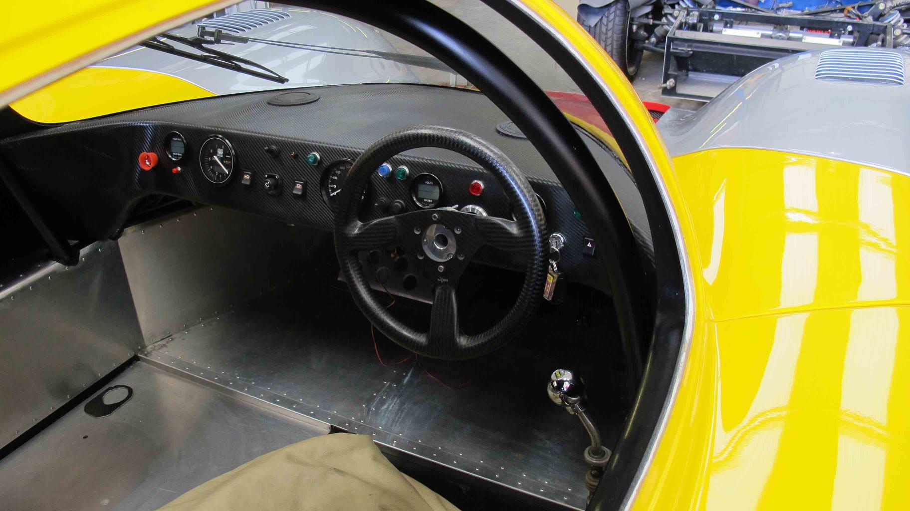

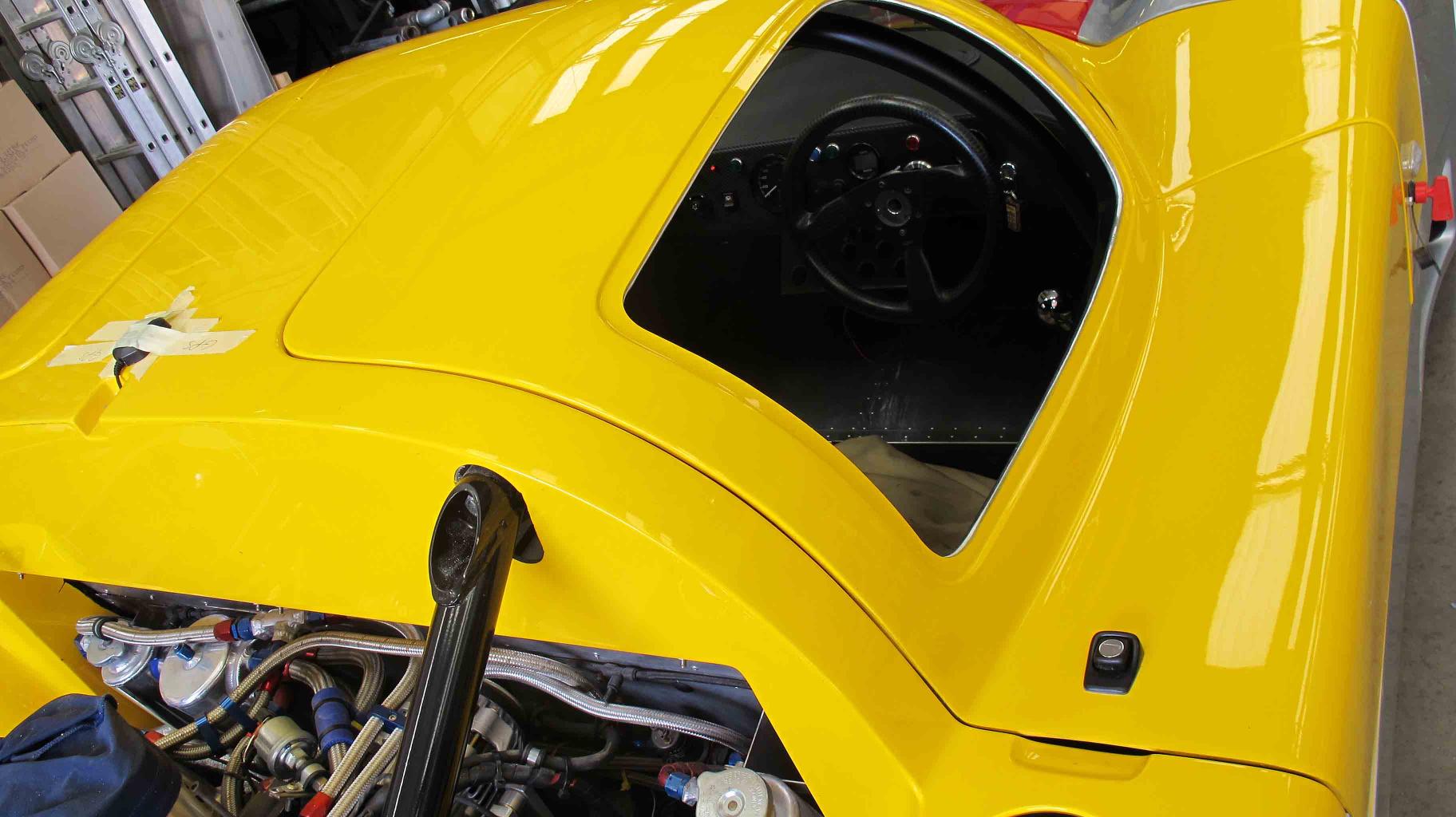

Powered up the dashboard and everything worked exept one gauge which I'll sort out later. Need to repolish the entire ally cockpit area, like a spring clean.
Thatcham Alarm is now working again.

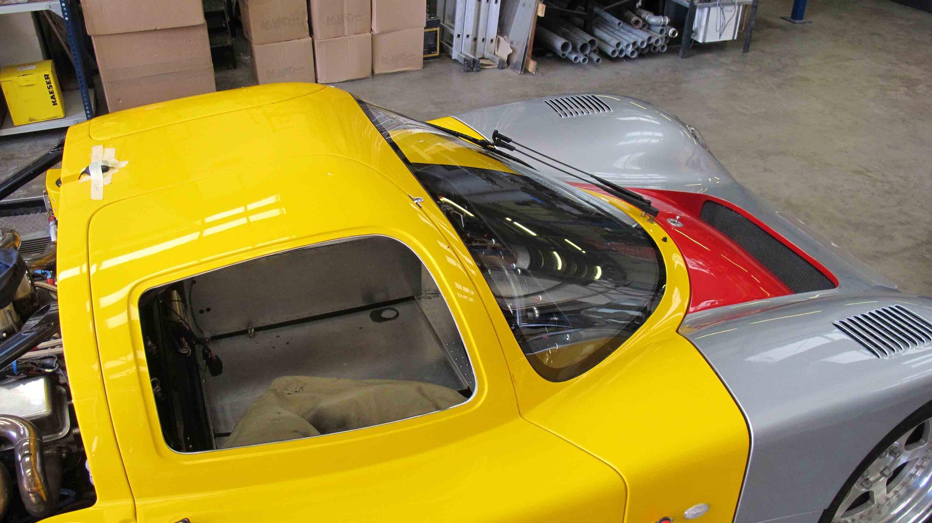

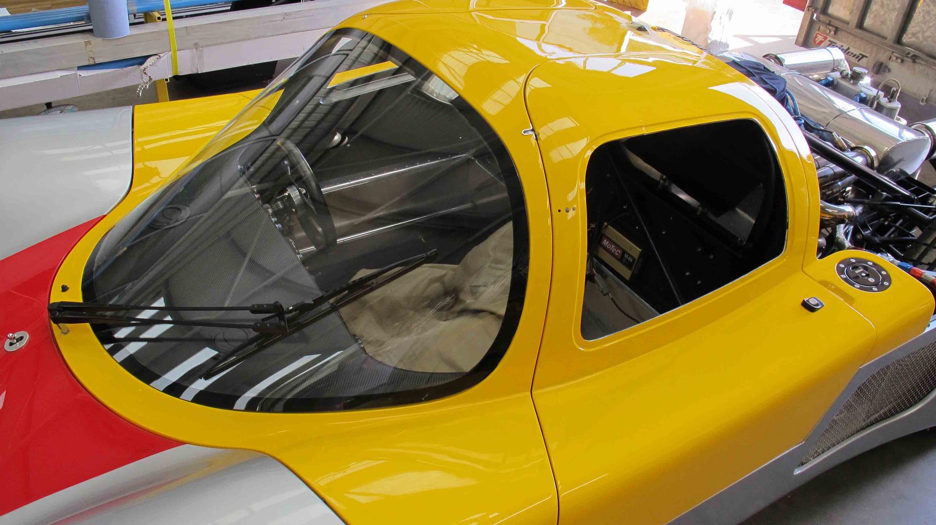

Doors aligned, locks set up 90%
Cabin sealed from the engine bay.
Windscreen bonded in.
Wipers and washers working.

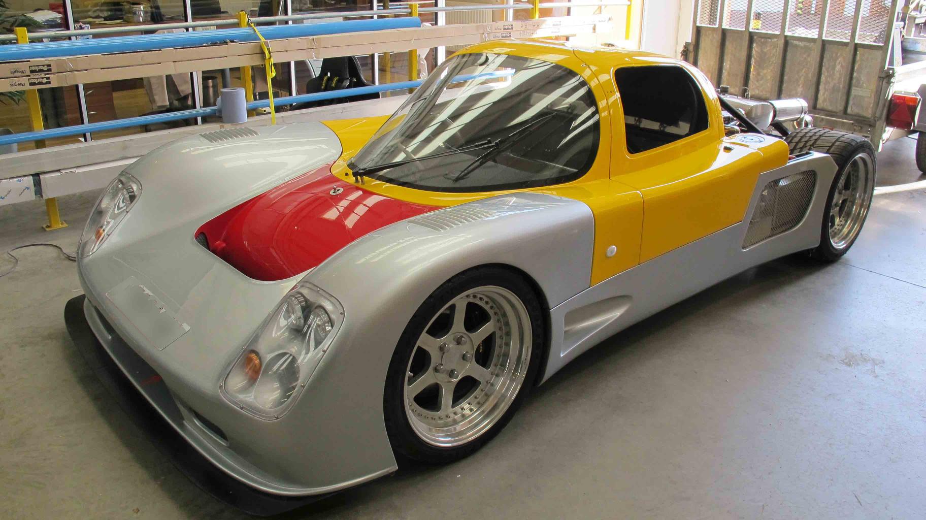

it looks better and better ;-)
what is that little alu lever? in the middle of the front?
is that a lever to open that front from the outside?
It's the security pin just in case the front lifts.
It's a steel pin through the body and a split pin on the outside, same as you would fit on the rear deck of a 40.
There's a lot of downforce with that front splitter and it's a just in case item.
ah :D now I see, good thinking...

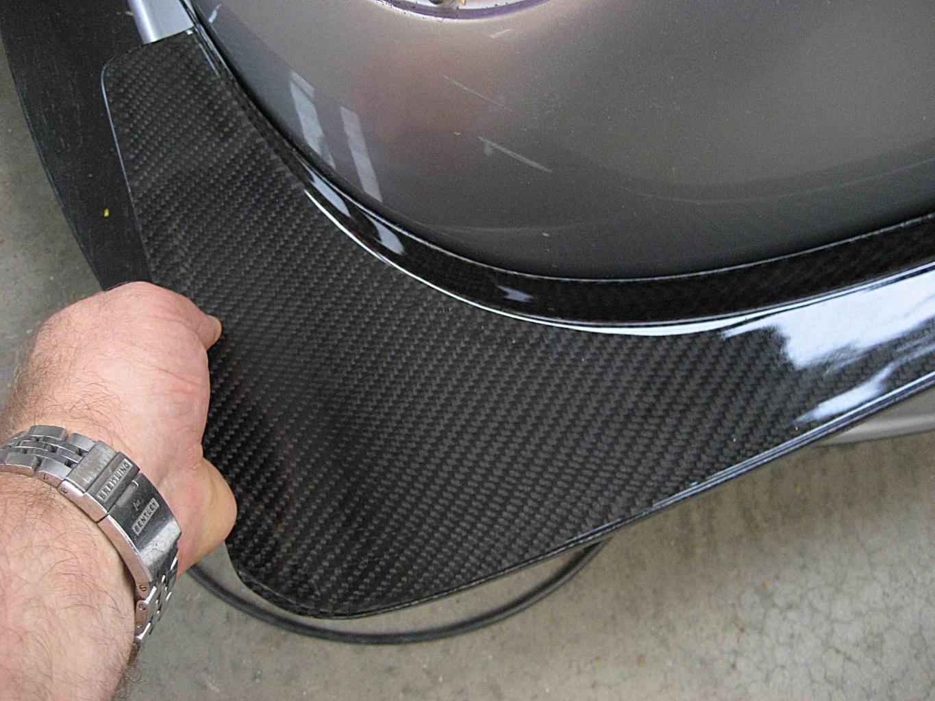

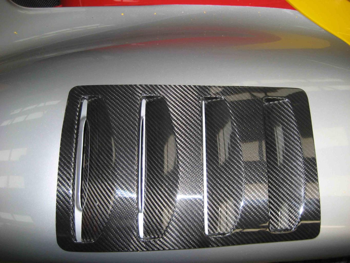

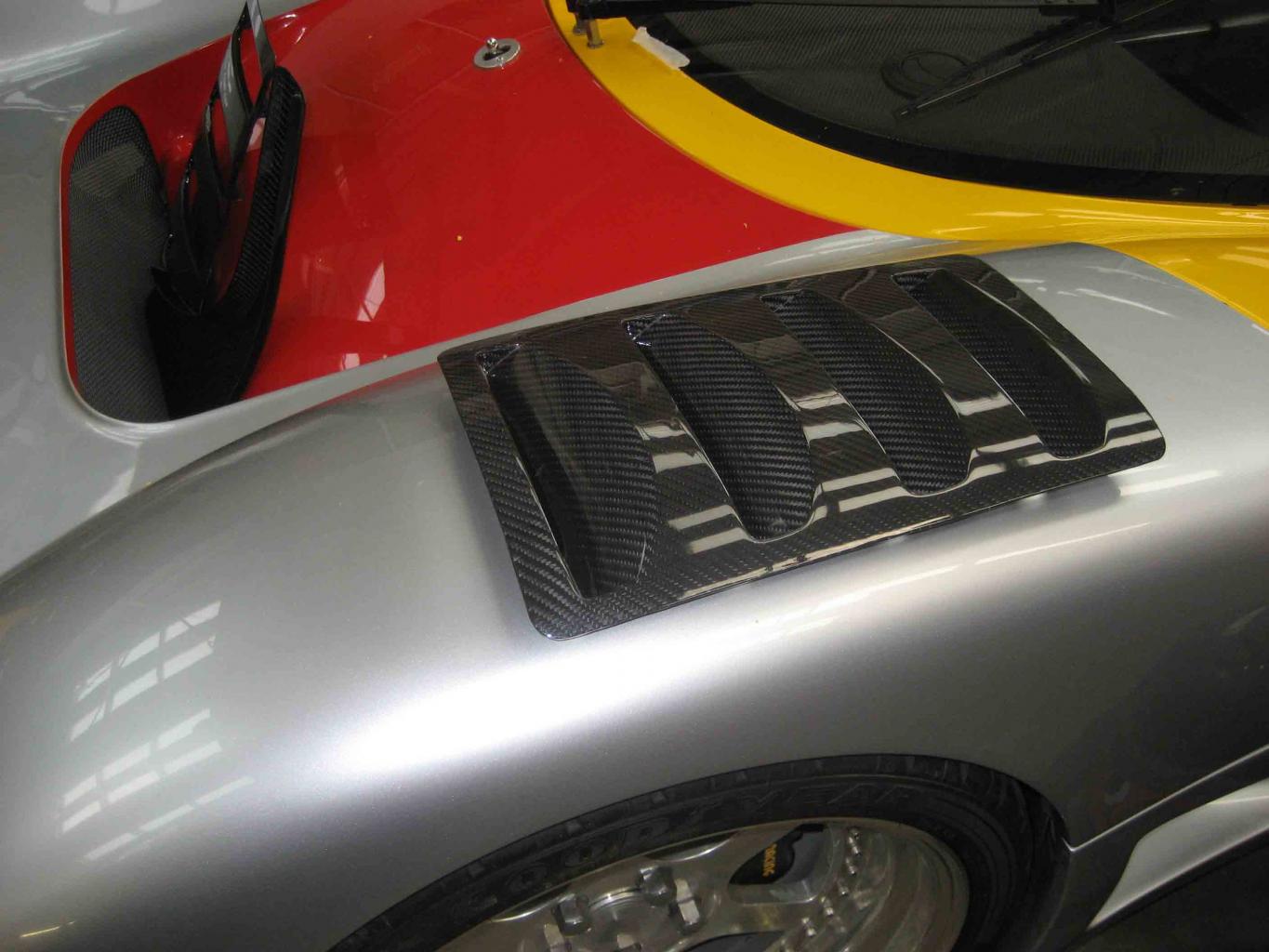

The Carbon bits arrived today...A Bit like Christmas.
The front Shark Gill vents will need a bit of care to fit and look nice.
If you want them flush with the bodywork you have to cut out the aperture then remove the Gel coat of around 1mm so that the vents sit flush with the body.
Harder than it sounds but what the heck lets give it a go.
The Dive planes or Canard wings are a perfect contour on the panels. Will fit them this weekend.
Carbon mirrors are a different thing again but that's for a seperate post
