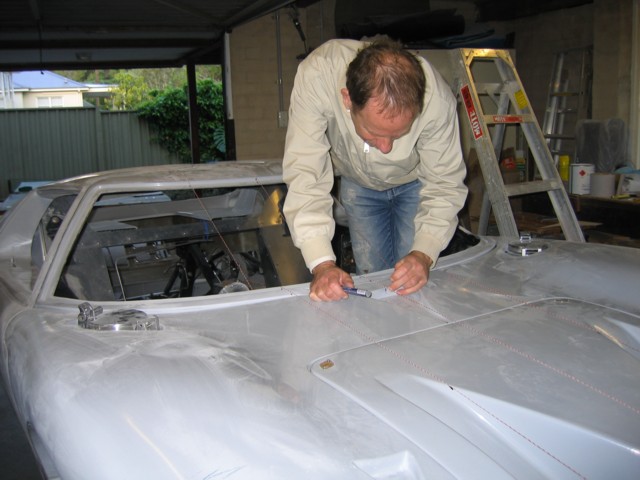

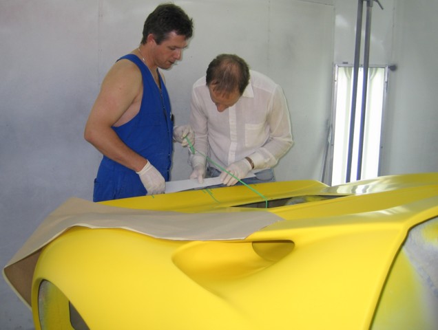

I organised my painted stripes without an additional body fitting. Before sending my body panels to the paint shop I put string over them (while on the car) and marked the centre line by making nicks at each end of the fibreglass panels in the edges which are turned underneath and not normally seem. That was sufficient for the front and rear panels, spider and nostrils but not for the doors. For those I cut out pieces of cardboard (each a bit like a big D) that could be placed on top of each door to show where the edge of the stripe needed to go. I also had another piece of cardboard - a skinny rectangle - that was as long as the total width of the stripes and was used at the paint shop when we taped the edges of where the stripes were going.
It all worked out well although like all stripes you can notice minor imperfections in the alignment if you look hard enough.
