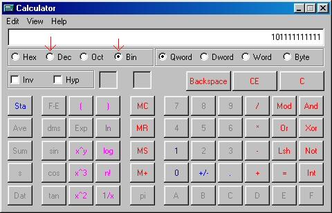

If you can't get the precise number for your VSS, there is another approach which should get you to a good speedo reading in a very few trials. Its called a binary search. Most speedos allow for a wide range of ppm by setting dip switches, which, in essence, set a binary number with 0=off and 1=on, usually The easy way for us base 10 oriented people to work with this is to use the scientific calculator that comes with Windows to translate between decimal and binary numbers.
Note the number of switches that are used to set the speedo. Lets say its 12
Set the calculator to Bin and enter twelve 1s into it. Then set the calc to Dec.
The number turns to the number 4095. Divide by 2 (2047.5).
Then click Bin again and you see that 2047 = 011111111111 Bin
This is your starting point, so set your switches like this.
Check your speed and consult your speedo docs for adjusting slower or faster.
Lets say you need to go up numerically with your switch. Set Calc to Dec
((4095-2047)/2)+2047 = 3071 Do this on calc then set to Bin, and you get 101111111111
Set your switches like this and try again.
Set switches again, going ½ way to previous or next mid point (depending on the direction you need to go)
Repeat until you get an accurate reading. You'll be amazed at how fast you get there.
