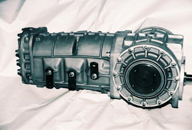

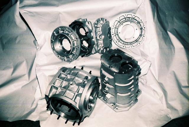

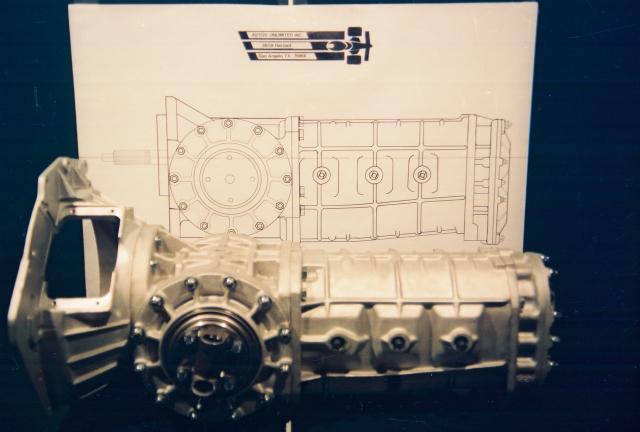

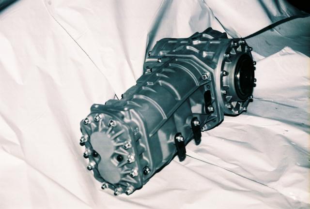

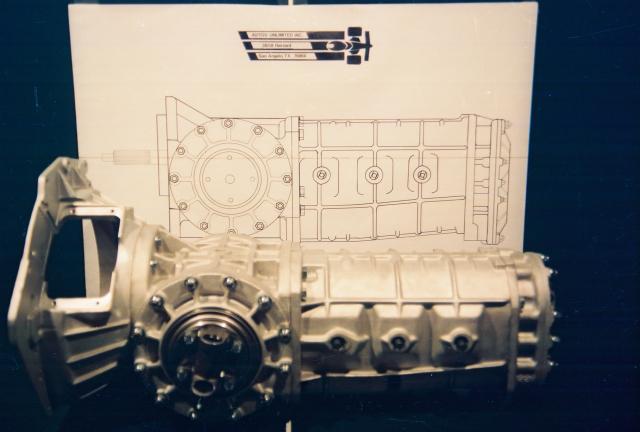

Here is what my ALL AMERICAN transaxle looks like..
To build one with off the shelf parts requires you, at some point, to make something custom.. and after a while you find it just as EZ to make anything you need...
What the Mind can conceive, you can achieve..
