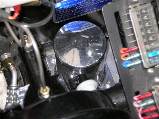

Detail of brake boost installation.

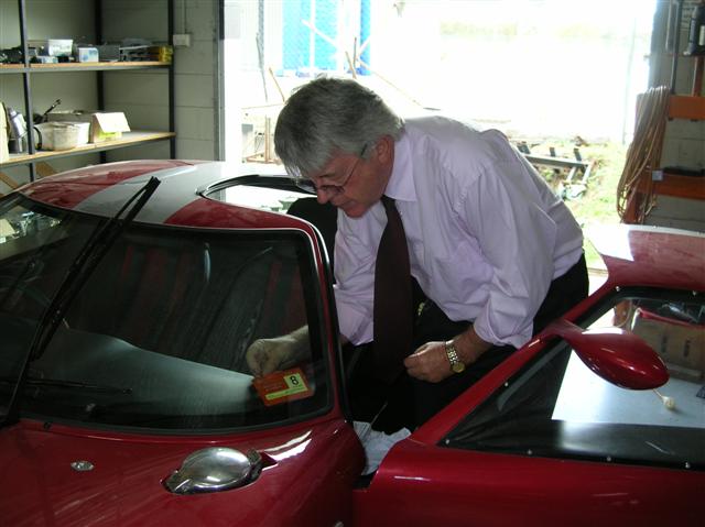

Very happy owner applying rego sticker. A very memorable and auspicious occasion. When I built my first kit car, (a Bollwell) the design rules came into force in the middle of the build and I had no hope of compliance. I ended up selling it as a race car for the cost of the parts. No return on two years of sweat.

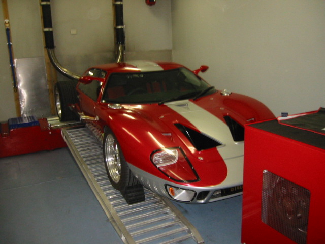

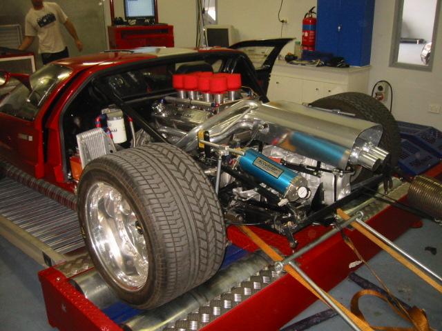

Hooked up to the Dyno. /ubbthreads/images/graemlins/laugh.gif

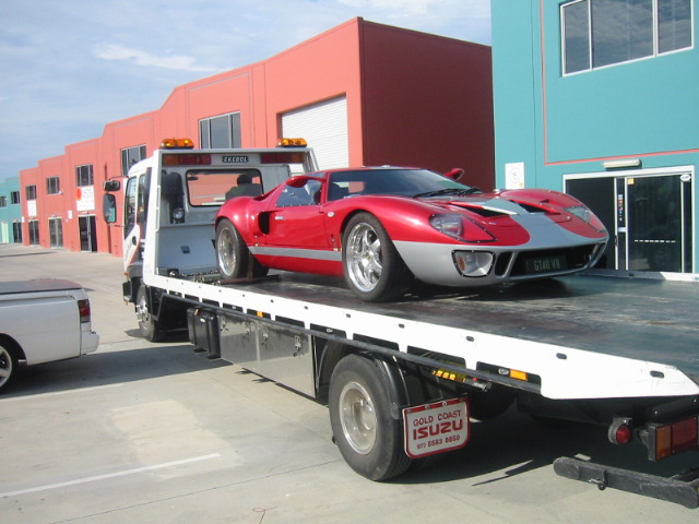

Hooked up to the tow truck /ubbthreads/images/graemlins/frown.gif

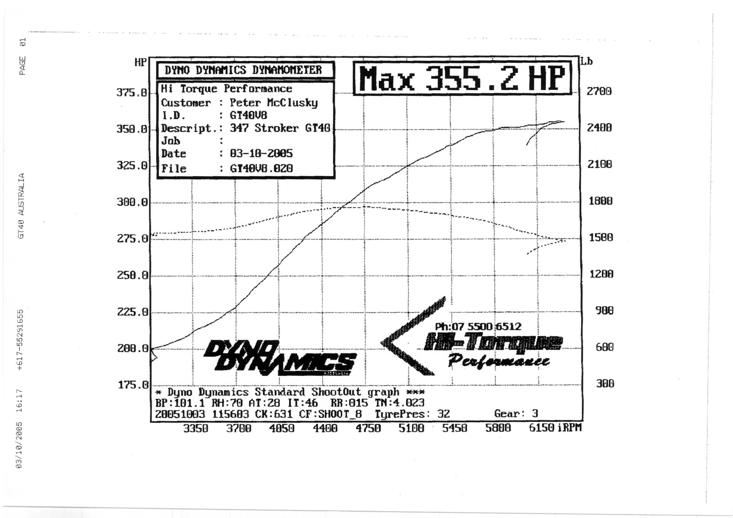

We restricted the revs to 6000 because of the newness of the engine. Rear wheel HP 355.2. I'm happy with that.

Pete, 355 RWHp & you are just "happy with that" ! What on earth would make you ecstatic ?? On reflection, perhaps its best you don't answer that !!
That is some grunt you have there, so all that puckering up for the first drive will pay off - you will go nuts !!
Only around 1000 of your fellow Forum members are eagerly awaiting your first driving impressions (& I bet Di is just about ready to call in the decorators to remove any evidence of you "climbing the walls" for the last few months) !!
