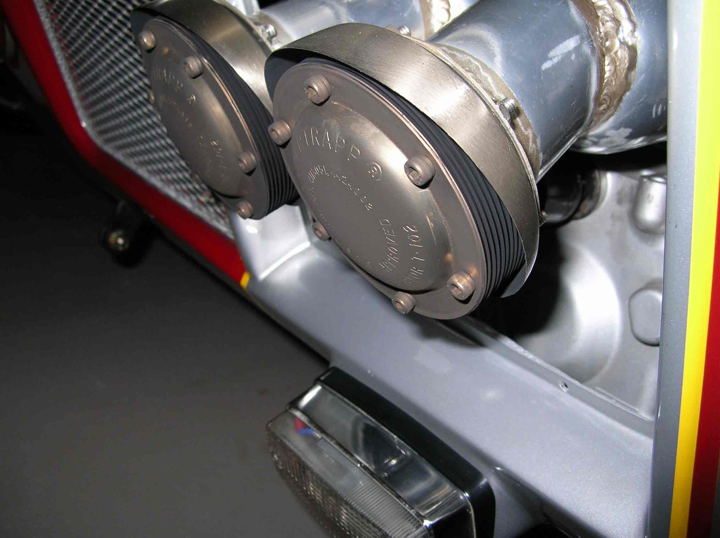

After a couple of weeks of very pleasant but unmistakable comments by neighbors, like "heard you go to work yesterday"and being followed by the local police and getting very sick of short shifting, I decided that I should do something about taming the incredible goose bump raising sound of #48. P.R. recommended fitting Super Traps.
See Pics. The Super trap fits on the end of the exhaust pipe
and has a variable number of baffles or traps bolted on behind the end plate. The more traps in place the louder the music and the less back pressure. To quieten things down just remove some of the traps. So you have instant exhaust tuning capability. For track days just take off all the traps and you are back to the original exhaust set up.
The manufacturer claims that horse power is actually increased by fitting super traps. When we have done enough miles to put the engine back on the Dyno we will have a fiddle and discover what is the best setup for both H.P. and
torque.
How do they sound? Well gone is the ferocious BRAAAAAATTT,
replaced now with a more sophisticated VROOOOM.All life is a compromise. /ubbthreads/images/graemlins/smile.gif
How do they look? Frankly, compared to the end pipes I have been used to, I think they look crap. /ubbthreads/images/graemlins/frown.gif But some people have commented on how cool they look. Anyway I think if I was trying to win a show and shine I would take them off.
Do they do the job? So far, an emphatic yes, I am no longer worried about the neighbors or the Police. The Dyno will tell the story. I'll let you know.

Here is a pic of the Super Traps.

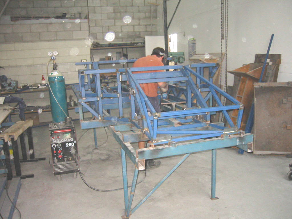

The start.

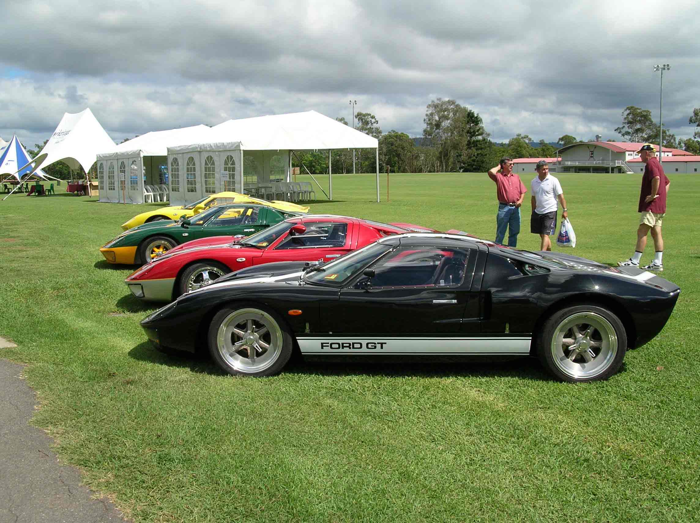

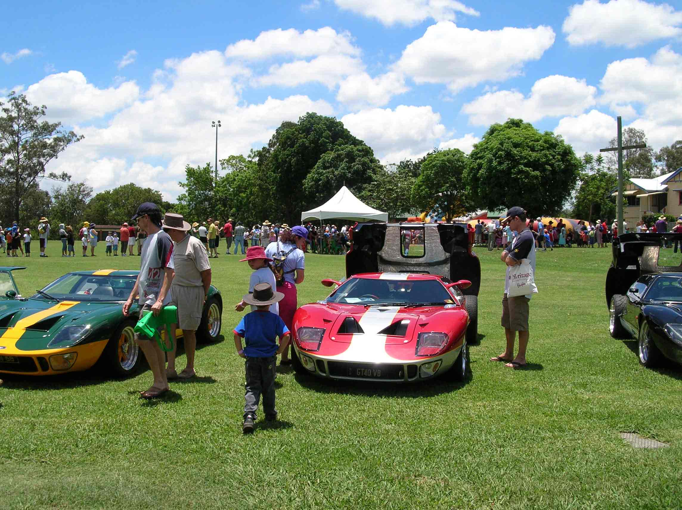

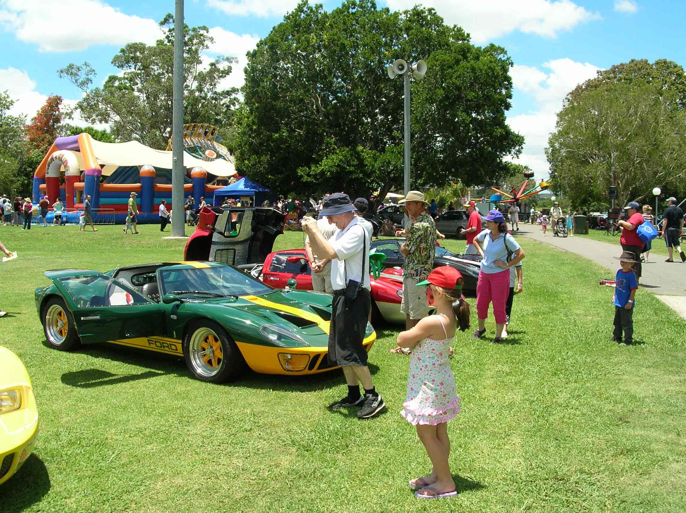

On Saturday DRB #48 had its first outing to a display.
We were asked to bring our cars to a Christmas party for underprivileged kids. Four cars turned up, three R.F's. and my DRB.The day went very well with the cars creating a huge amount of interest.So much so that I will spend the next week cleaning little kids sticky paw marks off the paint. /ubbthreads/images/graemlins/banghead.gif
Mick, who owns the black R.F. and I were interviewed by the course announcer who asked us a bit about the history of the GT40. Needless to say Ferrari copped a flogging /ubbthreads/images/graemlins/grin.gif
They must have thought it went o.k. because they replayed it about four times during the day. Mick reckons that Hollywood will now be chasing him. /ubbthreads/images/graemlins/laugh.gif
It was very hot and humid, but fortunately we found the beer tent. /ubbthreads/images/graemlins/beerchug.gif Micks car is the black and silver, #48 you know, Bruce owns the British racing green car with the gold stripe and Wayne owns the yellow car.

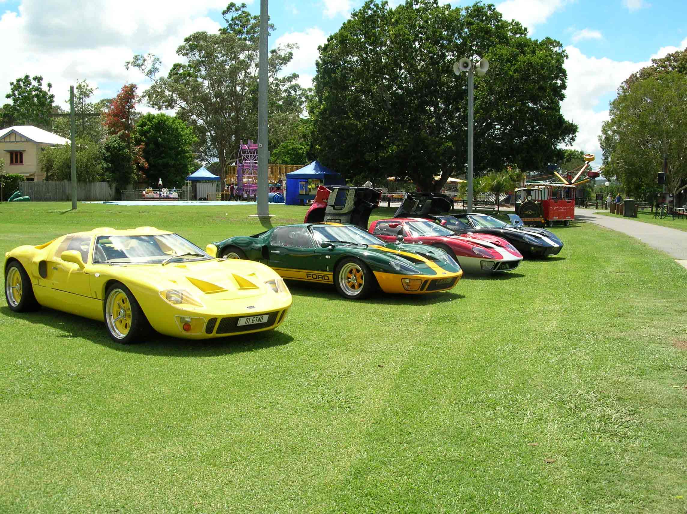

And we found the beer tent. /ubbthreads/images/graemlins/banana.gif /ubbthreads/images/graemlins/beerchug.gif.
From the left,Wayne,Mick, yours truly and Bruce.

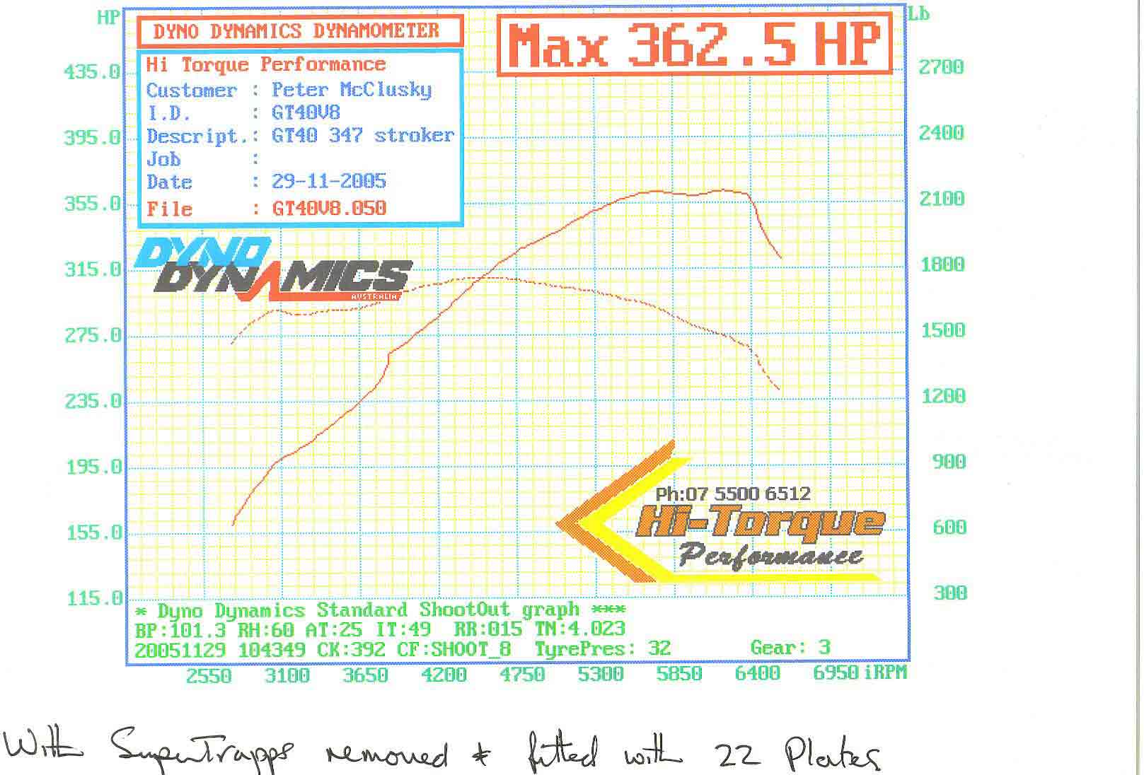

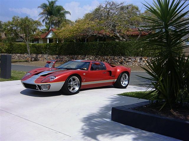

After 2500 KLM's of running in we went back to the Dyno and found a few more H.P. We now have 362.5 H.P. at the rear wheels and a healthy torque curve peaking at just under 1800 ftlbs. /ubbthreads/images/graemlins/beerchug.gif We will have another look at about 5000 KlM's.
