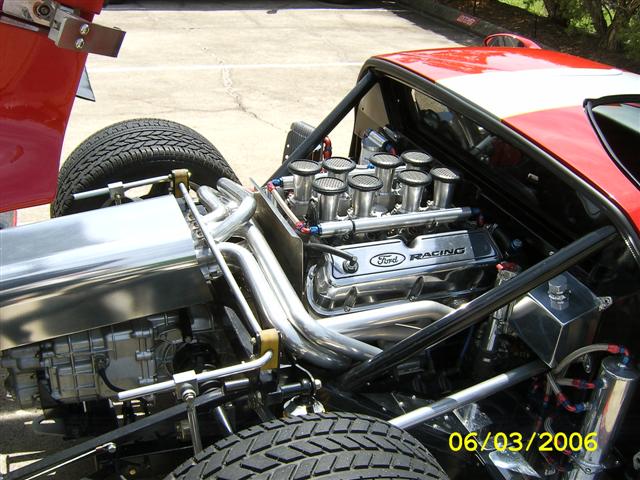

Flatchat, my humble apologies /ubbthreads/images/graemlins/blush.gif I followed my own advice, had a look at the previous pages and found that I have been fairly reticent about the "go Fast" bits and the creature comforts...So lets start with the engine.
A Ford "Sportsman" block. Trick Flow Twisted Wedge cylinder heads."H" beam 4340 conrods. SRP forged pistons. 4340 347 stroker crankshaft, Plasma Moly rings. Heavy duty oil pump drive shaft. Hi volume oil pump. Crower performance hydraulic lifters. Comp Cams billet camshaft custom roller type.Yella Terra roller rocker kit. Moly pushrods. Steel race type harmonic balancer.D.C.&O. E.F.I. Autronic computer. All put together, balanced and blueprinted by Precision Engine rebuilders at Southport on the Gold Coast. Approx 500 FWHP. Thank you Graham.

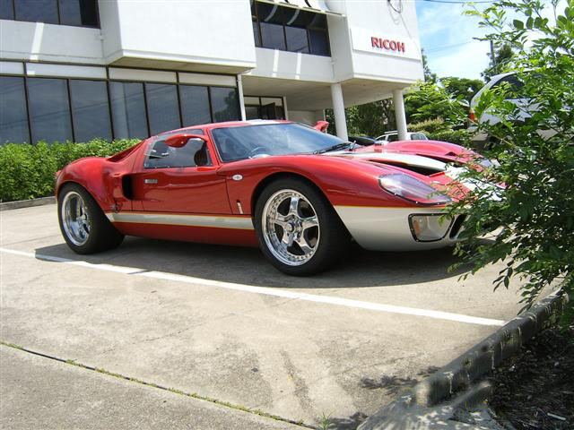

Creature comforts, include air conditioning, (a must in tropical Queensland), sound proofing, thermal proofing, tailored carpet, leather upholstery, race seats individually fitted, and set up with adjustable posture assist. Seat cushions easily changed to accommodate different drivers. Leather steering wheel(soon to be removable).Cruise control,(the only way to stay at the speed limit.) Am/Fm radio MP3 and Cd player. Reverse warning sensors. Electric mirrors, and of course full instrumentation. I think that's it Flatchat. /ubbthreads/images/graemlins/beerchug.gif

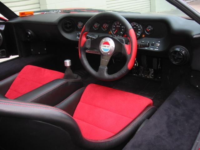

Well I have covered about 4,800 kilometers to date without a hiccup (touch-wood) other than a blown fuse. The car is a delight to drive and handles peak hour traffic with no sign of overheating in 40 degree heat.(Celsius) that's 104F for you blokes in the U.S. The car has bags of torque and will accelerate strongly from as low as 1000 revs in 4th gear. No I don't drive it like that, I just tried it once to see what would happen.
In 5th gear at our stupid highway speed limit of 100 kph /ubbthreads/images/graemlins/banghead.gif the engine is doing only 2100 RPM. The ride is firm but much more comfortable than I expected and Peter's well designed seats are great, I might order a couple for the lounge room. /ubbthreads/images/graemlins/grin.gif
I am going to fit a removable steering wheel to make entry/exit easier for my ageing frame and the bigger brake option that DRB have available.
I really enjoy the reaction I get from people wherever I go
from school kids giving me the thumbs up, people taking photos on their mobile phones, and ladies of all ages waving as you drive past. /ubbthreads/images/graemlins/blush.gif Definitely not the car for shy retiring types.
Once past the 5000klm mark its of to the Dyno again and then we will look for our first track day. /ubbthreads/images/graemlins/banana.gif
