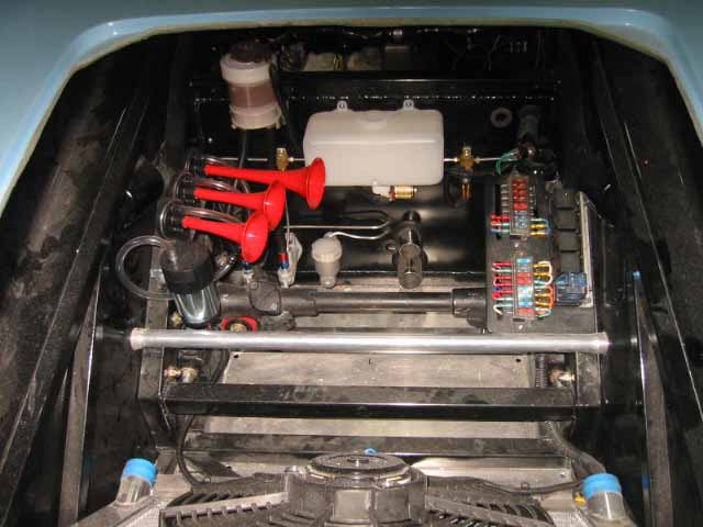

Re: GT40 Australia #48
Does a red horn make you go faster? /ubbthreads/images/graemlins/grin.gif

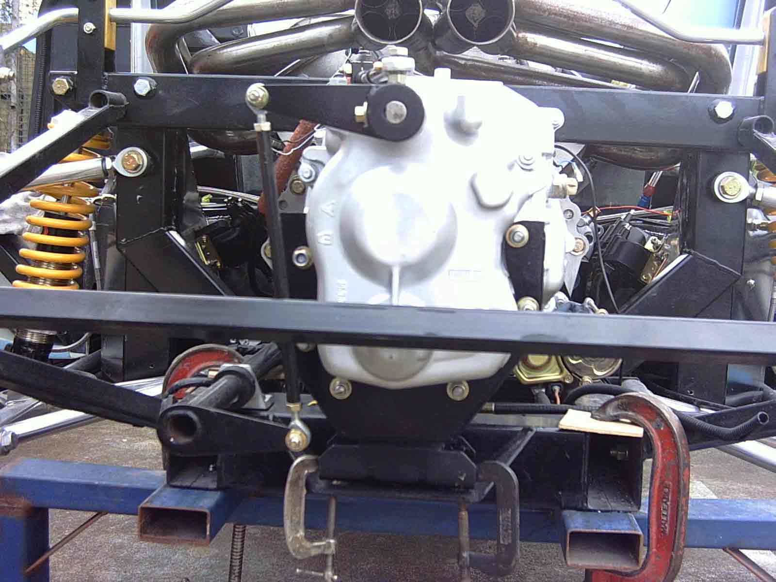

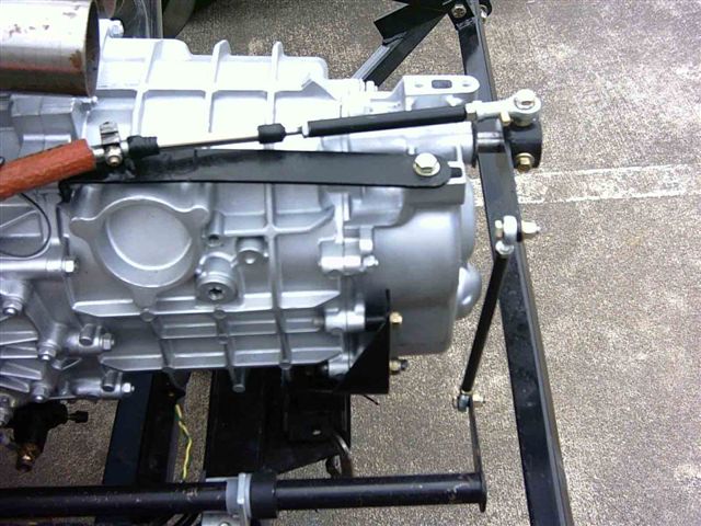

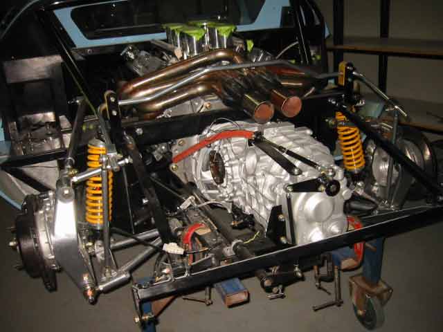

Pipes fit, don't worry about the look, they will come off
for beauty treatment.

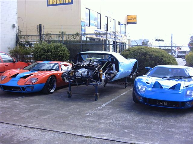

Having a serious chat with Peter Ransom about how to lower
my car and get wider wheels. (See next pic)
Pete McCluskey.
next pic..needs lowering /ubbthreads/images/graemlins/grin.gif
Peter Delaney
Hi Pete - you're right, it could do with dropping an inch or 2 & wider wheels ! Backing off the damper settings might also help a bit !
In the gearbox pics, I trust that the red covering on the shift cable is some sort of heat shield material - I found out the hard way about not doing that (melted about a foot of the cable sheath). The CAT's I had to use were fairly large, & that meant that hot things got a bit too close to the cable.
I ended up running a sheet of semi-flexible heat shield over the top of the gearbox, & running the new shift cable horizontally along the side of the box, below the heat shield. The end of the cable fixes to a bracket on the outer end of the gearbox shaft rotation lever, & the lever is braced across the top to stop any fore & aft springiness.
So far so good - the feel of the shift is nice & positive, & there are no more puddles of melted plastic on the floor !!
Your car seems to be leaping ahead quickly - any idea on a completion date as yet ?
Kind Regards,
Peter D.
Pete McCluskey.
Peter, that covering on the cable is heat resistant, P.R. has the same stuff on his car and he has clocked up quite a few clicks on his car now with no drama.Don't ask me what it is made of I have no idea.
Hope to have the beast finished before Christmas, but there is still heaps to do. Paint & preparation, seats made and fitted, carpets and upholstery, Dashboard and instruments.fire up the engine and tune. And the toughest and most time consuming, getting it registered /ubbthreads/images/graemlins/crazy.gif

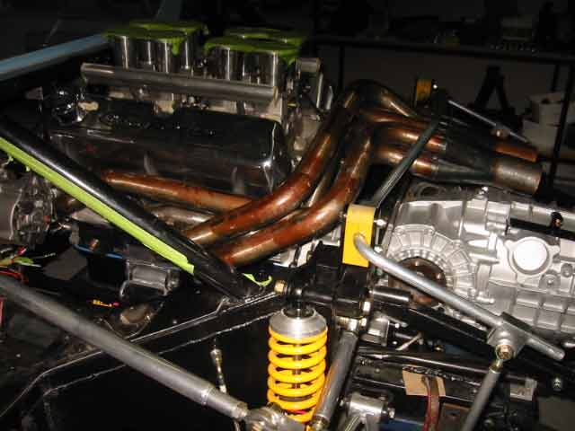

A coil for each cylinder!! /ubbthreads/images/graemlins/wink.gif
