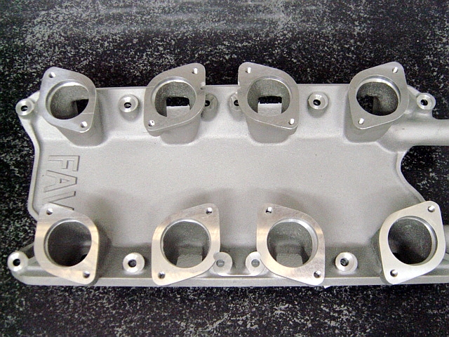

I have seen Webers with both the Cobra style manifold (with dual water tubes) pardon me if my terminology is off. And those with the standard single water inlet. Would either work on a small block in a GT40? Seems the dual water inlet with the external Cobra Y would not fit.
Which manifold should I be looking at when considering Webers?
Thanks in advance.

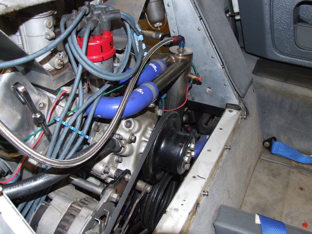

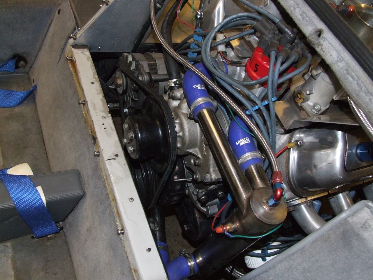

Thanks guys, it appears that neither of you are using the type of manifold I am looking at, the Cobra dual water inlet, but the single as in your photos. I will keep looking for weber set up unless someone shows me they are using the original Cobra type.
Another way !!

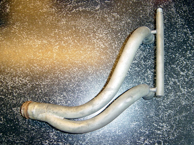

Michael,
I have both the Cobra and the Ford E & F manifold with the original dual water outlets. The original GT40 "Y" manifold is unique itself and is unlike the the one used in the 289 Cobra and or the reversed "Y" pipe used in the GT350. The original GT40 version came out and immediately turned down heading down the front left side of the engine. I'll look for a photo of a GT40 "Y" pipe. I believe Jay Cushman has reproduced them.
You can see photos of them in the SAAC forum in my photo gallery there under SFM5S000
Cheers,
~Earl J
Michael, I had the duel inlet on my set up which came off the drivers side. This did not work on my car since I needed it to come off to the passenger side. I just made a new one with some aluminum pipe. You can go to my build log and see it. Go to the build forum and go back to JIMS ERA build with the last entry on 11-28-10. The photo of the manifold is on my post of 11-24-10. Hope this helps. Jim
