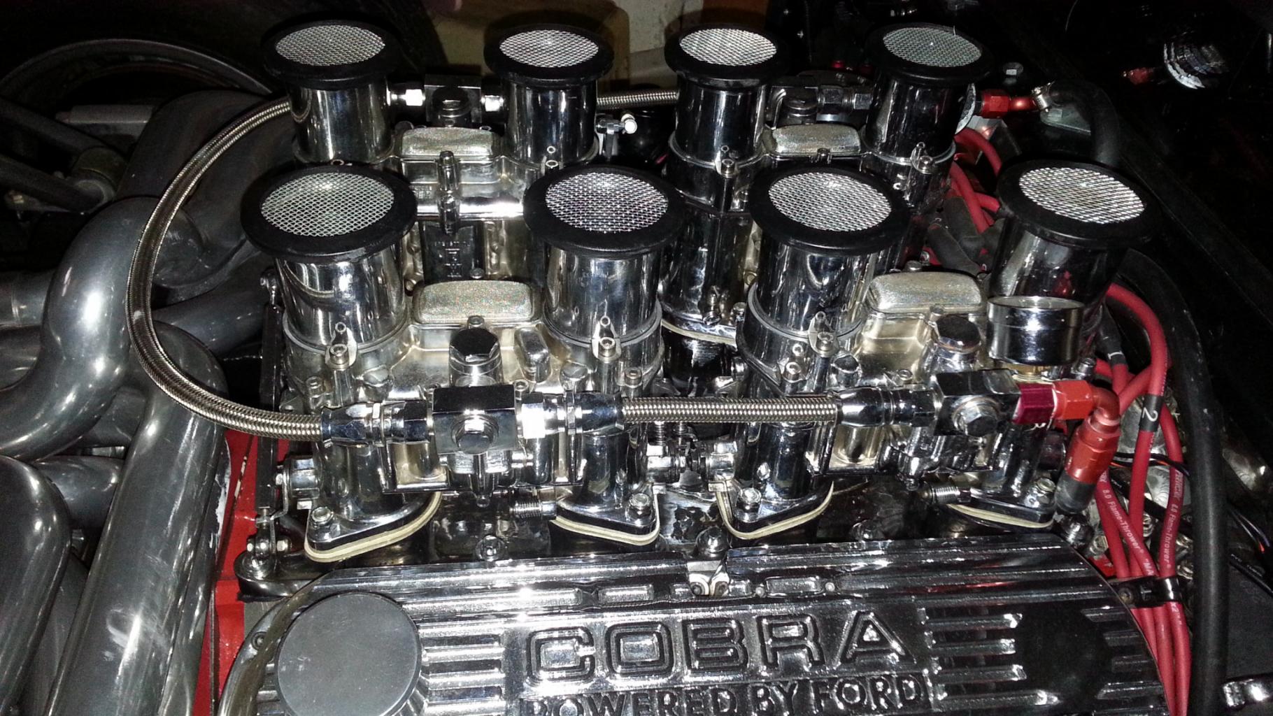

Not a large block, but on a 331 CI, I have a set of 48 IDAs. At idle, a little rough (the cam) but they run best under WOT. They do have that look. See attachment. Fortunately, I have access to a Ferrari mechanic that knows them inside out.

Looks nice Grady. Does it boil the fuel being near the header? What are all your thoughts on running unfiltered air? I love the looks but if I had to cover them up with air filters then what is the point I thought?

Only has about 450 miles on the car...I've looked into filters. I liked the domed fine mesh, but the paper is probably the best way to go. I'll let the new owner (whoever that maybe) decide that. The Weber's do have a unique sound when you hear them on the road going by. There is much chrome on the engine when you look at the plated intake.
Since this picture was made I had Dennis add a high temp insulated sleeve over the loop around the rear of the carbs. No problems with fuel overheating. I saw the same problem potential you did and fixed it. I'm lucky to have Dennis near. I ask him to go through the car...every nut and bolt and had everything done or looked at. My touch started with a $10 K repaint to Guardsman Blue. Time to make some pictures and sell it. An NO, you don't need more that I've got. I love my Viking Blue MkII. Probably the best in the country per the people in California and Dennis. It had years in the tweaking and improving to be what it is now. Toot toot.
