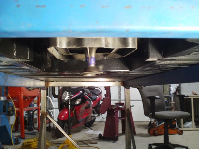

Here is what I'm up against regarding the oil pan. I'll be modifying the pan to be a rectangle shape in order to make up the capacity lost in the original sump. I should end up about 1/2 above the bottom of the chassis and with about a 9 quart capacity. The pick is going to be fun to alter.

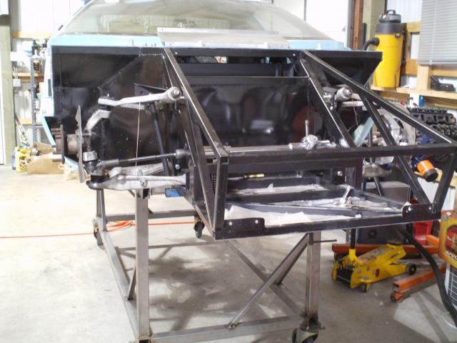

Just pokin along. I installed the halfshafts and the steering rack. Setting the rack was a PIA. But thanks to yooz guys i was able to find what I needed. Sometimes it's easier to just hunker down in the shop and watch a movie with a beer instead of working. Does that happen to anyone else?

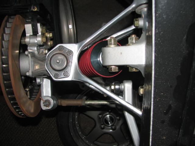

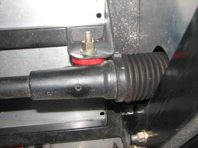

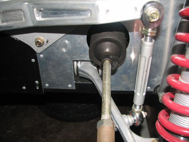

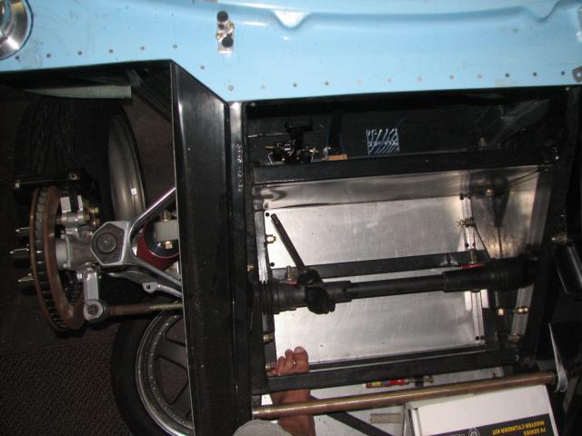

Hi Pete
I looked into the dimentions you asked about. Not sure how to put a photo into a PM yet. Need to spend some more time here.
Looking straight down on the steering rack its a straight line through the tie-rod end right through the rack center line to the opposite tie rod end.
From the DRB rack mount forward to the center line of the rack is 1 1/4"
1.256" to be exact.
Looking from the side of the car the lower A-arm has two mounting points on the chassis, From the back face of the front mount it is 7/16" back to the center line of the rack as in the last photo. I hope this helps and has answered you question.

Having previously built a Lotus 7 replica, whilst knowing bugger all about suspension layouts (hey, it looked good), I discovered the wonders of bump steer. The car would change lanes when you changed gear!.
With the 40, I mounted the rack on a couple of 'ramps', allowing me to move the rack to establish the ideal, no bump steer, position.
Astonished to find that the sweet spot had to be accurate to the millimetre. Move up or down the ramp 1 MILLIMETRE and bump steer intruded.
Accurate to the point where the outer end of a 1 metre bar bolted to the hub did not move forward or backward (well, not visible) over the full travel of the front suspension.
Using the same measuring technique, I have the rear introducing toe in in bump - but not too sure I have enough. Probably 1/2 inch at the end of the metre bar. Would appreciate comments.

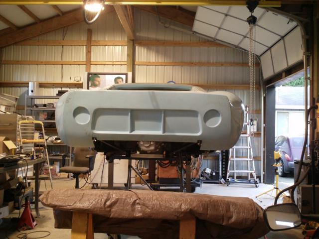

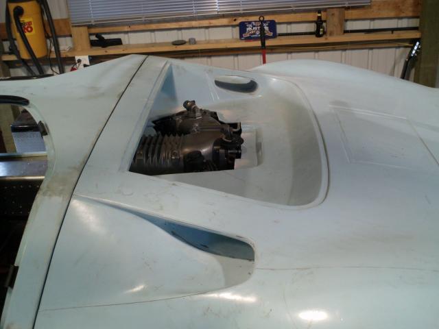

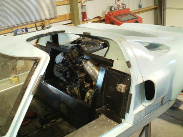

Sometimes it's good to see what all the fuss is about....I needed to make clearance around the blower anyway. I'll clean up the opening later.
Now I see what you mean about tight :stunned: Good to see you progresing though.

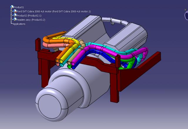

So after goofing around with a bunch of other things on my car Steve26 lit a fire under my ass to get on with building the pipes. Makes sense since there so little room to spare with this 4.6 motor. This is the first stab as I'm sure I'll be making adjustments to the model. I can see where I'll probably need to modify the cross member over the tranny to allow moving the pipes lower away from the body.
Pete

If you're not going to do a crossover design and extremely limited on space - you may want to entertain the possibility of a Flat Header Collector design such as this one from Exhaust Components - SPD Home Page B ;

Thanks Randy,
SPD is supplying the flanges for me. I'll need to put the body back on to see what my envelope is. I think I'll be okay...we'll see. I just don't want to have butter body from the heat.

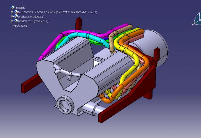

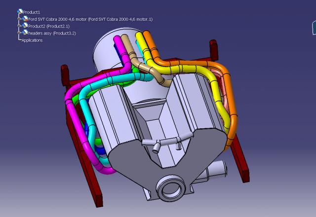

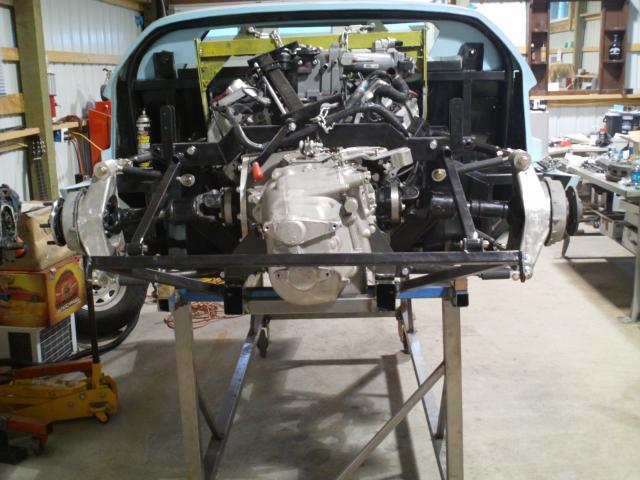

So the headers are modeled up. They are crossover but not equal length. They are 1.75 OD. I'll get the rear clip on and make sure there are no body issues. Does anybody happen to have a digital MKI body?

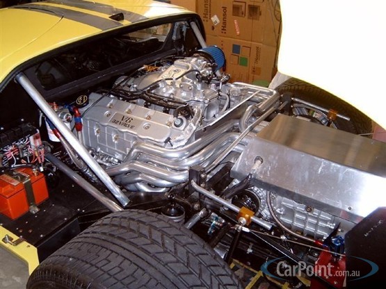

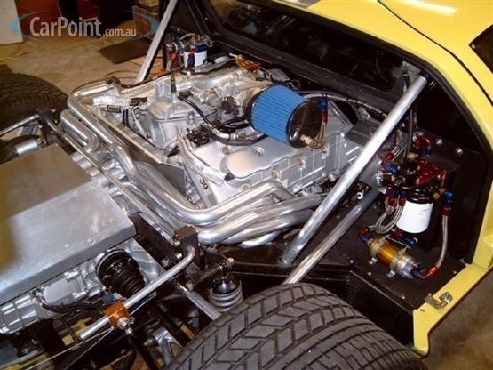

Pete, a couple of pics of a DRB GT40 for sale here with cross-overs on a non-turbo 4.6 quad cam engine. The exhaust fits inside the roll-bar brace also.

Thanks Dalton,
Pretty compact those pipes. The major difference with my setup and the stock DRB setup is I'm running the Ricardo tranny. That causes the cross member over the tranny to be a little higher thus pushing the pipes closer to the body. I fully expect to do some adjusting. These pictures sure help though.

Pete,
You can see from Dalton's post that the roll cage brace is way out there on the frame member to get all inside. Compare the placement with mine where the exhaust sticks a little farther away from the motor.
You might want to consider the changing of the valleys around the engine bay to shelves like mine for a little more room. You might even find some room to put some things on it!!
