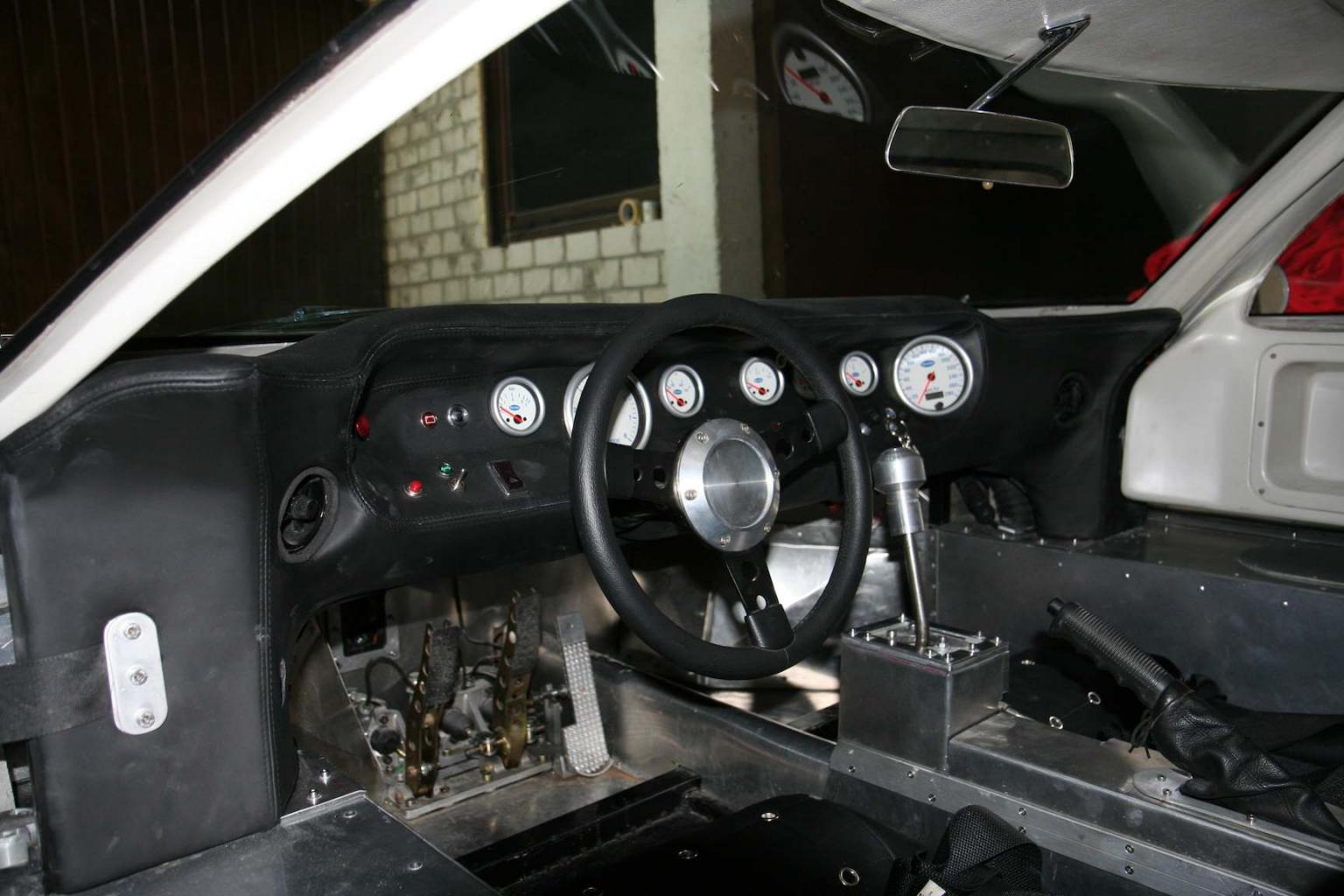

After talking to a lot of race car owners here ( track and rally cars), my decision was real leather ...I have chosen the dark no glossary one that you can find in bentleys today...No reflection in the windscreen....and I love it .....
Optics is fine, the rest of my car is bare metal...it looks good and feels fine....the center tunnel is yet to cover ....but this is for winter time......
If you go for leather make sure you get the highest quality you can and the darkest black there is ....For a good craftsmanship I paid around 600$ to cover it ....but it looks excellent .....and it is of course a lot of work.....see the pic...a bit dirty the time it was taken but you can get an impression ...
Flocking is no alternative....it peels of over time because the most glues are not ultra violet light resistend and ...Having spoken to several people and they all they they would not do it again ...after three years it starts peeling of .....
y.m.2ct
cheers
(C)arlos

Looks good Carlos. I was initially worried about the raw metal/leather dash look, but like yours, I think it flows really well.
I too like the metal leather combination. I'm using it in my interior also. The problem is that you are going to have to insulate some of the areas in order to inhibit the transfer of heat. A/C can only do so much. Once covered it will need to be finished off, unless the insulation is hidden and not exposed. If it is exposed, leather works fine there, or a good grade of carpet. If the car is going to be a track car then exposed metal or metal with insulation is expected. Most of them will limit coverings in order to save weight, or it will get soiled too easily. Exposed wiring is the norm, but it should be neatly done and placed in looms so it will function well, and, look good. If it is to be an occasional track car, or a street car, areas covered externally should be completed. Please don't take this the wrong way. I am not trying to sound dictatorial or condescending, but to cover part of an area and not all of it, to me, gives the impression that it is unfinished and therefore not complete, and again, to me, detracts from the total look of the car. Just my $0.02. Your title does ask what to do with your dash?!
