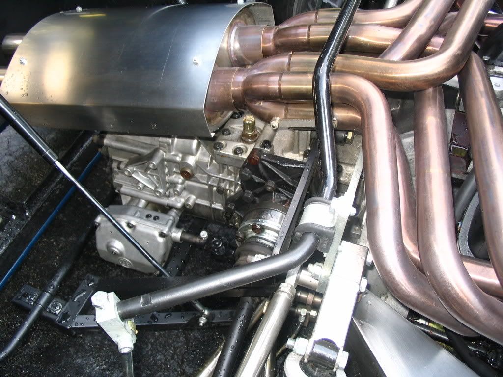

I have stainless headers and use WD40 on them to give them that beautiful gold glow,however if I were being more practical, I would silver ceramic coat inside and out and then wrap with black header wrap. This would most likely give the best under hood temps and still look good and racey. I think the life span would be longer than you are likely to have the car. I would , and plan to do, a heat shield under the mufflers and on top. I feel the tranny gets too hot from the radiant heat from the mufflers.

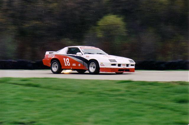

This is my old SCCA A/S Camaro.. Exhaust system is wrapped front to rear...
This shot was taken during the 3rd to 4th gear shift at ~6800 RPM..
When decelerating, the flame would light up the whole undercarriage in broad daylight.. More than once I was called to the pit-steward after the race to listen to complaints about how my car looked like it was going to 'SPLODE!!! :D

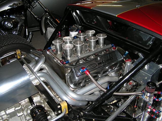

Ceramic silver they go that sort of grey colour after you get a bit of heat throught them.
