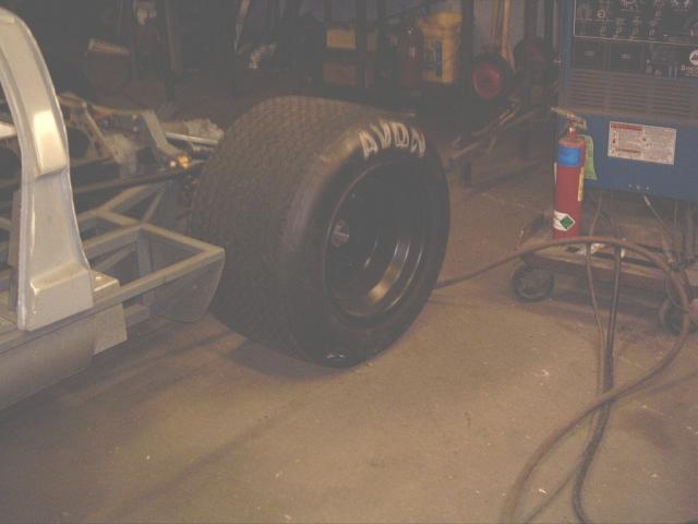

Fred;
I am using a 15 X 14 wheel in the rear with Avons. Backspacing is 4 7/8", and I am showing approx 75" across the top of tread side to side. The tires have a 13" width across the tread which is close to what you spec'd. The tread is narrower than the actual sidewall. My body work shows 77 1/2" inside to inside so I have approx 1" clearance on each side from the tread, and a little less from sidewall. I am running a track of 56" with pin drive adapters 3/8" thick so my actual track is 56 3/4". Tire diam shows about 26 1/2" with the car in all fours and although the Avons are not marked as such the aspect ratio would come in somewhere around 48, or close to a 50 series tire.
I guess a lot would depend on the bodywork you have, wheel offsets, track etc.
I know that you mentioned that you would like to run 17" wheels so I suspect that you would need an aspect ratio of 35 or 40 to maintain correct chassis height.
I hope some of this info helps.
Here is a photo of my rear setup
Phil
Charlie M

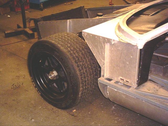

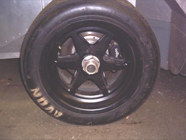

Charlie:
Track width in front is 56", wheels are 15 X 10 with a backspacing of 4 7/8", the bodywork I have was from a GTD, but the rear deck is an original piece, which I am having copied. All the bodywork is stuff I had accumulated.
Here are some photos of the front setup.
Phil
Charlie M
Thanks Phil. How did your front setup work out with the wheel position relative to the body? The tires fit in the fenderwells OK? I was planning a 57" front track width with 8" wide wheels. If your setup works well I could go to a 58" track width and have the same width as yours to the outside of the tires. I'm trying to spread the front suspension out as far as I can to get more room in the footwells.
Charlie
Charlie:
I can tell you that the front tires are closer than the rear to the bodywork. I will take a measurement of the front bodywork today and post it later. The front was a bit of a challenge as the adapters would have put me beyond the bodywork so it was necessary to fab an adapter/hub which brought me back to 56" track to fit the 10" wheels. I would guess it all depends on your backspacing and width of your body. My front tread fits within the bodywork but its close. If I remember there were some posts previously on the forum about front track being too wide with adapters, and the availability of different backspacing dimensions was limited, which is a problem you may encounter. Here is a photo of my front setup, I will post the dimensions of the bodywork tonight which is probably close to what you would have.
Phil
Charlie:
Front bodywork is 69" to outside with a 1/2" lip to inside. so I have 68" inside. Tires measure 68" full width, and 66 1/2" across tread. As I said it is close.
Depending on your backspacing with an 8" wheel you should be able to go to a 58" front track as long as it is 4" or more, and it would be approx the same dim. I am getting, but that would be your max wheel with that setup. It may allow you to expand the footwell area a bit.
Phil

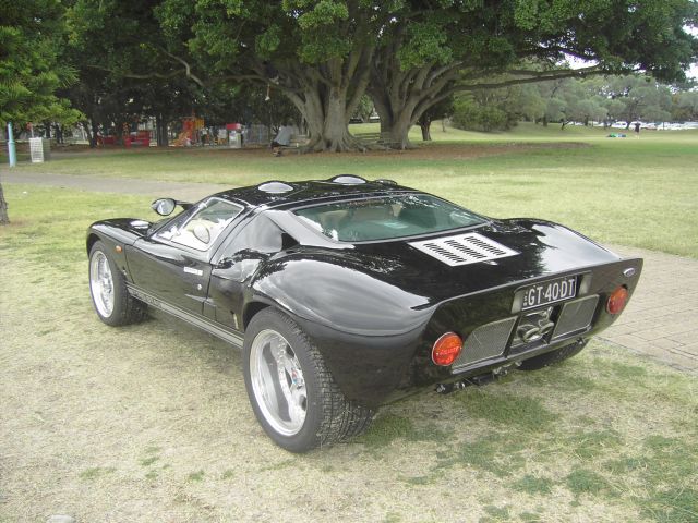

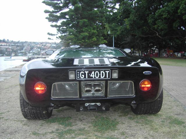

Dimi Terleckyj
Hi Fred
These are 345 Pirelli on 12 inch rims.
You would not want to put smaller tyres on a rim 12 inches wide.
As it is with these there is very little bag in the walls.
Dimi
