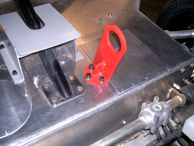

Here's something to think about now well ahead of time. Just how would you winch the car onto a flat bed tow? Where would you attach the tow cable to the car? And can the car be towed onto the flat bed with a front tire down.
You need a tow point on the front of the car. Not on the suspension, or the front radiator mount plates and the splitter brace is out also. So what to do?
Here's what I did for my track car. A much smaller mount point could be attached to the foot box with just a threaded bung protruding form the body work in front of the windshield. Then use a threaded tow ring when necessary. When not in use plug the access hole with a plastic plug on some sort.
