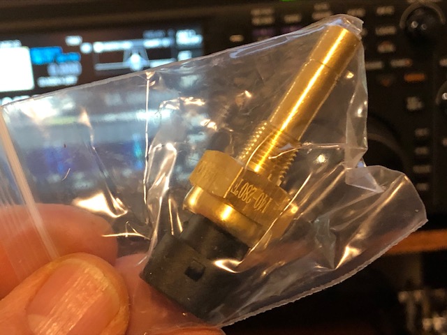

Where would one install a 1/8" NPT temperature gauge sensor on a ZF transaxle?
I am wondering if there is plug already there for that purpose? I don't want to drill and tap a new hole.
My initial thought was to use the drain plug which was added when configured for GT 40 use, likely with an adapter to match the size.
As long as the sensor itself is immersed in the oil, it would work just fine. Don't forget that electronic sensors generally need to be well grounded through their threads. IE - don't put thread sealant on the full depth of the threads.
