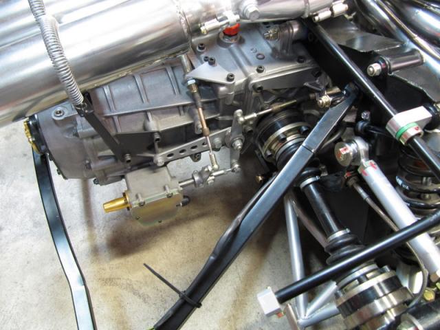

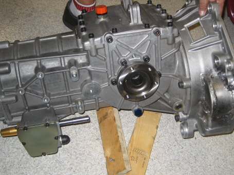

Custom headers, Engine bay mod's by Hi-Tech, modification to starter position on ZFQ bellhousing and I think the rest was quite straight forward. I think the installation is really good and solves the emission problems in Australia.
regards
Chris
Picture below shows modified starter position.

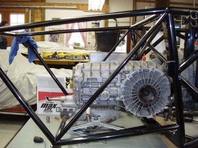

I certainly dont have a real 917 motor. I'm using a 993 motor. on a real 917, the transmission input shaft runs off the engine output shaft the sits a couple of inches below the crankshaft as opposed to a typical 911 motor where the input shaft runs direct off the crank, therefore the input shaft location is higher on a 911 motor. My point is, I was originally going to use my 930 box(flipped ring gear) with its typical porsche orientation with the input shaft above the output shafts, So I figured when I switched to the ZFQ, the right thing to do would be to invert the box so it is in the exact same orientation as the 930 trans. Seems logical. With the standard zfq orientation I have a couple of concerns. 1. the output shafts will be too high, half shafts will angle down like a ski slope, looks nasty. 2. the higher trans will interfere with the 917s frame triangulation at the rear. I want to keep the frame to exact 917 spec. here is a photo with the 930 trans mounted to the frame. notice the frame tubes above the red oil fill plug, that will be a clearance issue with standard zfq orientation.

ZFQ uses a hypoid R&P which makes it like the G50 rather than 930, so if you fit it to your application as pictured you will have 5 reverses & 1 fwd . I dont think ,( but Im sure Chris will correct me if Iam wrong ) that they make a reverse image version of the R&P for the ZFQ to allow its use in the std Pantera position or the likes of yours..yet. Not quite as simple as the shaft load paths change direction as well.
Hi
As I said above the output shafts on a 917 Porsche are 200mm from the bottom of the chassis and you can fit the output shafts on the ZFQ at that height. The transaxle you have ordered is a special build with a 5" extension on the input shaft to place you 6 banger 911 engine closer to your C of G. Russ Hughes has researched the dimensions already for his excellent 917 build and is happy with the transaxle dimensions and output shaft positions.
The 917 runs a much lower ground clearance than the 911 Porsche so running a 911 transaxle in its usual orientation will i.e. output shaft below input shaft will give you drive shafts that run up towards the hubs not a good idea. You want to keep your motor as low in the frame as you can to help with the C of G.
So relax the ZFQ will fit
Regards
Chris.

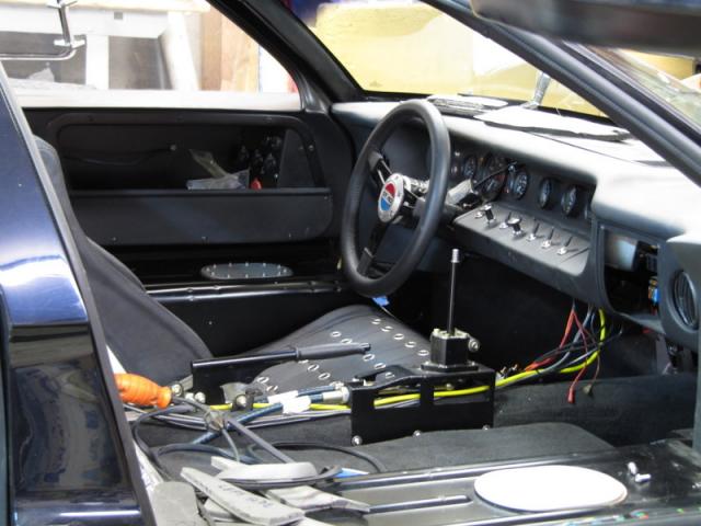

Shifting problem.
I'm trying to figure out why changing gears take so much effort. Before I hooked up the cables to the ZFQ things moved nice and smooth. I'm using the brackets supplied by Oltoff. Its not that I can't get it into every gear it just takes LOTS more effort than any car I have ever driven.
I will say the centering springs are not what you would call light and I'm considering either changing to lighter springs or removing them all together. Except for the spring the shifter moves left to right OK but getting into gear isn't what I would call silky smooth. Any Ideas.
One more question. I'm thinking of building a rod linkage setup. Can anybody tell me the degree of rotation and distance in and out on the shifter rod to make gear changes?
Thanks.
