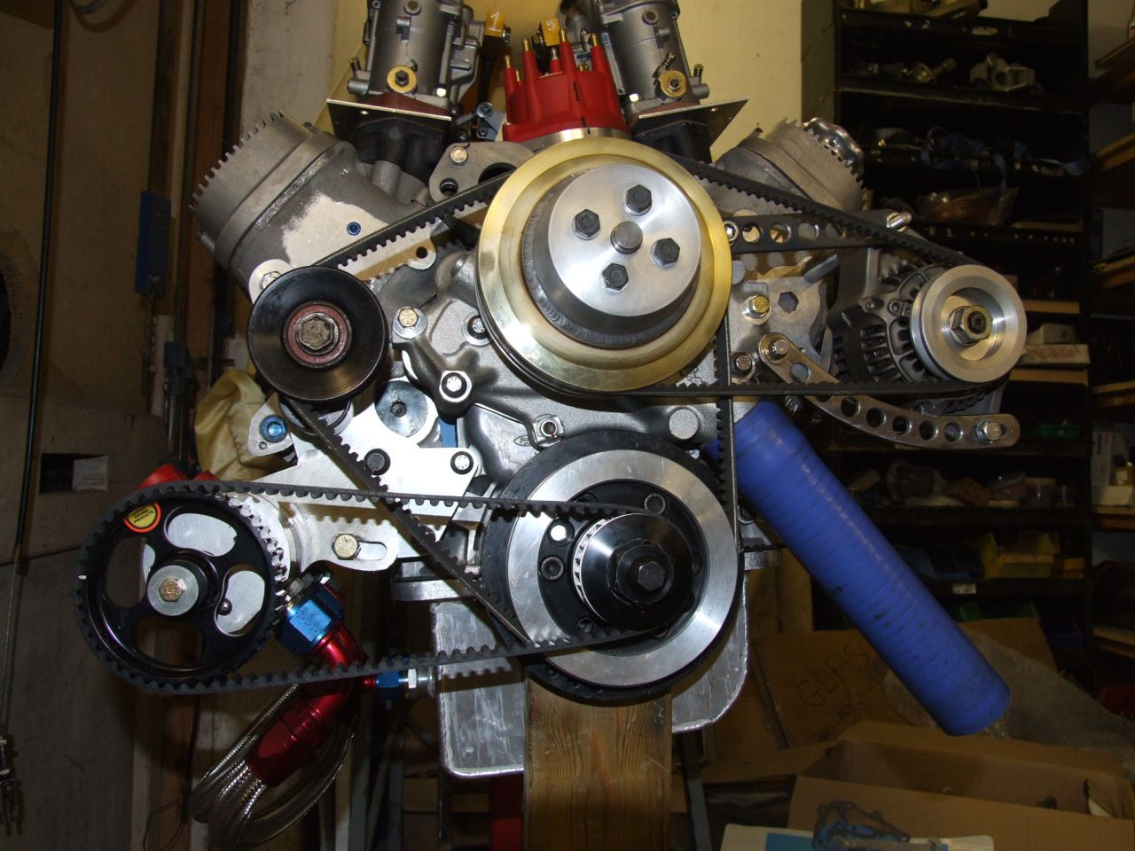

Chris, help me out here, please. I remember as a new forum member I posted a thread regarding dry-sumping, and the discussion led me to believe that the external pump replaced the distributor driven oil pump.
Here is a link: http://www.gt40s.com/forum/gt40-tec...ock-preparation-required-dry-sumping-sbf.html
Have I been floundering along all this time without fully understanding the system? Does the standard location oil pump remain functional in a dry-sump system?

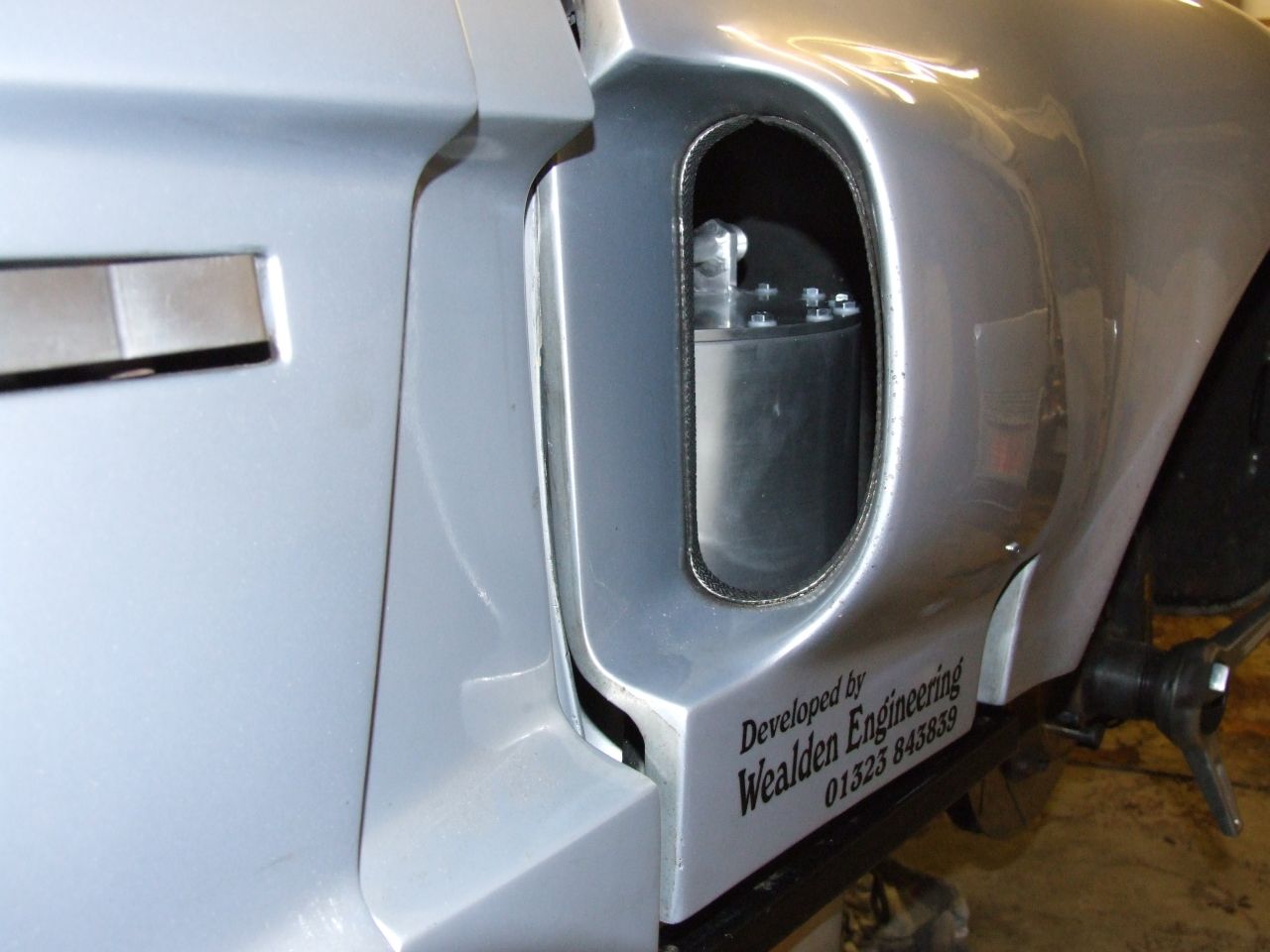

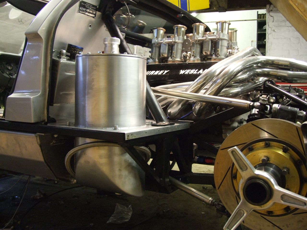

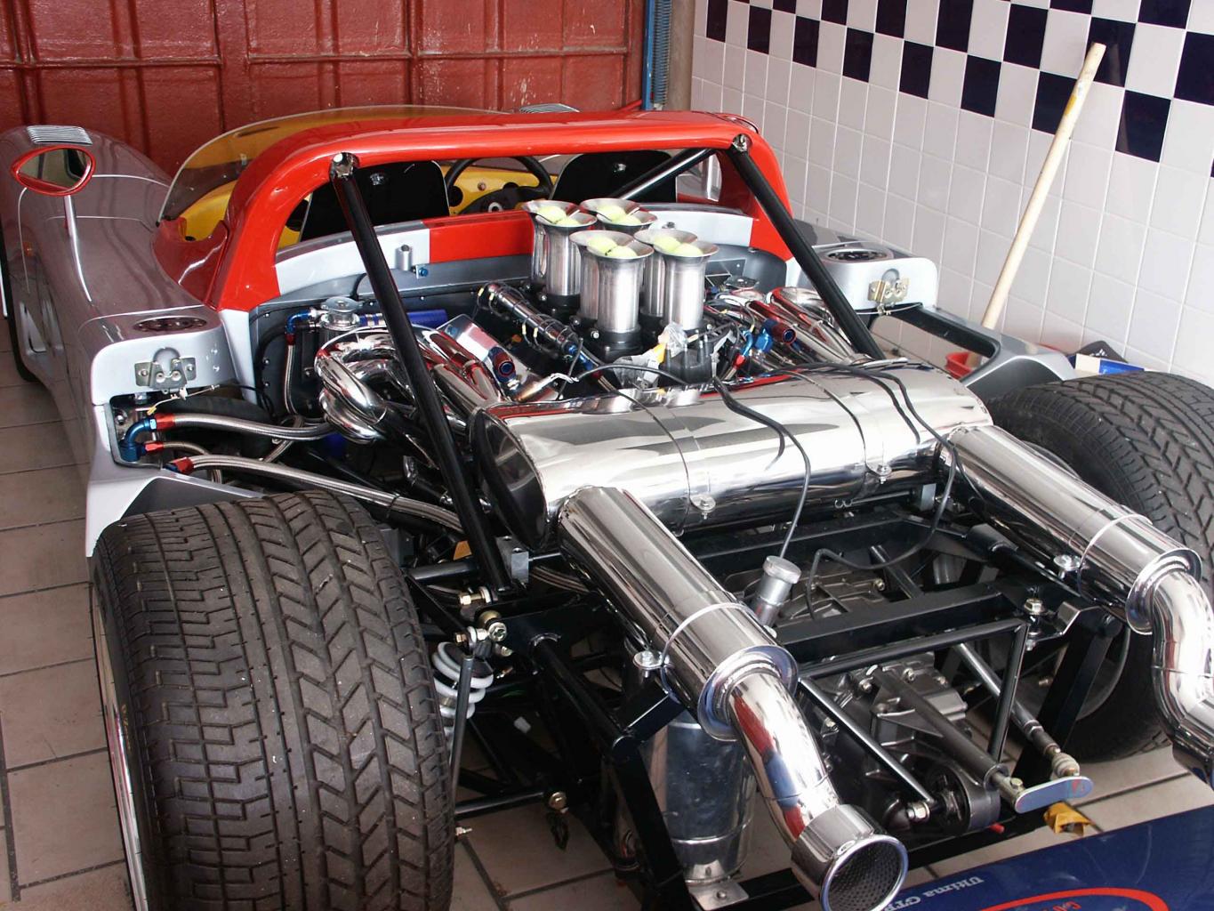

This is Keith Bakers first GTD which we have now converted to dry sump, with Gurney Weslake engine dynoed at 548 hp. Fairly simple set up works very well ! Frank
Cheers from Doug!!
Hi Doug -
Nope - with a dry sump system, the drive to the pump is removed. It is a small hexagonal quill shaft from the bottom of the distributor, so removing the quill, removes drive to the pump.

Some early dry sump setups still used the OE pump as the pressure section, instead of having a pickup tube & screen the pickup was brought thru the side of the pan to the bottom of the oil tank, then a two or three section scavenge pump would be belt/chain or direct cam driven.

Hi Doug
I am not an expert on this subject but do know you need 2 separate pumping functions for a dry sump system - one to scavenge the oil from the sump and possibly other parts of the engine and return it to the oil tank and the other to pressurise and circulate the oil round the engine. My understanding is that the belt driven pumps used on American V8 engines perform both functions and are in effect 2 pumps in the one unit and therefore replace the standard pump. I would assume, therefore, that more engine power would be absorbed by this type of pump than the standard wet sump system pump. But I could be wrong!
A Formula Ford engine I raced with many years ago had 2 separate pumps on the same shaft driven off the camshaft as per the wet sump engine. I believe our Radical also has 2 separate pumps also.
