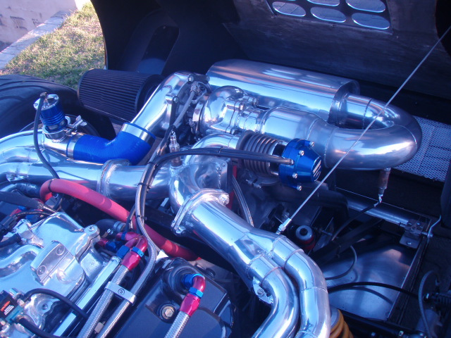

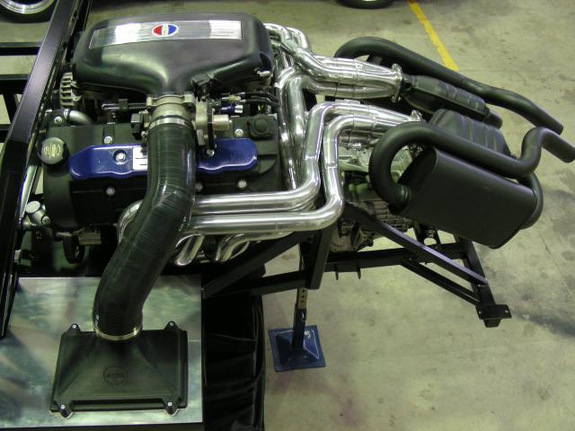

The 4.6 seems an easy fit now that we have done the 5.4 which is a little tighter but plenty of room in the RF to work on all the parts.
Attached pic I think is on other posts but shows std compliance inlet and exhaust packaging.
Regards Paul

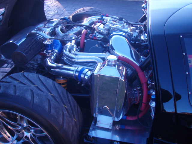

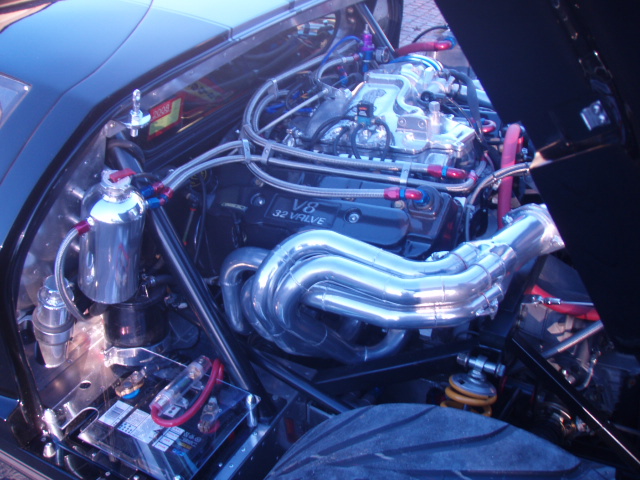

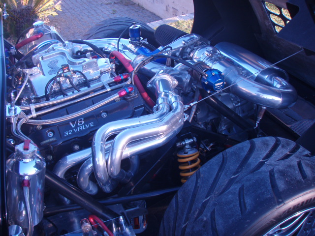

Here are a couple of photos of my RF40 MKII with a 4.6 mod motor. It fits easily and it's an aluminium Teksid block thats light wheight. More than enough power for anyone and it's so easy to drive.
