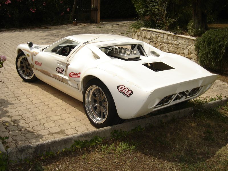

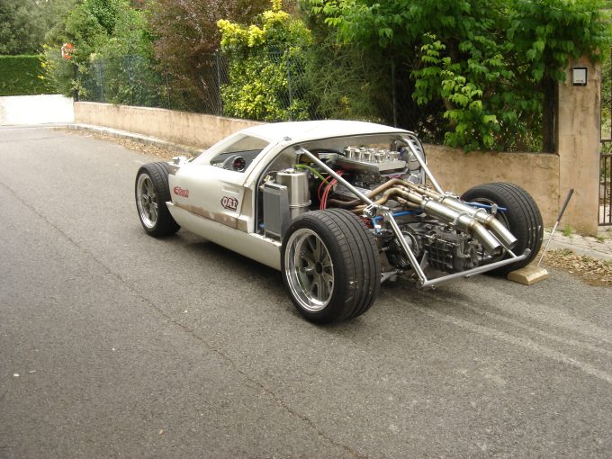

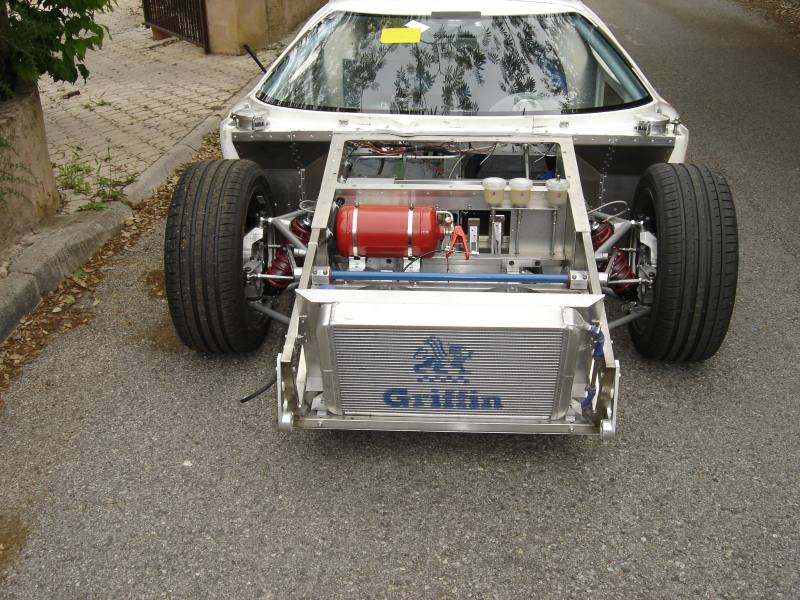

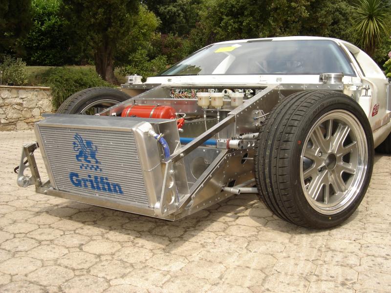

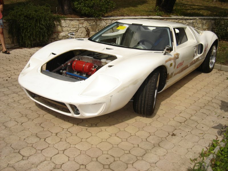

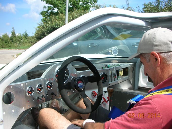

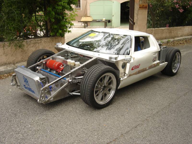

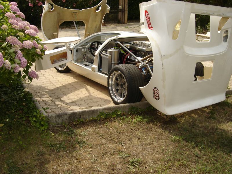

Great step these last days on my project ! We put the car on the garage floor, pulled it outside and made the first driving test !
After 4 years of welding , machining, assembly etc ...in the "dark" garage , it is really enjoying to have it outside in the sun!
This very first test was made of course at a very limited speed, 20 km/h in front of the house....but I had time to get a very acceptable feed-back on the main points :
Steering is quite smooth, the clutch is progressive, gear box is firm but precise; the brake pedal is "long" , but the paddles are brand new, not seated .....
By the same time I made a first weight measure ( With a modified bathroom scales !) and got , in running conditions:
Rear : 580 kg
Front : 400 kg
Some equipments are not yet installed( Lights, polycarbonate screens...), so I expect to go to about 1030 kg finished; I am satisfied of this level, as I built the chassis quite strong ....
Now, the objective is to go ahead 20 kmh ....and check precisely every driving parameter .....

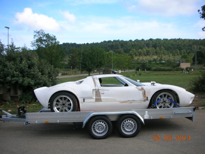

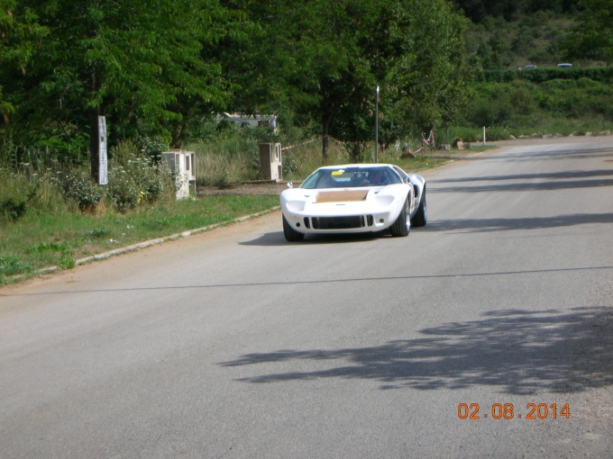

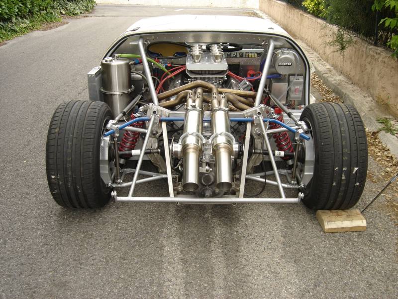

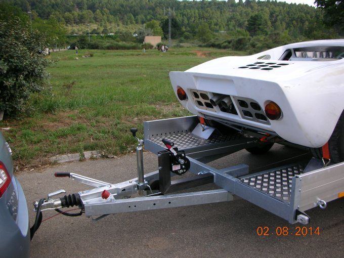

After the fisrt driving test, the main achievement these last weeks was to find and adequate trailer for moving the car on adapted test areas ...
Of course, it is not yet registered , and will not be for ...some time ! ( French regulations ....) .
So I decided to purchase a dedicated trailer to be towed with my daily car .
I finally decided for a brand new 4 wheels trailer , Anssems 1500 , with 1200 kg load capacity ; as the GT 40 is presently 980 kg, there is not problem.
That way I got access to a quiet "test area" , a few km home ; it is not a track of course, this will be the next step, but I could test higher speeds , up to 110 kmh!
The general behaviour of the car is still fairly good, exepted the brakes which are still a little weak ( from my opinion...) ...But seems to be improving while the paddles ara seating .
For the time being , I limited the engine at 4000 RPM in order to test gently everything before going farther ...
At 4000 RMP precisely, I discovered some "blow -by" effect with oil pouring from the passenger side rocker cover breather ....down to the hot headers !
The sealing of the breather on the cover was probably the cause ....Fixed with some machining , but to be tested ...
