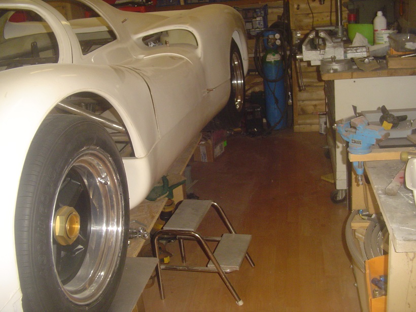

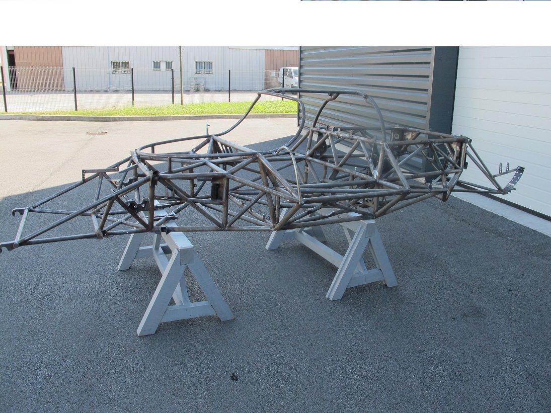

Yes indeed connecting all the main harness is something nice to achieve but lot of work ( I just finished mine during Holidays !!)
some pic with 908 bodywork and suspension fitted before to have the chassis epoxy painted (this will be ok from subcontractor coming back home)
Keep on your good work ; hope to watch some good progress of your nice GT 40 in august !!

Very , very nice job you did there Mic ! This chassis is an "oeuvre d'art" ..
Do you really need to install a body on this metal sculpture ?
I am joking of course , the Porsche 908 body as the same hudge "speed evocation power" than the GT40 has ...

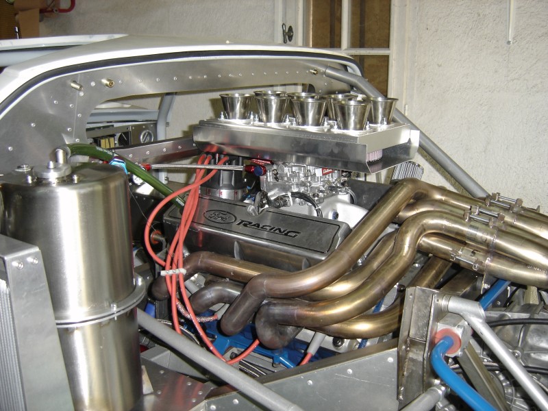

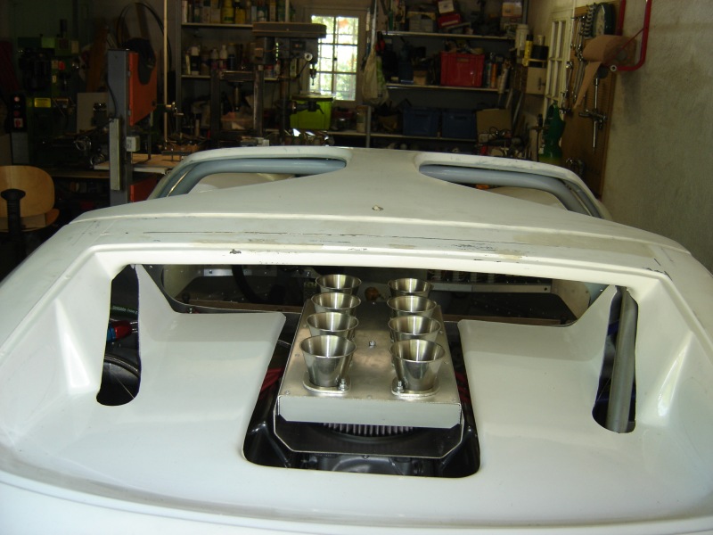

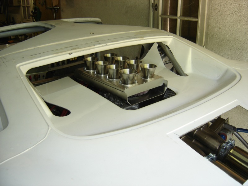

After the break-in sequence, I when ahead on the build with a specific air-cleaner box ....
And I have to admit that I did not resisted to the idea of installing dummy trumpets on the air-cleaner box! As visible on the pictures...Hum ...
Obviously , I have to apologize for those who spend money and time for full "historic" Weber carbs and trumpets; but I confirm that the next major evolution which is already decided on the engine, is an EFI conversion with 8 throttles and trumpets !
More seriously, I am now looking for the optimum engine adjustments: Ignition, AFR etc ...
And I am going to connect a wide-band O2 lambda gauge ( Not permanent ) in order to have an exact information on the AFR ; I suspect it to be in the lean area at middle range, due to quite hot headers....

Your special velocity box is very very "smart" !!!!

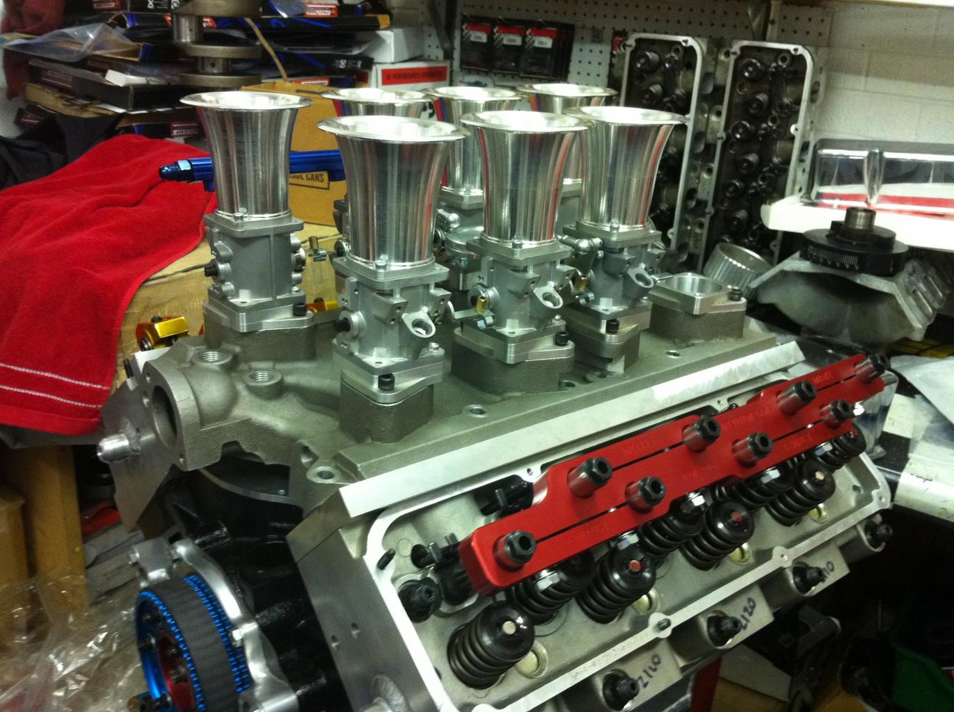

this allow you to wait for your new injection system ;are you using some Jenvey kit ? seems they are not so badly manufactured.
I think you are thinking to improve your engine injection to win our future track day
"encounter " LOL..... GT 40 VS 908 !!! in memory of le mans 69 big battle
Am just working too on my RSR engine to have it ready to fit it on the painted chassis

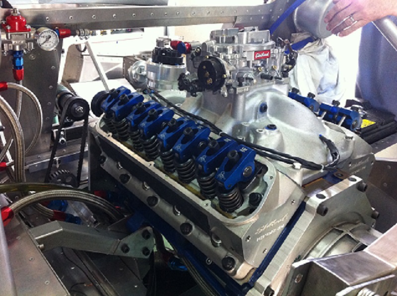

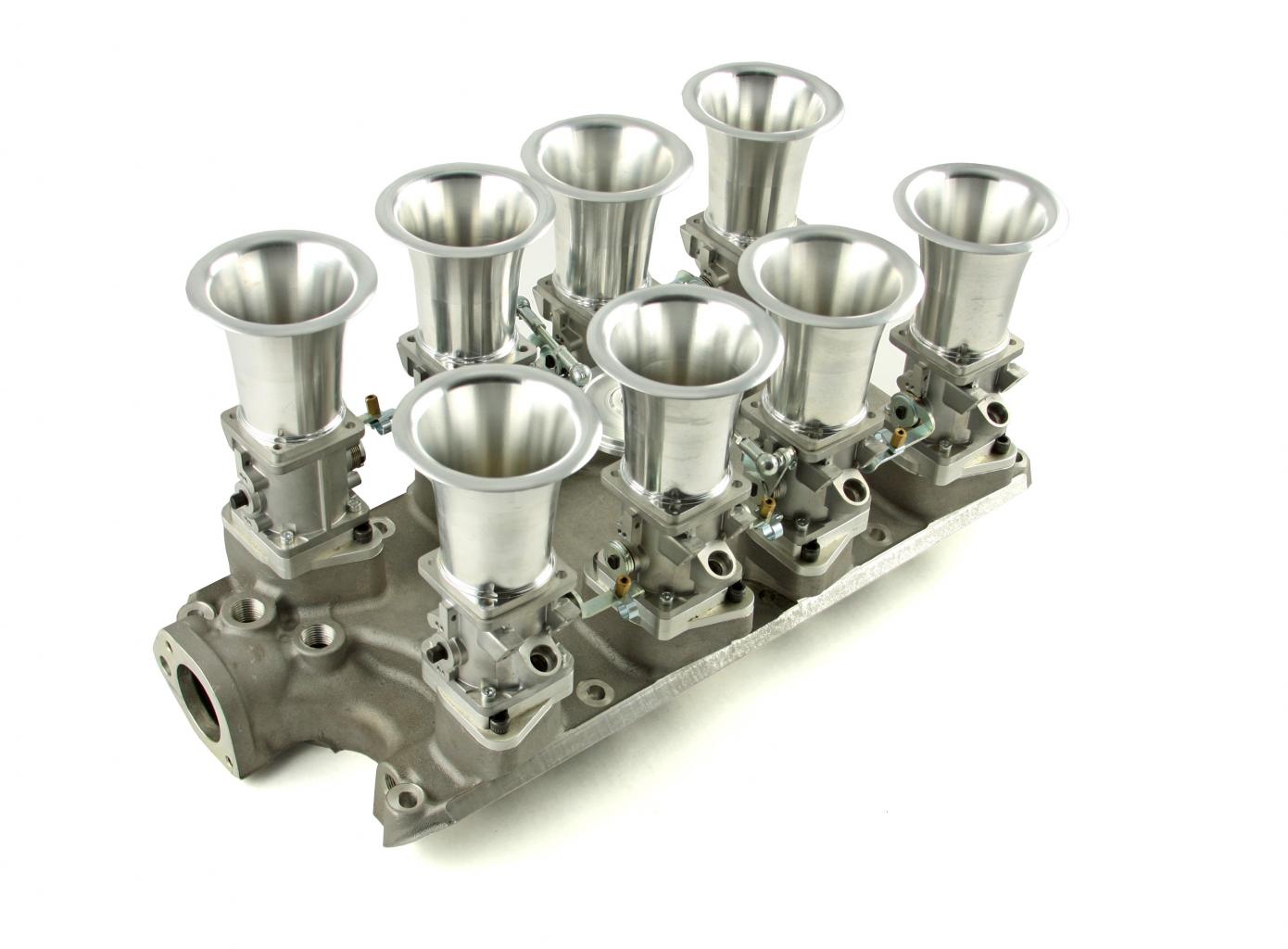

There is also this supplier ( stackinjection) doing anice kit ;
Australian supplier
