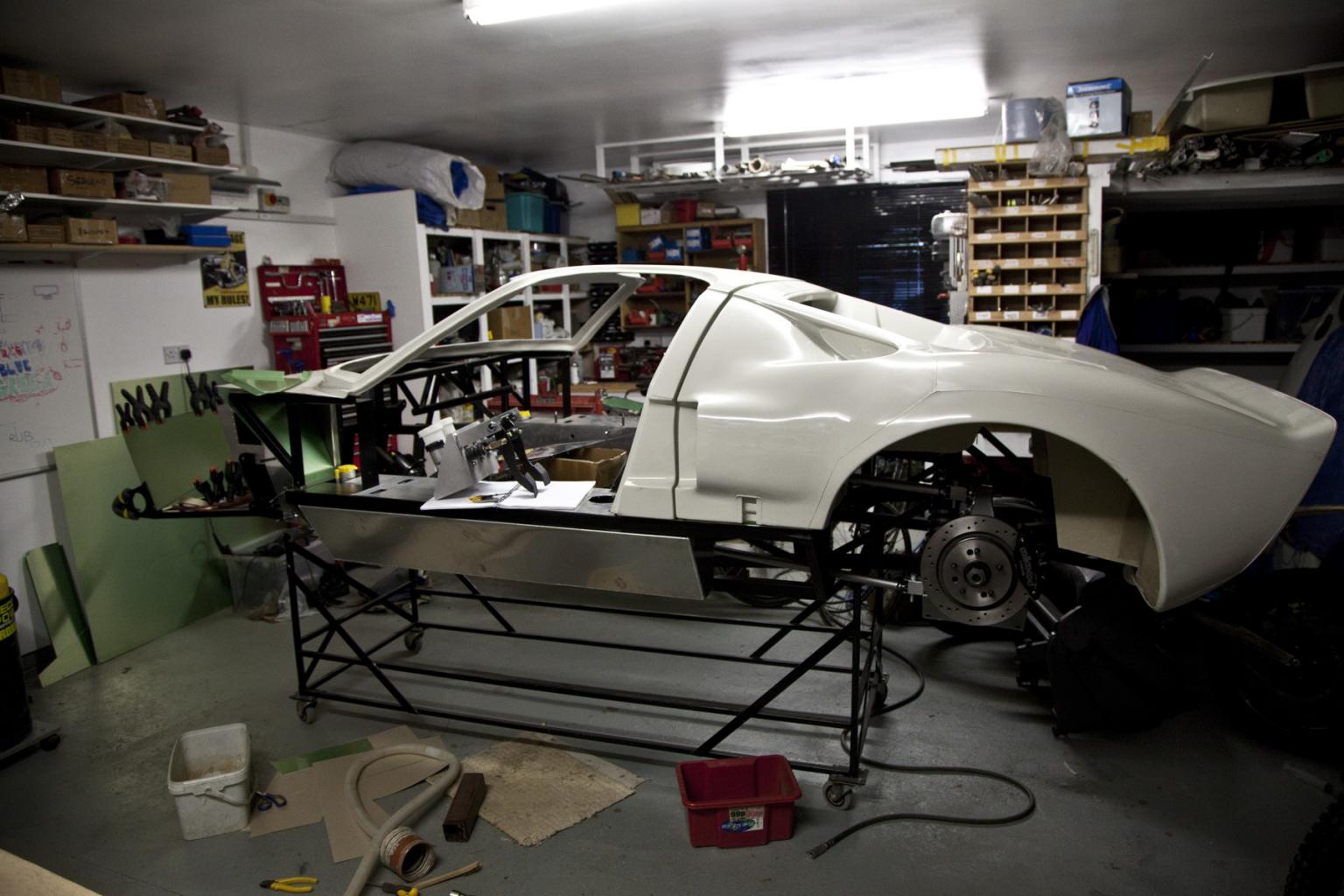

A bit more progress yesterday.

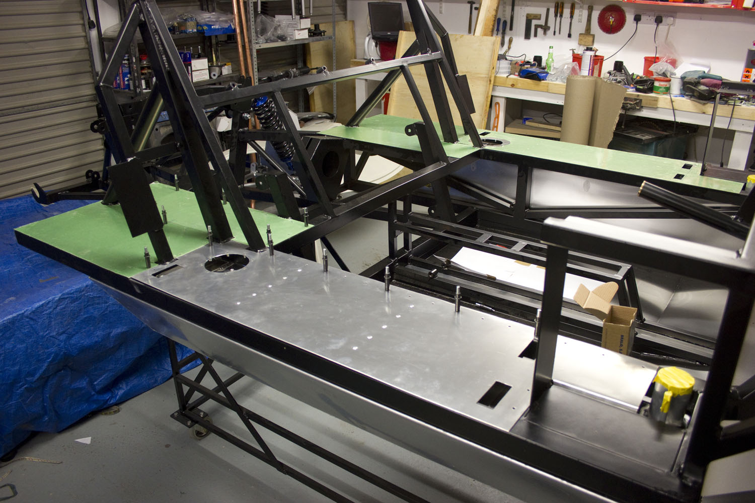

The sill panels are cut and drilled, and ready for riveting.

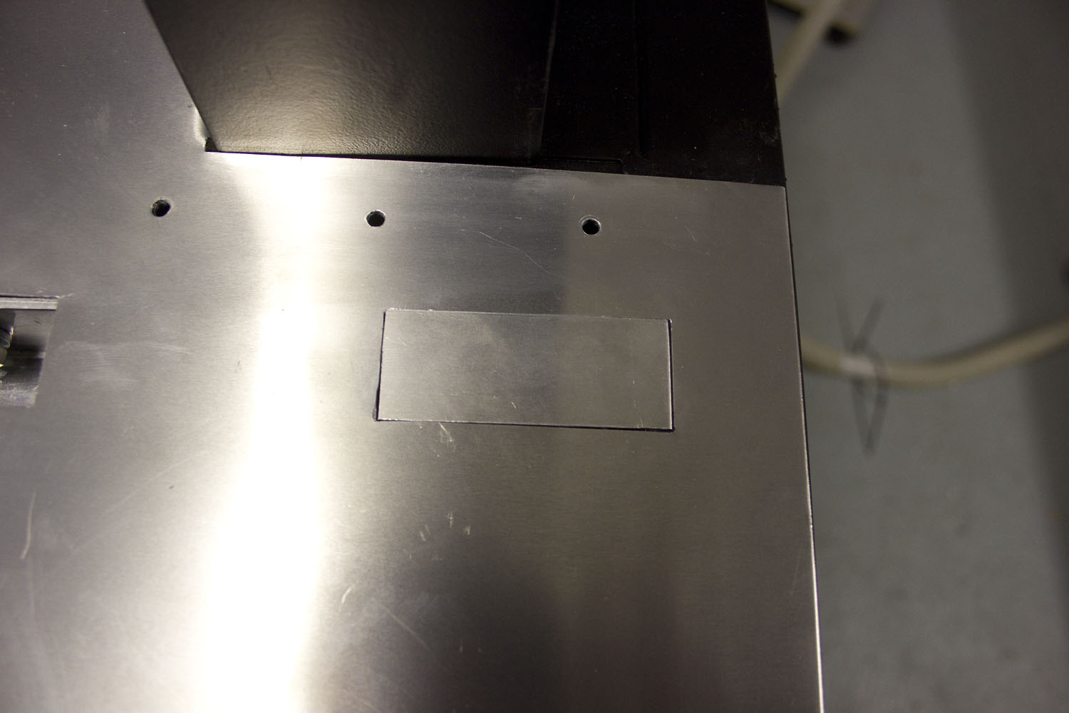

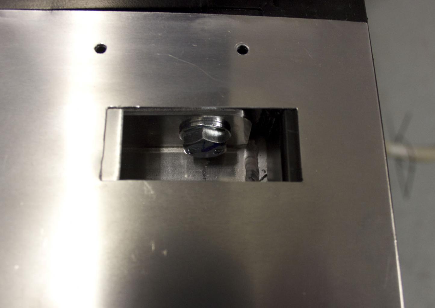

I've seen several solutions to the problem of being able to remove the tanks after the sill panels are installed. Mine was to cut slots over the tank mount bolts, then lightly glue in a peice of aluminium that can be prized out later if need be. Leaves a nice, flush finish.

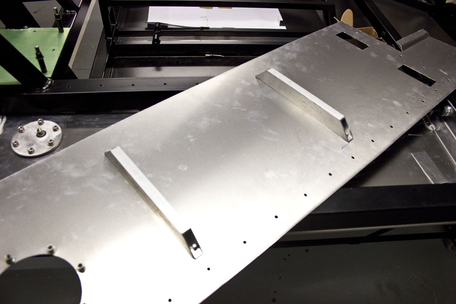

I also made the sills a bit more ridgid with a couple of lengths of rectangular box section.

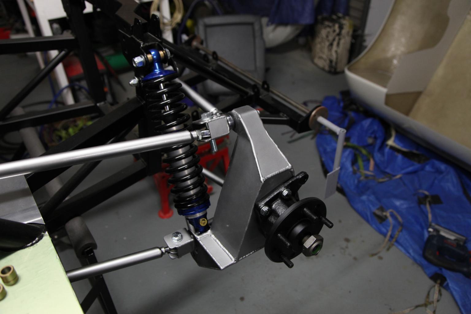

Couldnt resist putting one of the rear uprights together. Got to love those alloy shocks.

Hi Jason, Question is it not possible normally to remove the tanks once the cills are fixed ?
Seems not a good idea as during the build you will put the tanks in out many many times, trial fitting etc etc.
Also years down the road your will take them out.
It dosen't seem a good idea not to have them removable. I wont say what manufacturer bolts the tanks in with 4 rubber mounted M10 for ease of removing but Mine does !
Once the ally panelling is finalised I run a line of sikaflex along the edge where it meets the chassis, takes out some vibration and seals the area between the tanks and the cockpit ( fuel fumes )
Also consider Dynamat sound insulation, easy fit and baffles noise and vibration.
Looks Very neat mate
Jason,
Just make sure those cut-outs are sealed incase IVA check when you get to it. The fuel compartment area is meant to be sealed off from the driver cabin.
Looking good, well done
Brett
I wouldn't solidly fix the tanks to the chassis. Over-time, flexing and vibration could weaken the Alloy? Mine will be squeezed in and held in place by high desnisity foam all around and two straps. Definately do as already recommended and allow for easy removal!
Good point Brett. I'll probably seal them in completely when the build is complete. They might be in and out a couple of times during the build, but after the cars finished I'm not so bothered about them being easy to take out.
Hi Keith,
You have to leave some holes above to get to the tank bolts. The normal method seems to be round holes with a flush fitting plug. Tornado's build photos show this method. See Trevor and Scotts builds.
I'll be doing the same as you and sealing the cockpit from the tank area once the build is done.

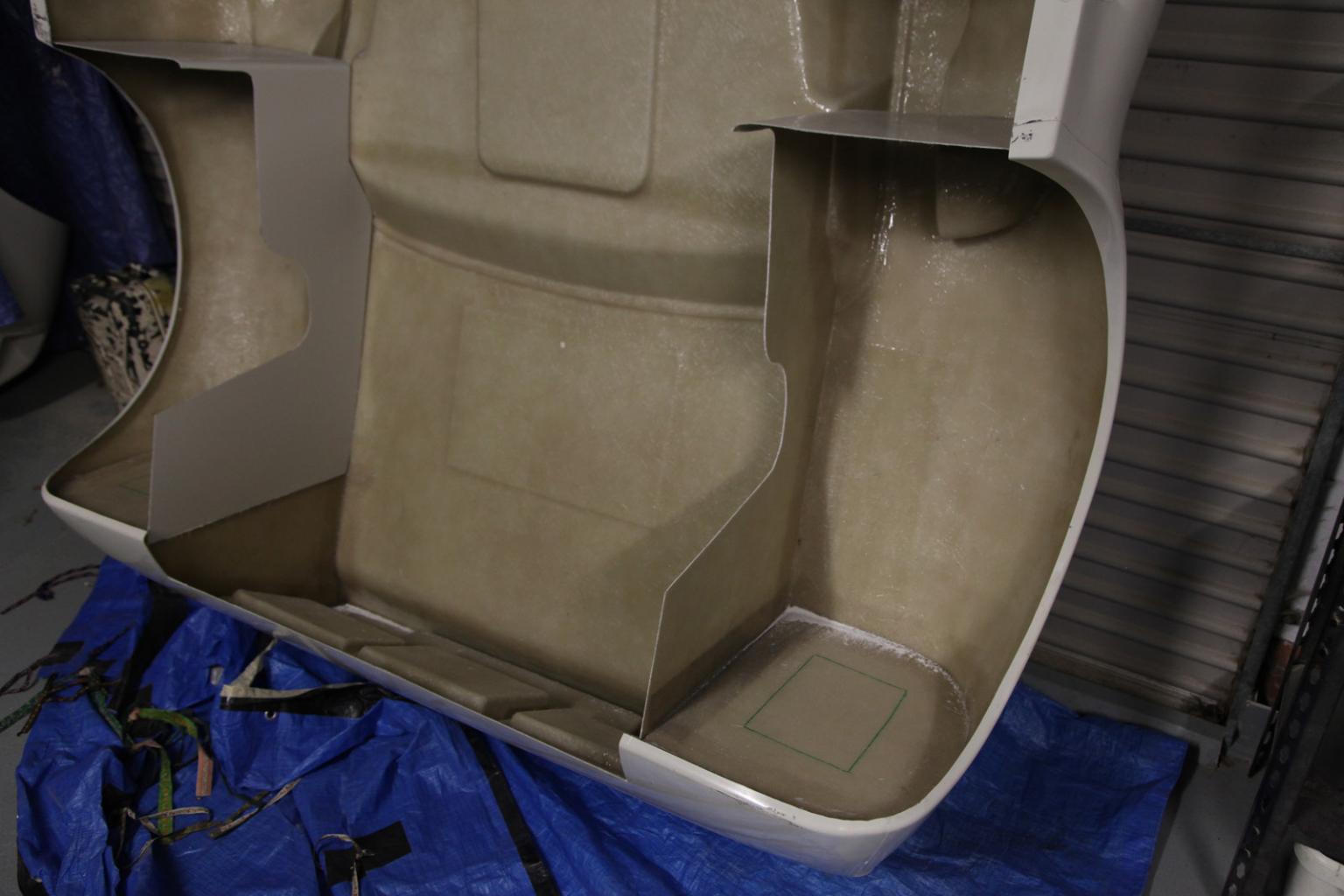

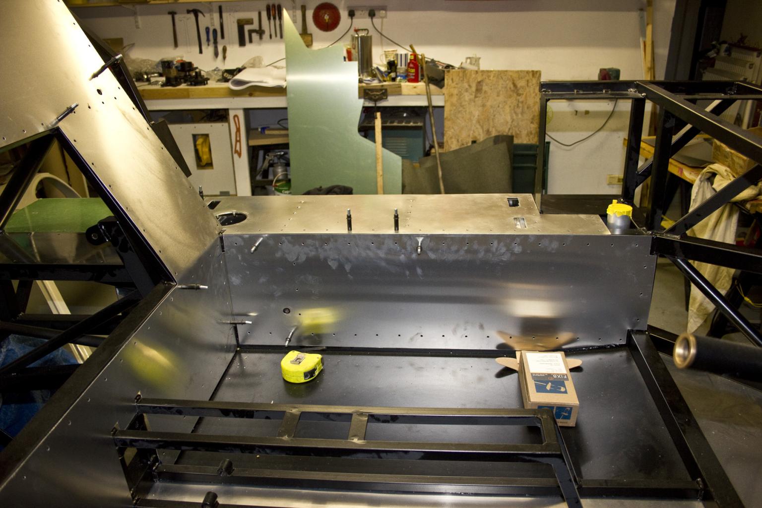

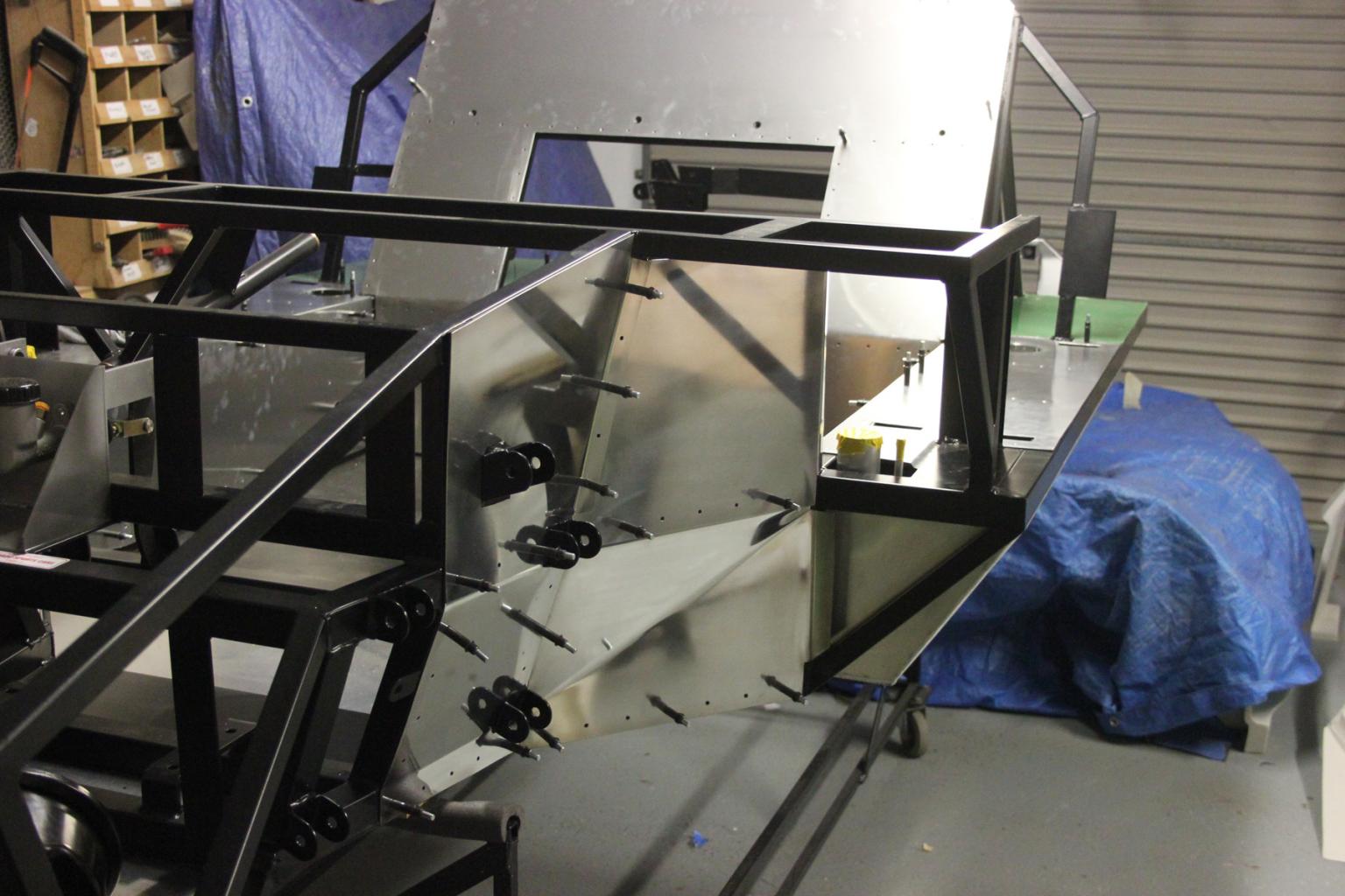

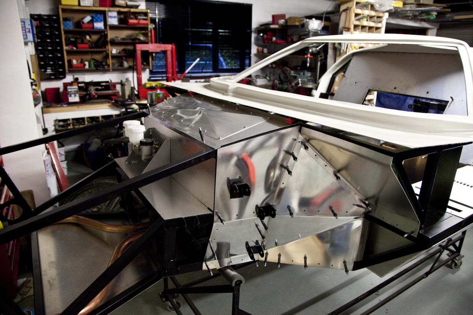

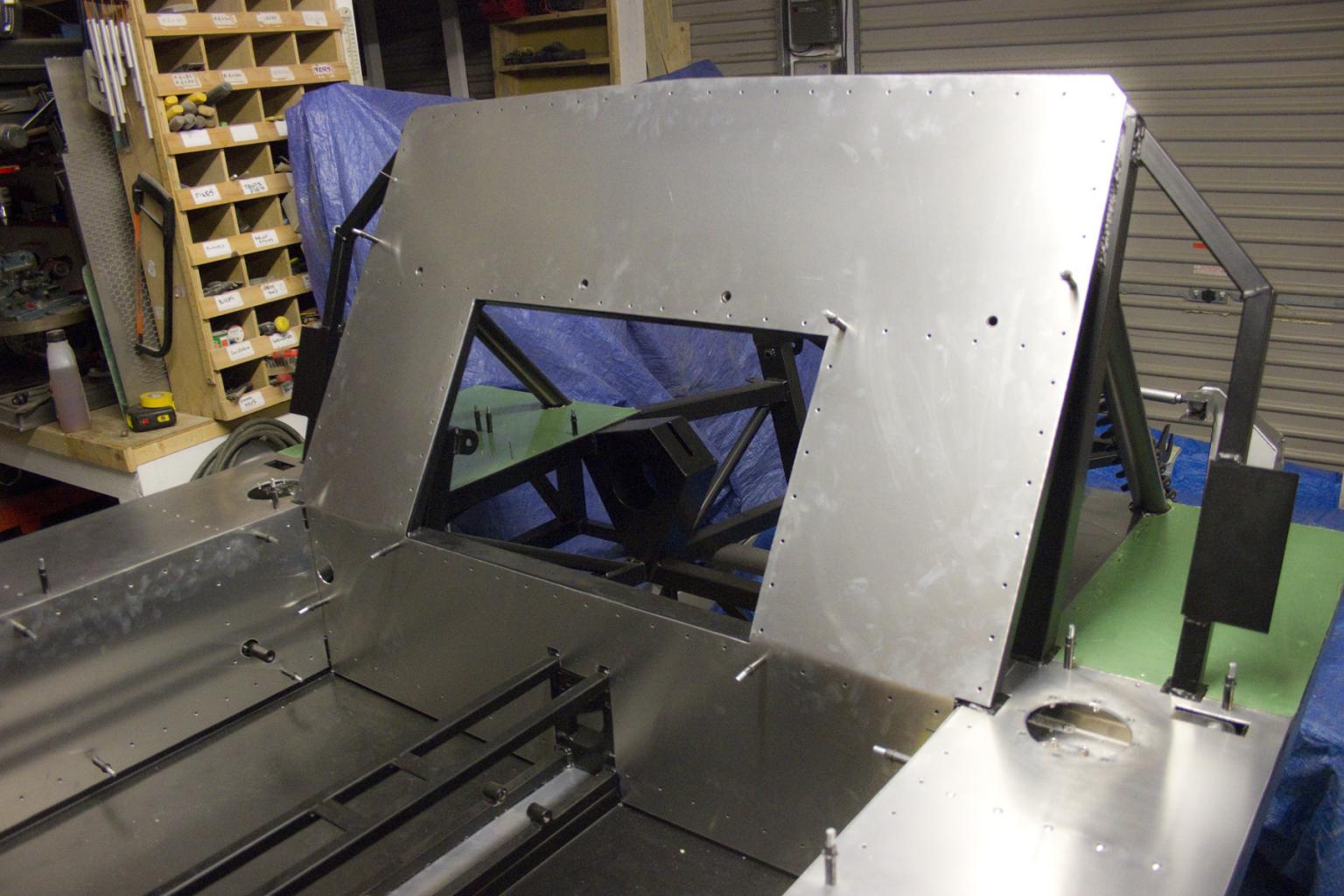

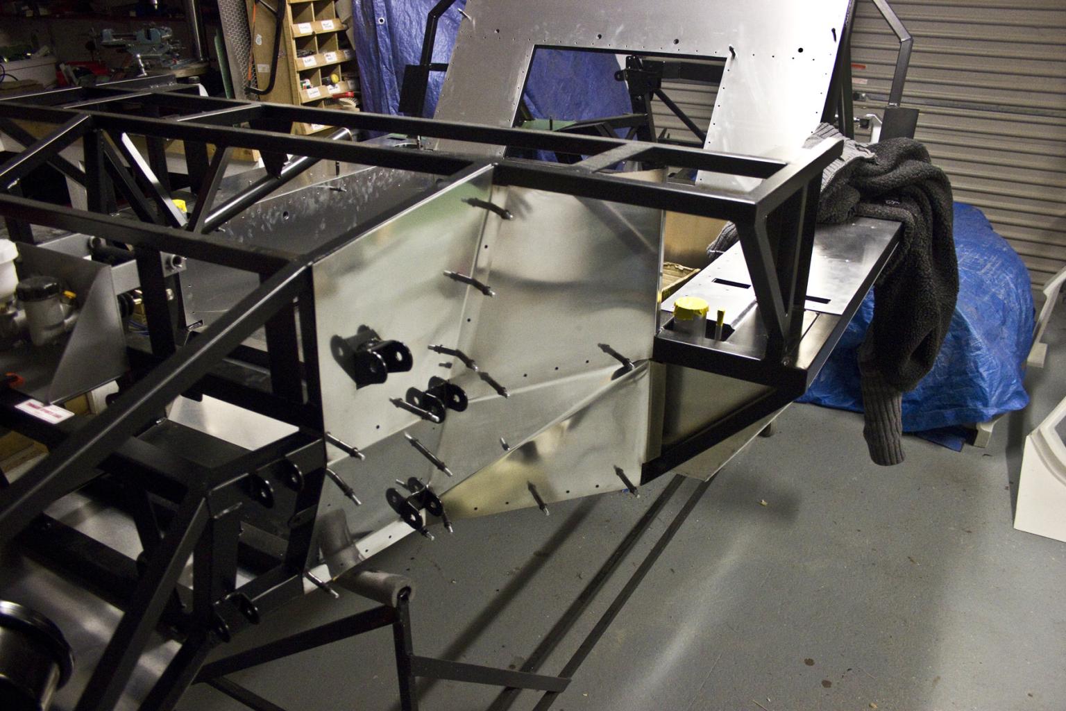

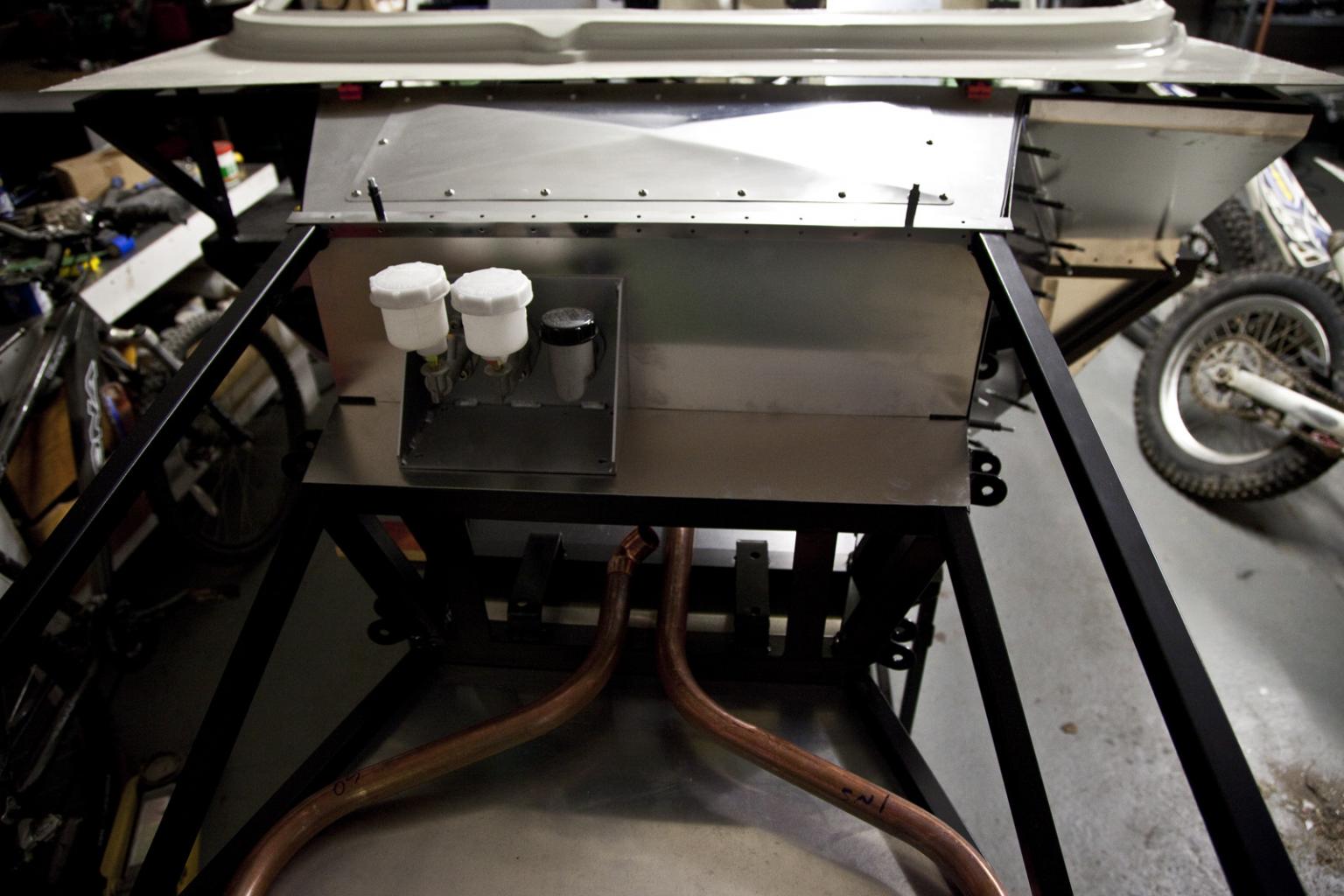

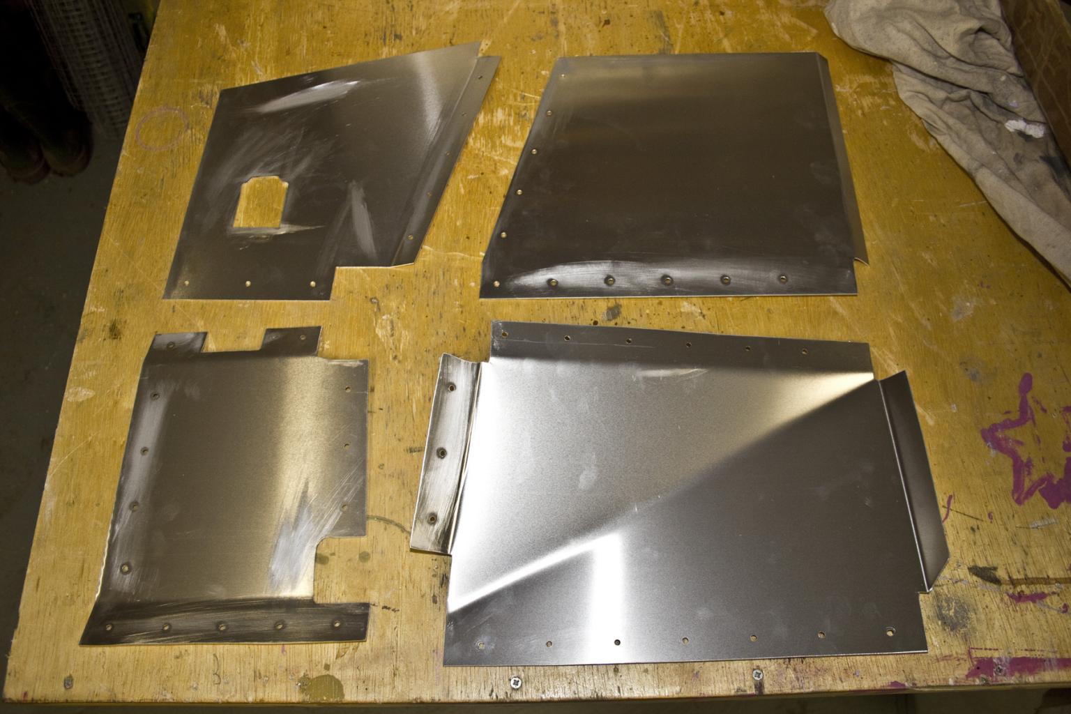

A bit more paneling progress. Rear bulkhead cut and folded, and inner side panels ready to rivet.

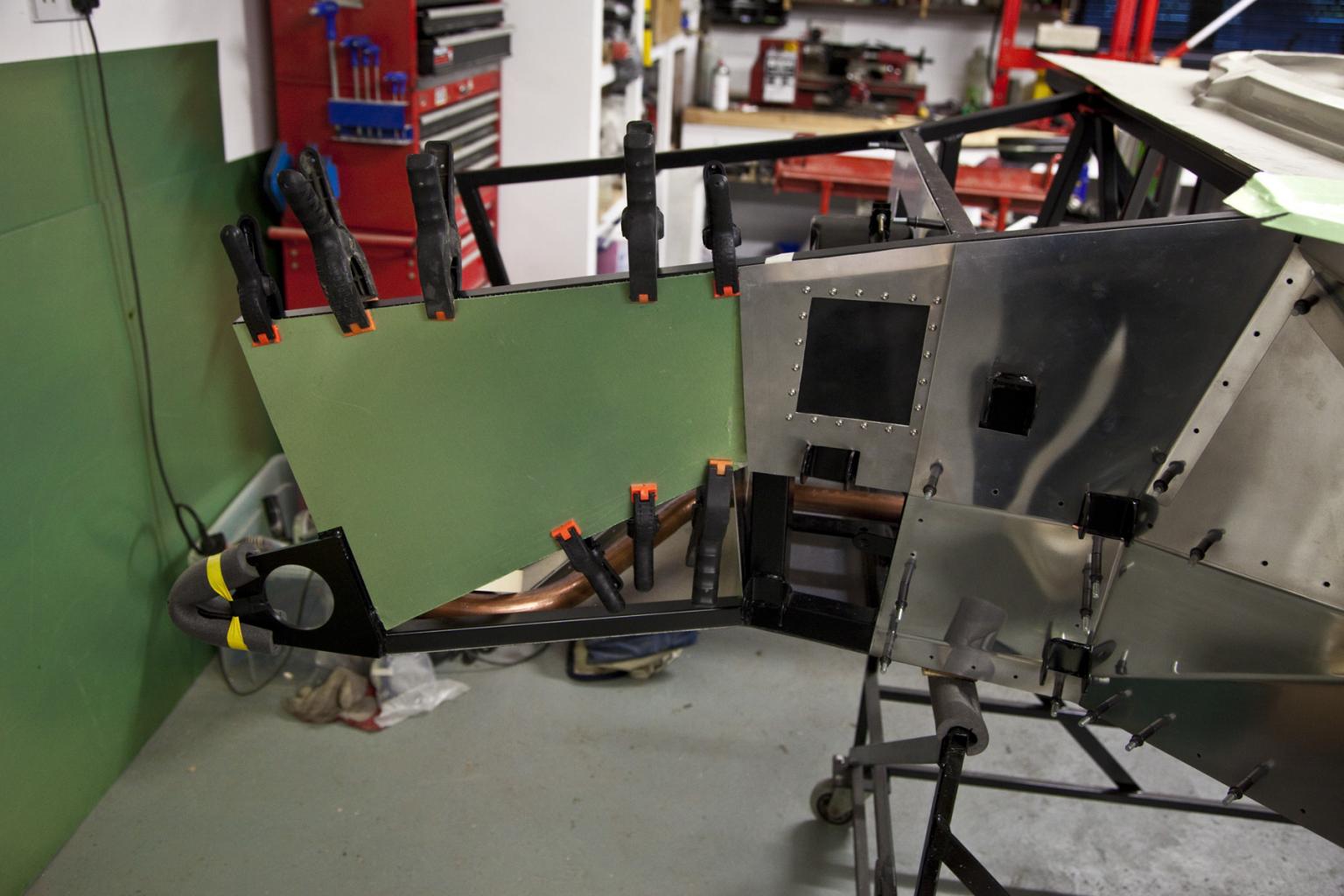

Panels cut and bent ready for the front wheel arch. I've not bought polished aluminium, so they had a bit of a polish before fitting. I know it would have been easier to buy polished aluminium from the start, but at least if I do it myself I can easily produce the same finish if (or more accurately, when) they get scratched during the build.

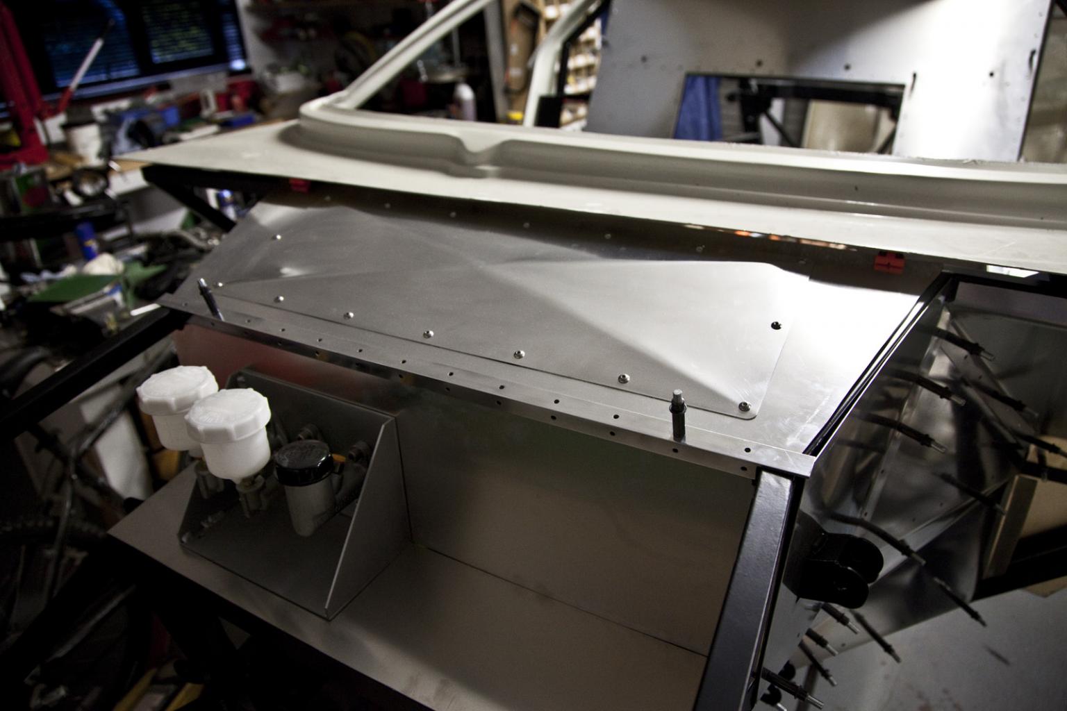

Pedal box has been put together and the front paneling started. I've also started laying out the radiator pipe work.
I've also fitted the bearings in the rear hubs and started prepping the rear clip. The sooner I can get it fitted the better. It will free up a large and much needed area of garage floor:)

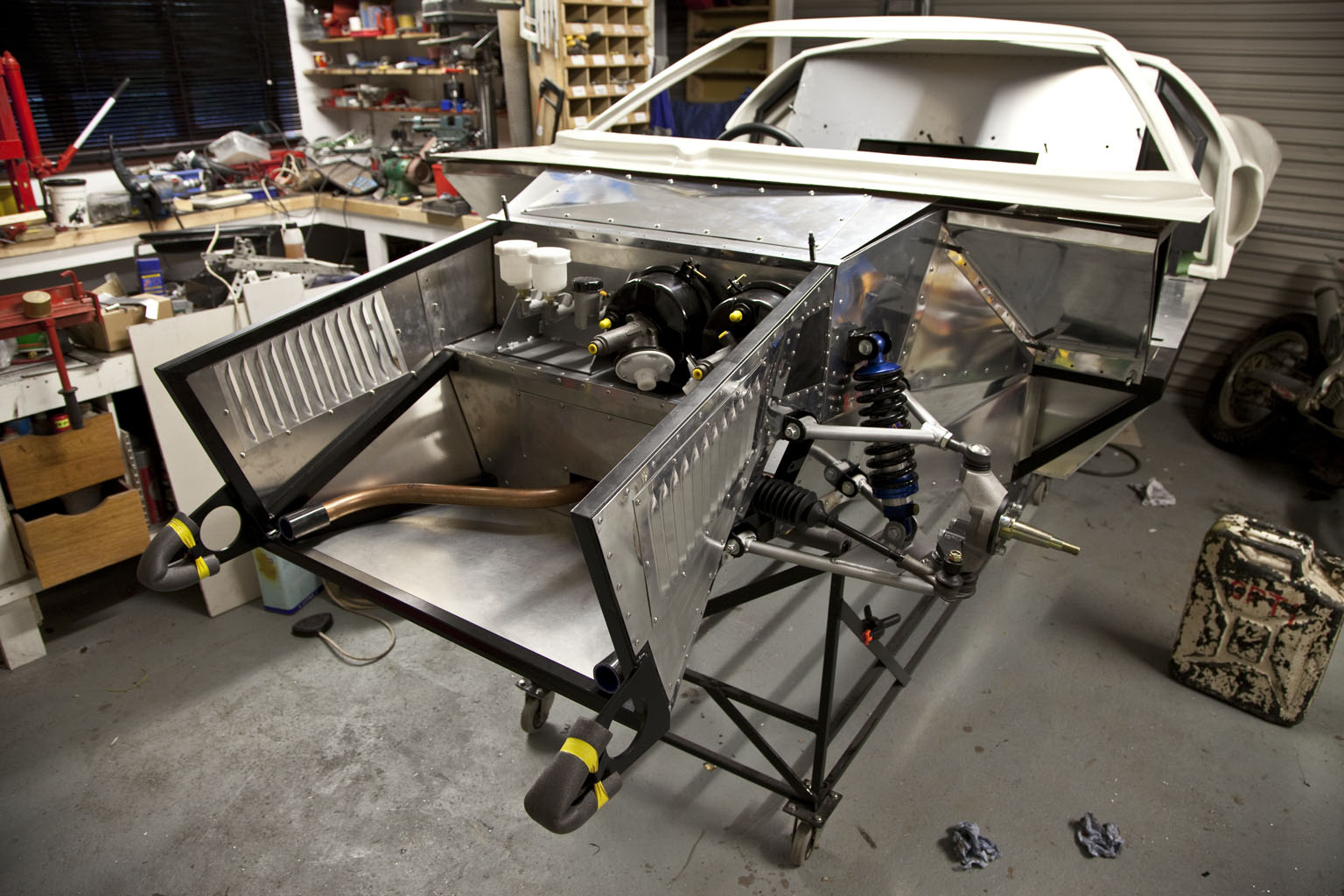

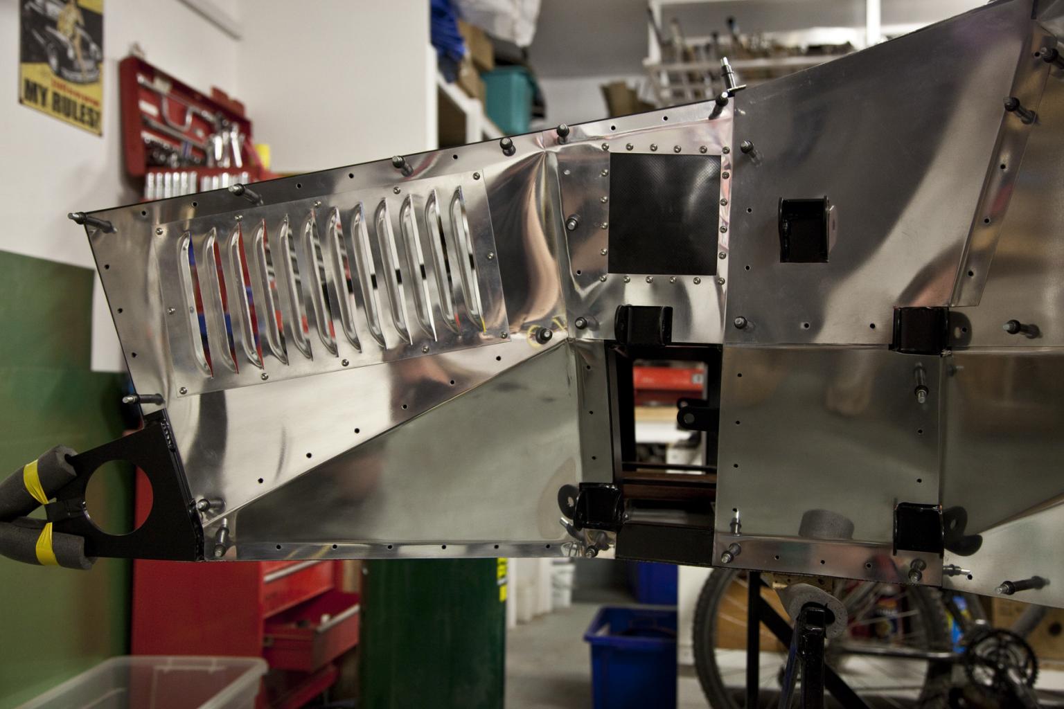

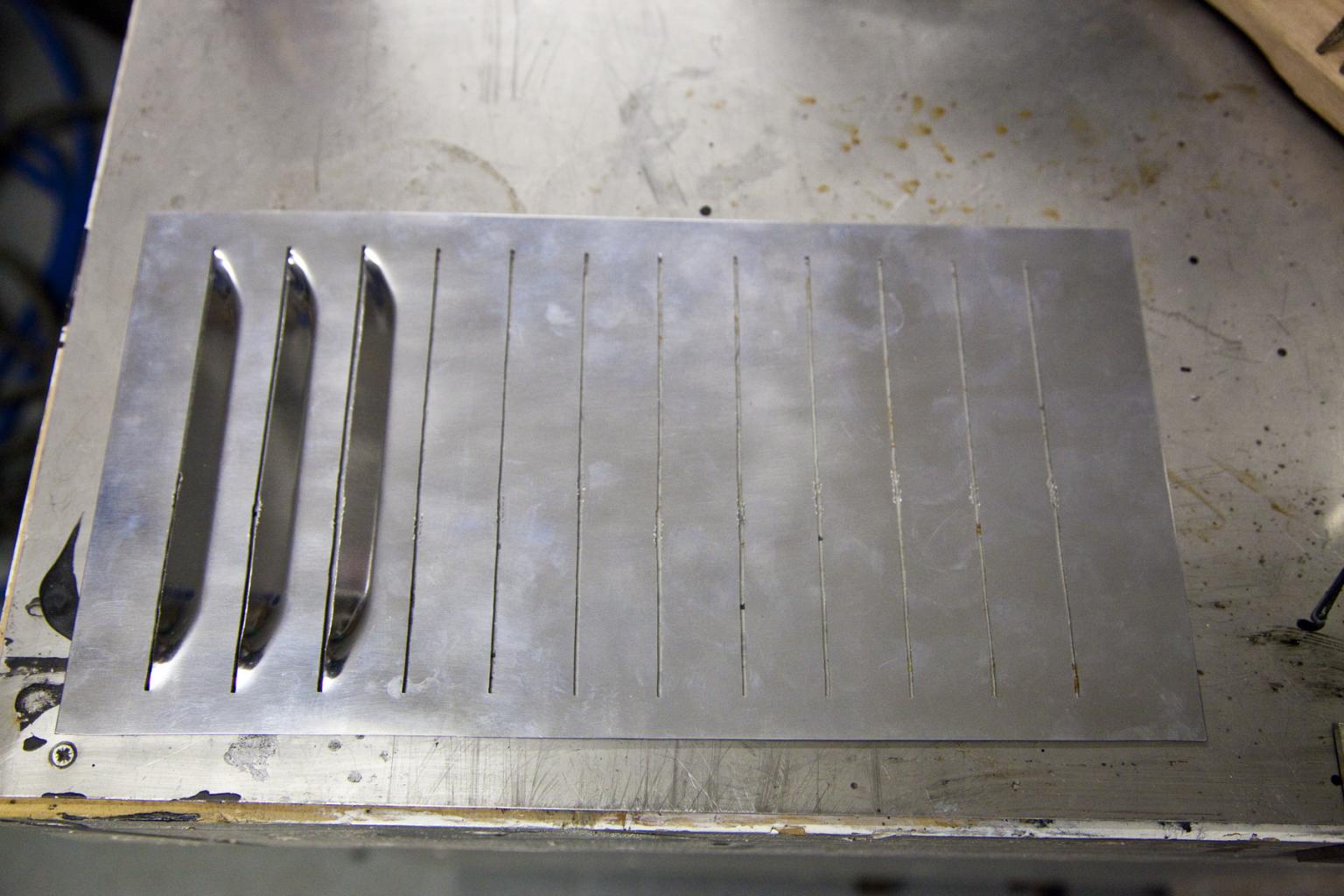

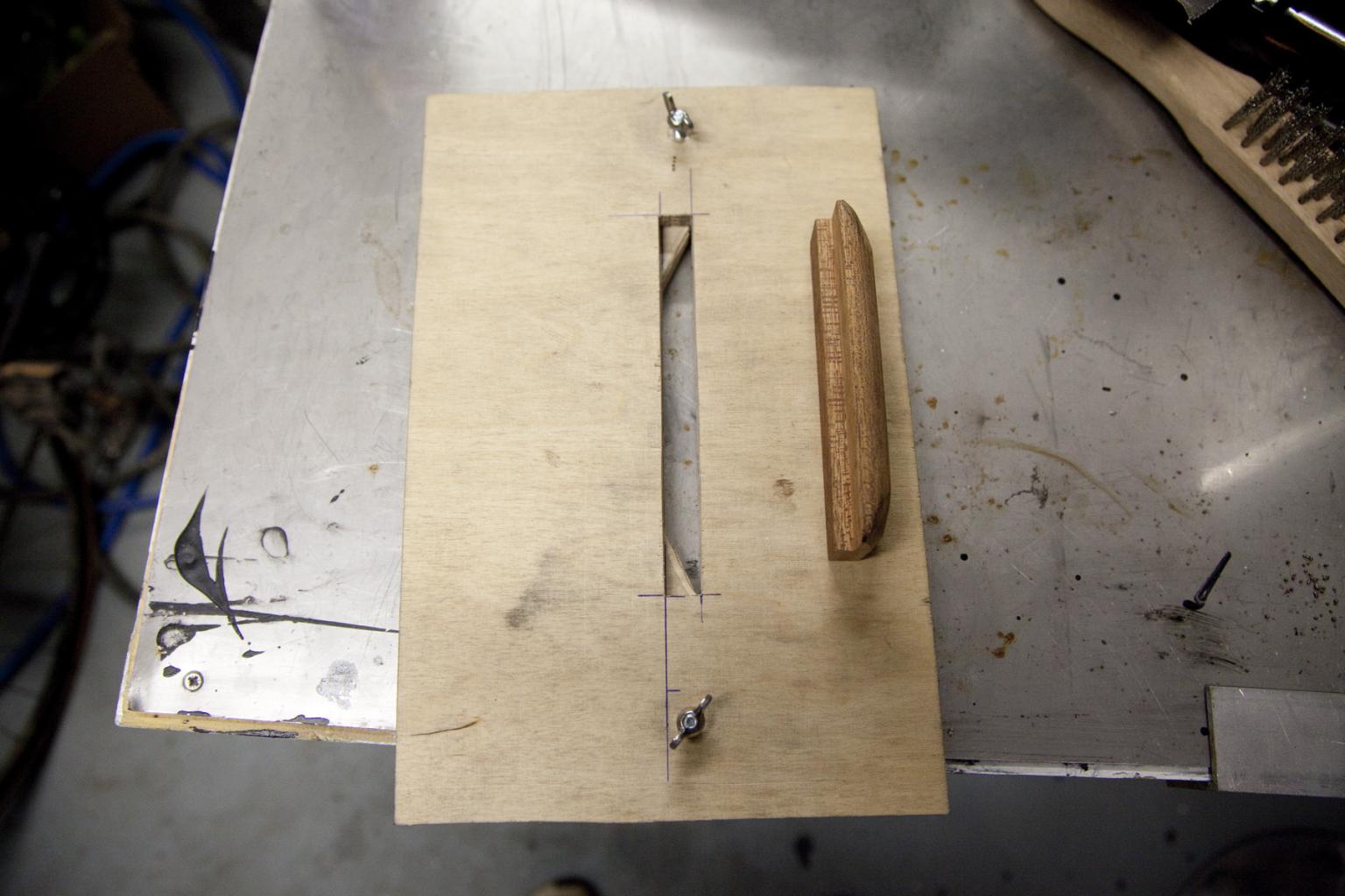

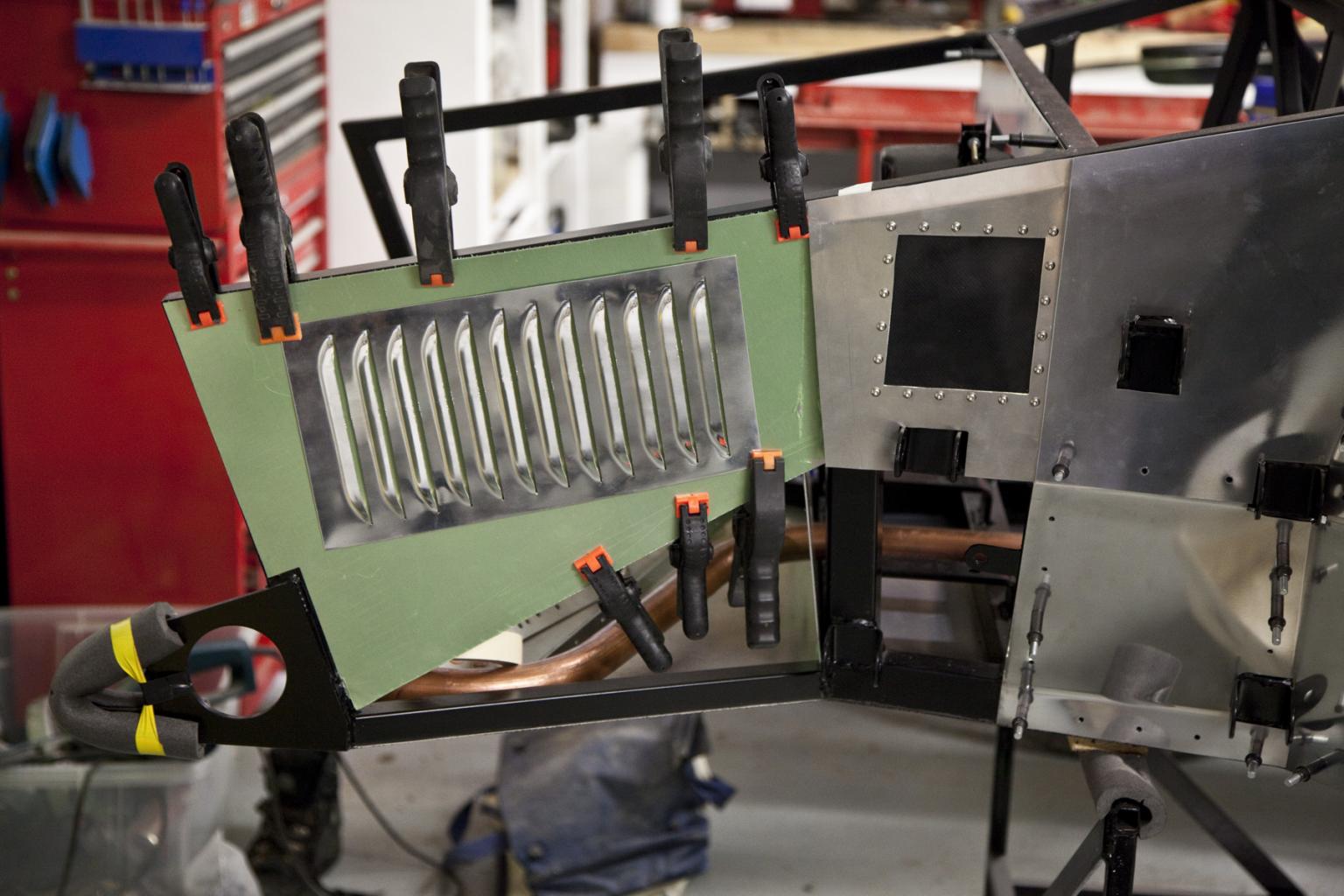

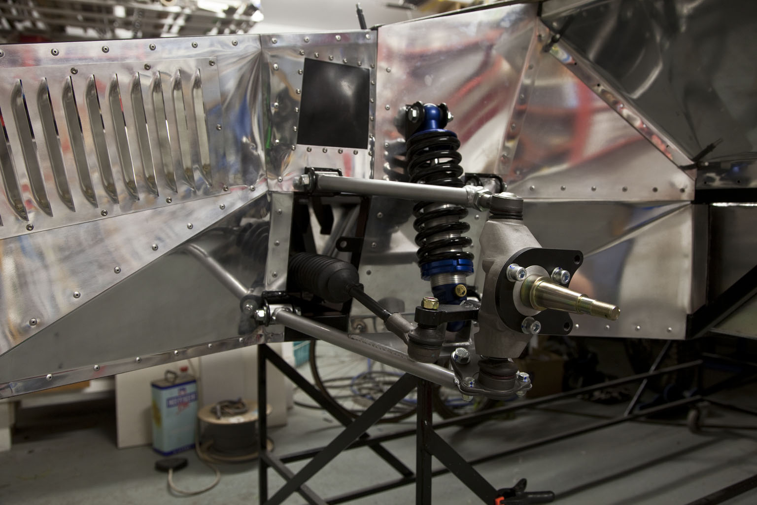

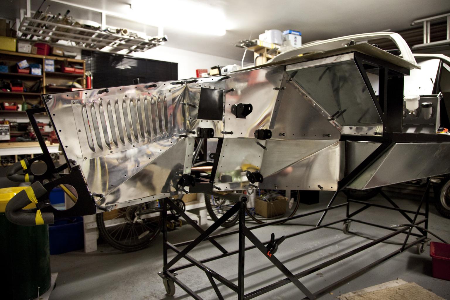

I decided to panel in the forward area of the front wings and wanted to fit a grill. I made a jig out of wood to form it and it works a treat.
Front wing panels finished. Looking a lot like the lunar lander:)
I'll rivet the panels on as soon as the other wing is done. Hopefully it will be a lot easier now I know what I'm doing.
Jason, those louvres, do you think the wheels will throw up water into them ?
If you are trying to keep the temp. down you may find it wont get that hot anyway.
If Tornados rads are like mine which I'm sure they are it will stay cool enough.
Hi Keith
Yes, I did think of the water problem. I'm not too worried as I can wait and see if it becomes an issue. If there are no heating problems I can always rotate the grill to point forward, swop them for mesh or block them up if it comes to it.

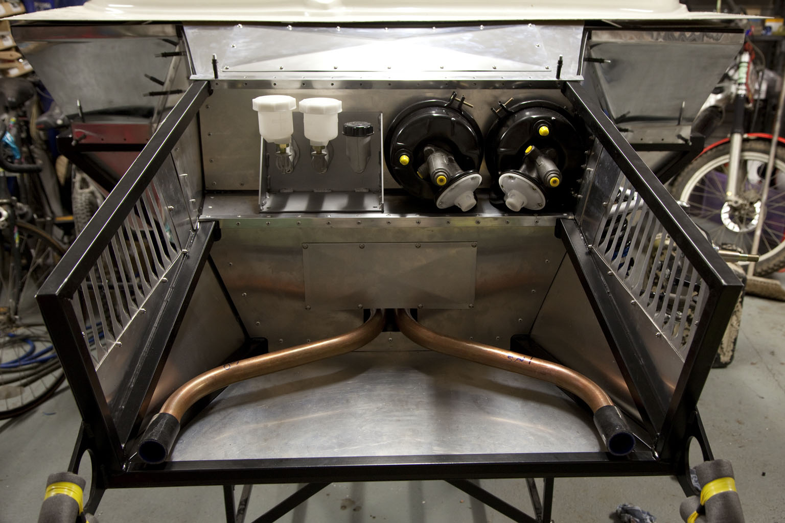

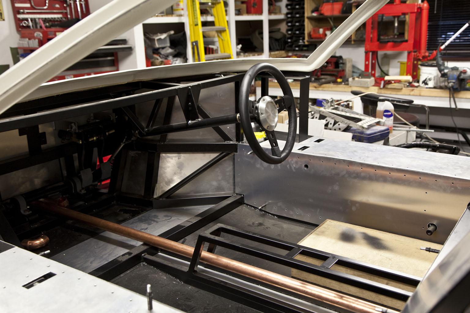

Finally getting somewhere with the build.
The front paneling is almost done now. The brake servos are in, and the pedal box.

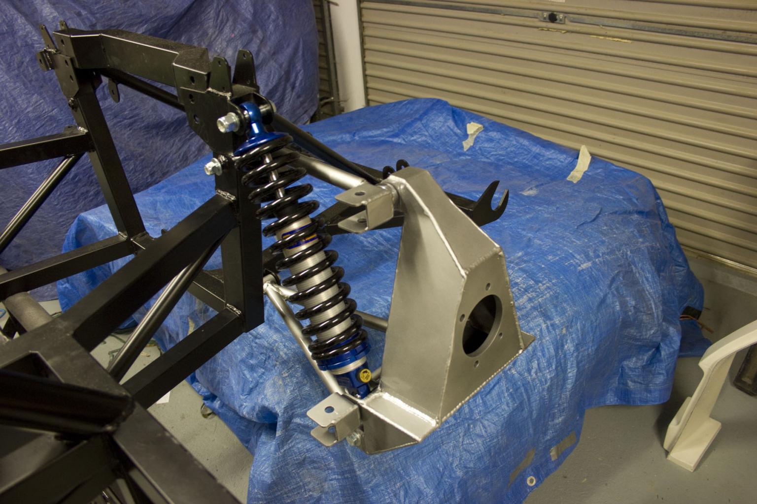

Also put together one of the uprights and fitted the steering rack, column and wheel.
Yes, I did sit in it making engine noises. I was flat out down the mulsanne when my wife caught me:)
