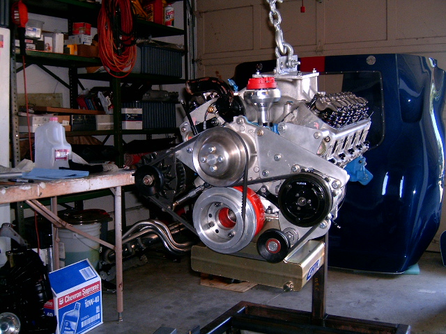

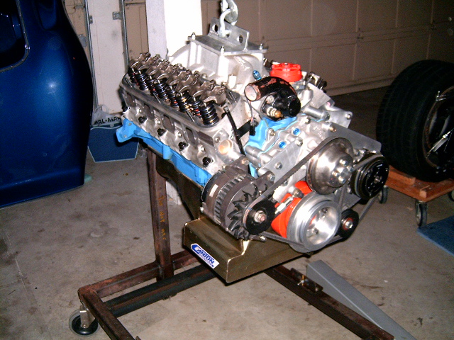

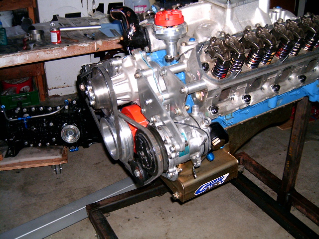

Howard Jones
I made my own.

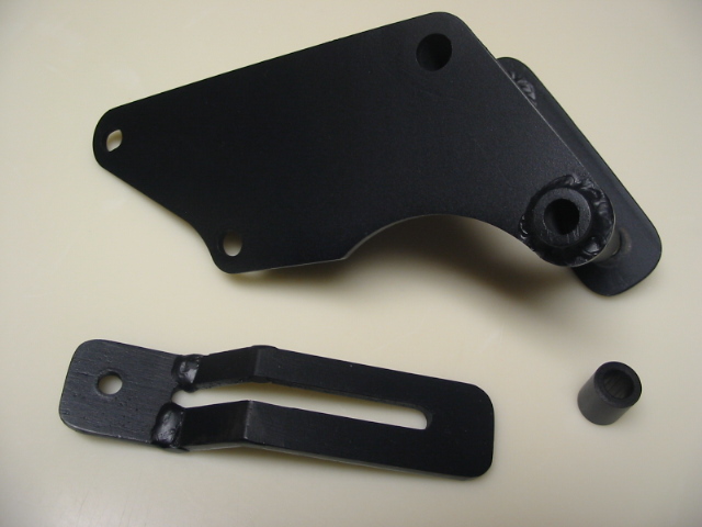

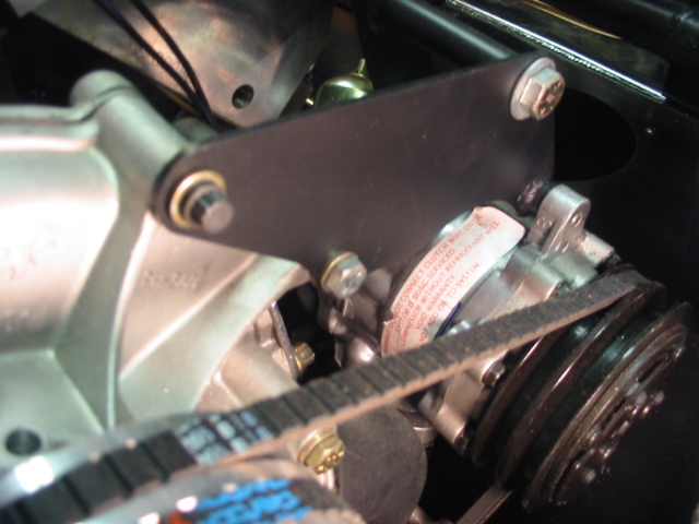

Chuck
The bracket you are seeking sounds like the design used on the RCR cars. Check my build blog for a detailed description (Chuck and Ryan's RCR build). It is a simple design that seems to work very well, fits in a really tight space, and is readily adjustable for different configurations. The pictures may give you some ideas.

Many thanks for the responses - given me some better ideas of what's required. Neat ally installation looks solid - I assume the idler / tensioner is installed when the belt tension cannot be adjusted by moving the a/c pump.
The RCR type bracket presumably doesn't require an additional tensioner as the throw of the unit can be adjusted and then locked in place.
Then of course there's the little matter of rerouting the cooling pipes.
