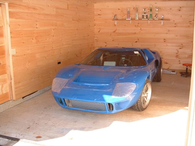

It's only been in the garage seven days and you already have a shelf full of trophies? (I didn't have that much garage bling after my first week)???
Clearly, here's another happy owner of an award-winning RCR creation. :thumbsup:

As for the "bling"/trophies they belong to my last build which is up on a lift in the main garage.

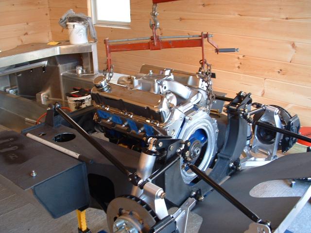

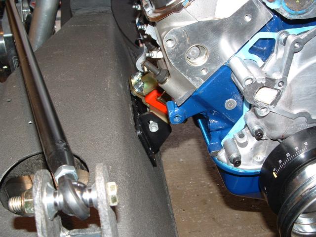

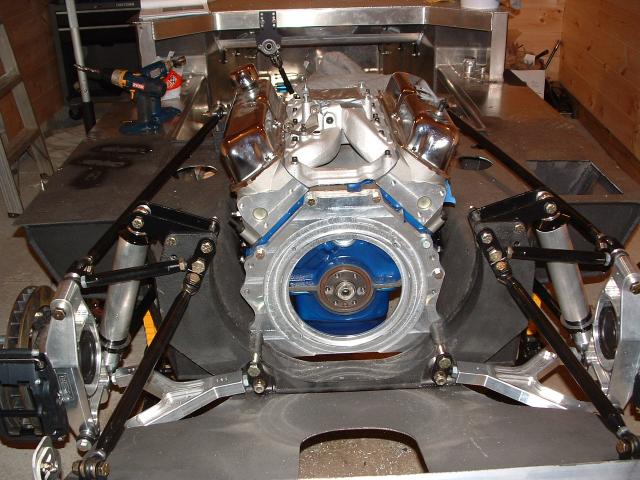

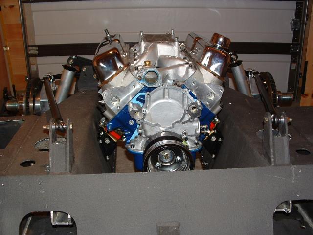

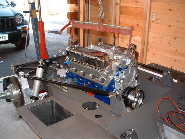

Spent some time and got the engine in and the frame mounts in the right spot. Pretty straight forward going in and now I can see if everything else is going to fit.

I see that you are using a G50 as well (what version? - I am using a shortened G50/03)
Before you drill the holes for the side motor mounts - you may want to check the clearance of the rear of the trans to the body.
I had to move my engine forward a little over 2" to get clearance.
More info is on my website below.
Thanks Randy, I had to shift the engine forward about 2 inches from where it is in the picture so that the back housing of the starter was even with the back of the horseshoe frame.
It's a 1989 five speed G50, the shortest version there is.
BTW, your website is really good and helpful.
Thanks Allan... I appreciate the kudos..
My G50/03 is maybe an inch longer than the G50/50 at this point since I shortened it.
I ended up coming up with an alternative starter mounting scenario for mine as there were really no other alternatives at the time.
