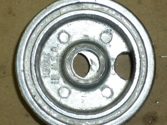

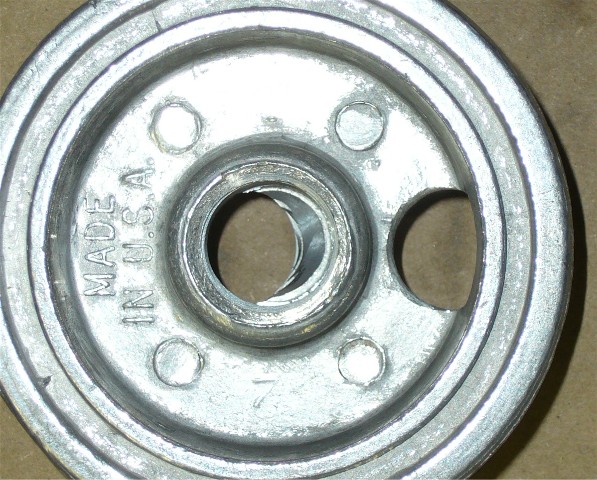

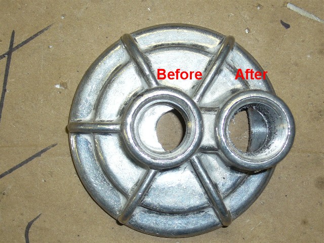

To the point of fitting flow Fran made...wanted to share an item that shouldn't be overlooked..... the oil filter relocator. I pulled my block fitting out of the box today and was terribly disappointed with the condition of the ports. The restrictions were terrible. The piece was a Trans-Dapt brand. Anyway, just wanted to throw it out there....don't forget to look inside these things before mounting. Here are some before and after pics.......
I used a ball nosed carbide porting tool. Just watch the threads when your doing it.....;)
